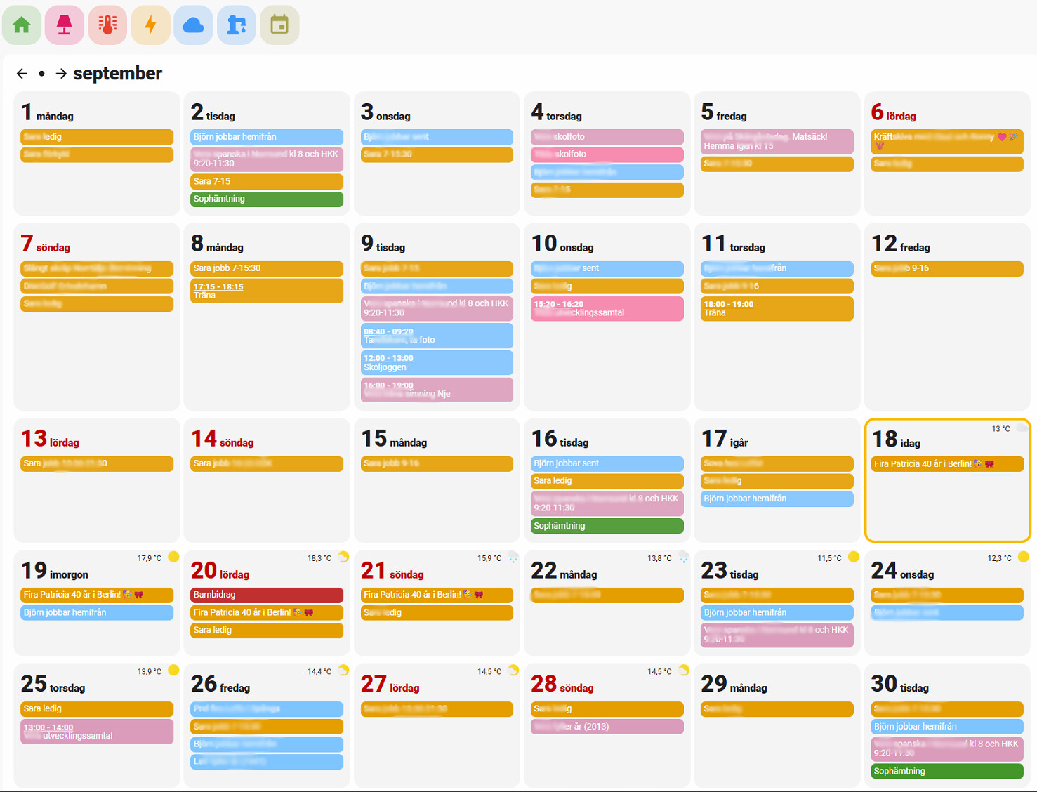

Here’s my take. It’s running on a tablet in the hallway. Family approved. :slight_smile:
thank you for this very nice project!

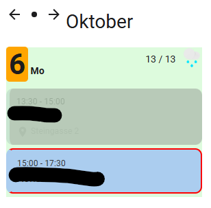

Is there a way to get rid of this glitches on the left side of the events? (EDIT: compact: true did it)
And is there a way to colorize the background of a day according to a event?
(e.g. a different background if it is a holiday day)

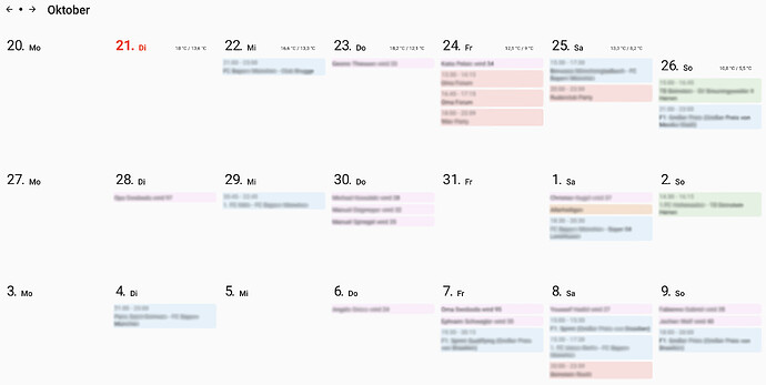

Hello everyone,
First of all, thank you very much for this awesome integration. This is exactly what I’ve been looking for for a long time. I have adapted some things to my needs. However, there are two things I haven’t managed yet, and I’m hoping for your help:
  1. In the first week, Sunday is displayed lower than the other days. How can I move it up to align with the rest of the week?
  2. I need a button on the page that brings me back to my main page. I use Fully Kiosk so the top bar is hidden. However, as soon as I create a button in Panel Mode, I get the message that only one panel view can be used. If I switch to Sidebar Mode, a white area appears on the right, and I haven’t managed to stretch the calendar to the full width.
It seems from this thread that some people have managed to solve this. Unfortunately, I couldn’t make sense of the codes. I hope someone can help me. Thank you.
# Kalender
  - title: Kalender
    path: kalender
    icon: mdi:calendar
    type: panel
    subview: false
    cards:
  # Planner Card
    - type: custom:week-planner-card
      calendars:
        - entity: calendar1
          color: blue
        - entity: calendar2
          color: blue
        - entity: calendar3
          color: orange
        - entity: calendar4
          color: blue
        - entity: calendar5
          color: purple
        - entity: calendar6
          color: red
        - entity: calendar7
          color: green
      days: '21'
      startingDay: monday
      startingDayOffset: 0
      hideWeekend: false
      noCardBackground: true
      eventBackground: var(--ha-card-background)
      compact: false
      weather:
        showCondition: false
        showTemperature: true
        showLowTemperature: true
        useTwiceDaily: false
        entity: weather.forecast_street
      locale: de
      showLocation: false
      hidePastEvents: false
      hideDaysWithoutEvents: false
      hideTodayWithoutEvents: false
      combineSimilarEvents: false
      showLegend: false
      texts:
        fullDay: ""
        today: ""
        tomorrow: ""
        noEvents: ""
        yesterday: ""
        sunday: So
        monday: Mo
        tuesday: Di
        wednesday: Mi
        thursday: Do
        friday: Fr
        saturday: Sa
      showNavigation: true
      card_mod:
        style:
            /* Karte auf volle Breite */
            ha-card {
            margin-top: 1px;
            font-size: 15px !important;
            overflow: hidden; --days-spacing: 10px;
            --event-padding: 2px !important;
            --events-margin-top: 1px;
            --event-border-width: 2px;
            /* Event-Hintergrundfarben */
            .event[data-entity="calendar1"] {
              background-color: rgba(135,206,250,0.2) !important;
            .event[data-entity="calendar2"] {
            .event[data-entity="calendar3"] {
              background-color: rgba(238,118,0,0.2) !important;
            .event[data-entity="calendar4"] {
            .event[data-entity="calendar5"] {
              background-color: rgba(255,187,255,0.2) !important;
            .event[data-entity="calendar6"] {
              background-color: rgba(255,106,106,0.2) !important;
            .event[data-entity="calendar7"] {
              background-color: rgba(124,205,124,0.2) !important;
            .event.past {
              opacity: 0.3;
            .none {
              background-color: transparent !important;
            /* Linke Linie der Events ausblenden */
            .container .day .event {
              border-left: none !important;
            /* Container volle Breite + gleichmäßiger Abstand */
            .container {
              display: flex !important;
              flex-wrap: wrap !important;
              justify-content: flex-start !important;
              width: 100% !important;
              align-content: flex-start;
              align-items: flex-start;
              gap: var(--days-spacing) !important; /* Abstand zwischen den Tagen */
            /* Jeder Tag gleich breit */
            .container .day {
              width: calc((100% - 6 * var(--days-spacing)) / 7) !important;
              max-width: calc((100% - 6 * var(--days-spacing)) / 7) !important;
            /* Erste Woche: alle Tage oben ausrichten und minimal verschieben */
            .container .day:nth-child(-n+7) {
              align-self: flex-start;
              transform: translateY(20px);
            /* Abstand zwischen den Wochen (ab 2. Woche) */
            .container .day:nth-child(n+8) {
              margin-top: 70px;
            /* Datum + Wochentag nebeneinander */
            .container .day .date {
              display: flex;
              flex-direction: row !important;
              align-items: center !important;
              padding-left: 6px;
              gap: 10px;
            /* Tageszahl */
            .container .day .date .number {
              order: 1;
              margin-top: 0px;
              text-align: left;
              font-weight: 400;
              font-size: 35px !important;
              font-family: "Roboto", sans-serif;
              color: var(--primary-text-color);
            /* Punkt hinter Datum */
            .container .day .date .number::after {
              content: ".";
              margin-left: -3px;
            /* Wochentag */
            .container .day .date .text {
              order: 2;
              font-weight: 500;
              font-size: 20px !important;
              margin-top: 10px;
            /* Heute – Zahl und Wochentag rot */
            .container .day.today .date .number,
            .container .day.today .date .text {
              color: #ff0000 !important;
              font-weight: 600 !important;
            /* Monatsanzeige verschieben */
            .month {
              position: relative;
              top: -9px;
              left: 20px;
              font-size: 30px !important;
              font-weight: 500;
            /* Temperatur auf Wochentag-Höhe verschieben */
            .container .day .weather .temperature {
              position: relative;
              top: 15px;
              left: -20px;
              font-size: 12px !important;

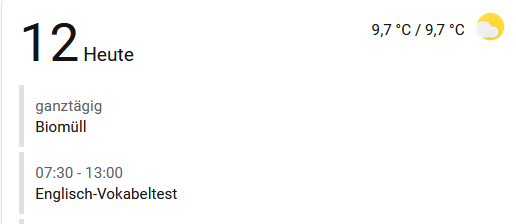

Could you share the yaml code you used? I cannot seem to figure out how to get the entire month to show, even the days that have passed. Thank you
I have several Google calendar combined.
Is it possible to show the calendar entity (in best case “friendly name”) of the entry in the daily overview?
In best case 07:30 - 13:00 "calendar entity / “frindly name”
Englisch-Vokabeltest
should be something like:
card_mod:
  style: |
    .day
      font-size: 16px;
    .event .entity   or .event.data-entity
      font-size: 9px;
however I see changing the font size of the day, but I don´t see the calendar entity.

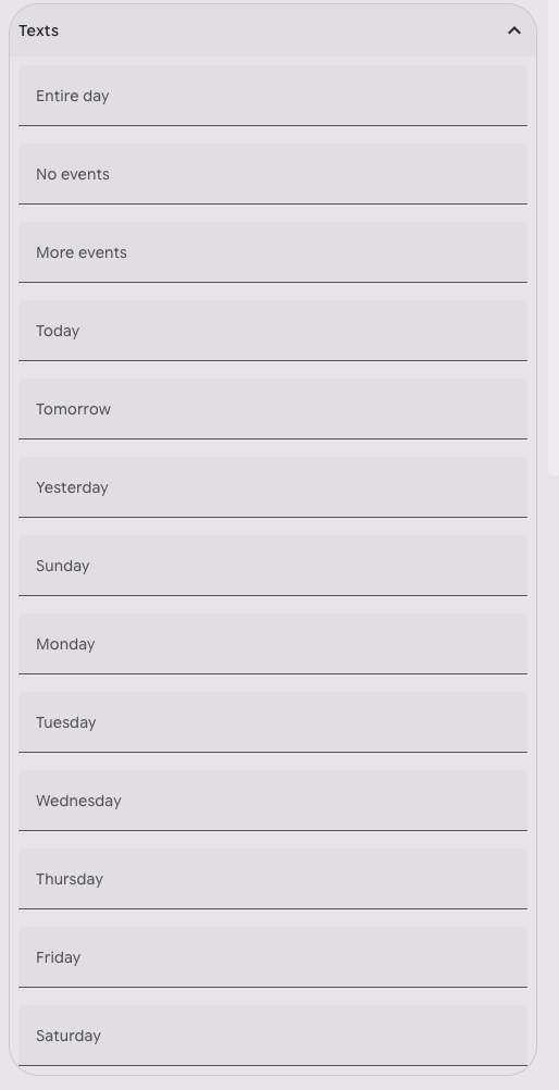

Is it possible to make it so it says the actual day of the week instead of “Yesterday” & “Tomorrow”? I don’t mind it saying “Today”, but I would like the actual day of the week to be there instead of the “Yesterday” & “Tomorrow” text.
I think you can do that under date/time formats.
How? There is nothing about that in there.
the field override day number and add a luxon compatible “code”
I have for example:
'<span class="number">'d'</span> <span class="text">'cccc'</span> <span class="wk">'n'</span>'
Because i wanted to show also the week number.
But I am not trying to override the Day Number. I still want the number of the day to be there. I think some kind of coding would need to be placed where you can change the names of the day. Something that would force the actual day name would get placed where the “Yesterday” “Today” and “Tomorrow” are, using a card mod in the code editor… because they already have it so you can change those display texts.
You still have if you use the correct Luxon format.
Mine looks like this:
afbeelding
It’s Date, Name, Weeknumber.
I got it figured out. It’s not actually how you suggested. Regardless, I appreciate your help because, in trying what you were saying, I was able to figure out how it needs to be coded. For anyone searching for how to do this, it does not involve using the Luxon format. All you need to do is place the YAML code for the text edits of changing the day names and leave the “yesterday” & “tomorrow” blank. So it should look like the code below:
texts:
  tomorrow:
  yesterday:
Again really appreciate your suggestions because I was trying to place Luxon formats in those days and when I removed the Luxon code, I could see in the preview that the actual days showed up.

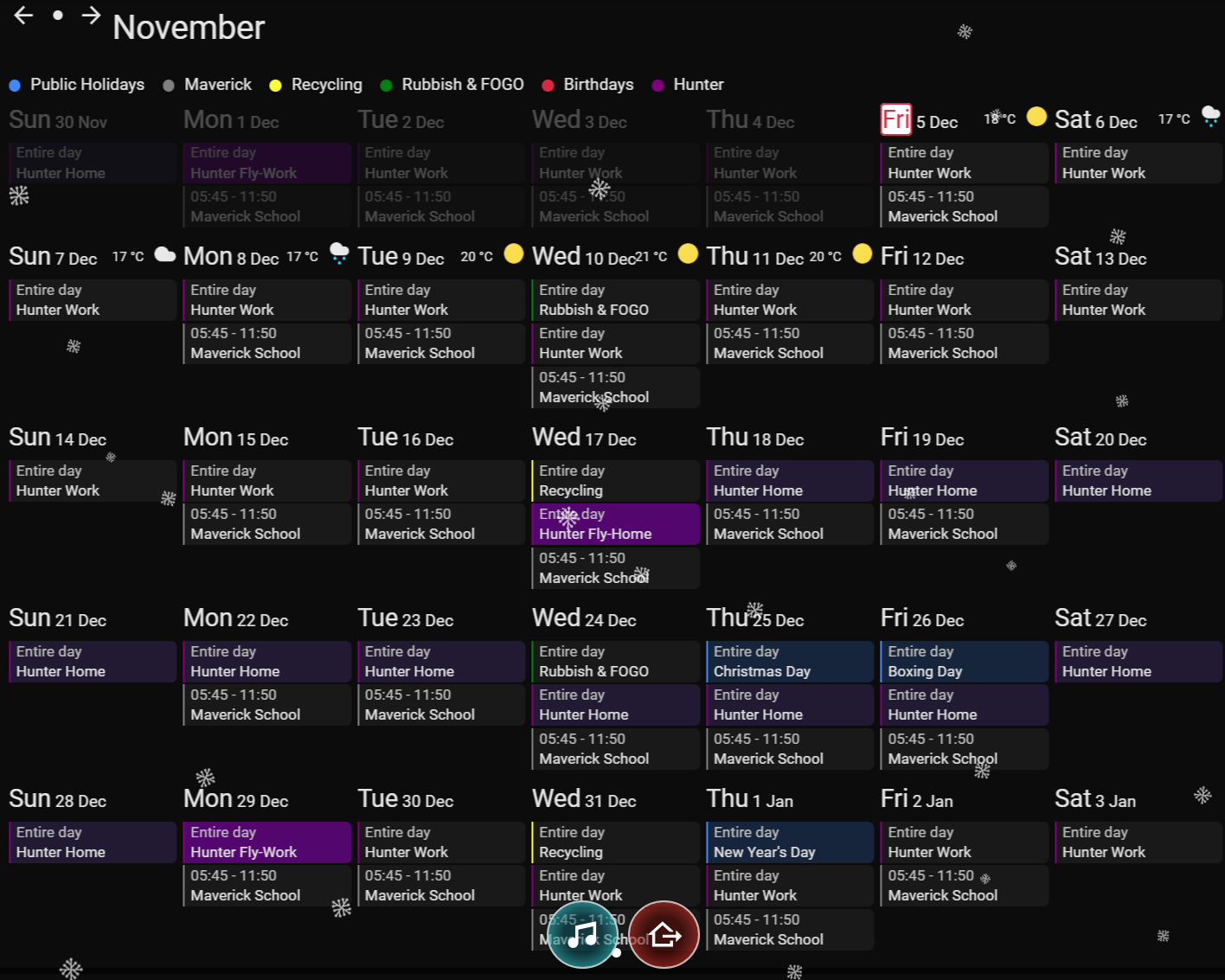

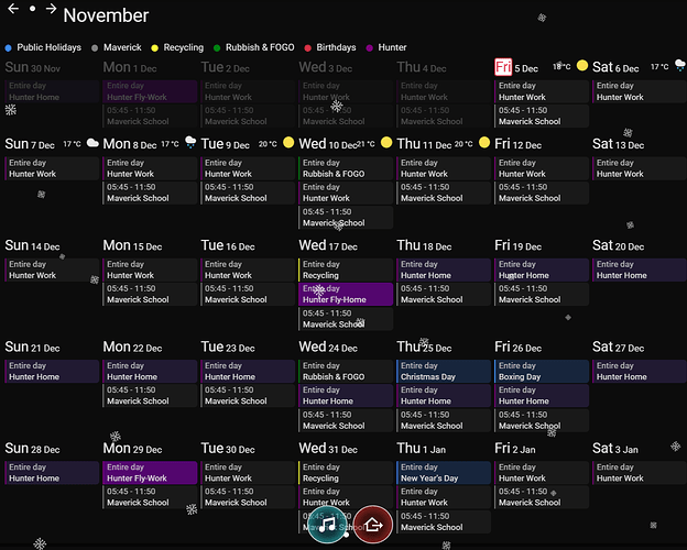

@lanceblaise yes your solution works but the below code which is in Luxon format as the docs say
                    dayFormat: >-
                      '<span class="number">'EEE'</span> <span class="month">'d
                      MMM'</span>'
Gives me this calendar
My full card code below
                    calendars:
                      - entity: calendar.australia_tas
                        color: dodgerblue
                      - entity: calendar.calendar
                        color: grey
                      - entity: calendar.recycle_pickup
                        color: yellow
                      - entity: calendar.rubbish_pickup
                        color: green
                        name: Rubbish & FOGO
                      - entity: calendar.birthdays
                        color: crimson
                      - entity: calendar.hunter
                        color: purple
                    weather:
                      entity: weather.devonport
                      showCondition: true
                    showLegend: true
                    days: 35
                    startingDay: sunday
                    columns:
                      extraLarge: 7
                      large: 7
                      medium: 7
                      small: 7
                      extraSmall: 7
                    dayFormat: >-
                      MMM'</span>'
                    compact: true
                    card_mod:
                      style: |
                        .day.past {
                          opacity: .3;
                        .today .number {
                          color: crimson;
                          border: solid 2px crimson;
                          border-radius: 4px;
                          background-color: white !important;
                        .event[data-entity="calendar.recycle_pickup_3"] {
                          background-color: rgba(255,215,0,0.2) !important;
                        .event[data-entity="calendar.rubbish_pickup_3"] {
                          background-color: rgba(34,139,34,0.2) !important;
                        .event[data-entity="calendar.australia_tas"] {
                          background-color: rgba(30,144,255,0.2) !important;
                        .event[data-entity="calendar.birthdays"] {
                          background-color: rgba(220,20,60,0.2) !important;
                        .event[data-summary="Hunter Home"] {
                          background-color: rgba(106,90,205,0.2) !important;
                        .event[data-summary="Hunter Fly-Home"] {
                          background-color: rgba(148,0,211,0.5) !important;
                        .event[data-summary="Hunter Fly-Work"] {
Hello everyone - this thread has been so helpful in building out my family calendar. I’ve searched the thread and can’t find the answer to two issues I’m facing (ChatGPT is no help either):
  1. Does anyone have an alternative to the default week planner navigation buttons? Ideally, I’d love a way to move the buttons to the top center of a section.
  2. Is there any way to “hide” the “No events” text? I’m find w/ just formatting it to match the background color but I can’t for the life of me find a working solution either way.
Thanks so much in advance for any help!

You can change this in the gui under Miscellaneous
Default is set to 60 seconds.
