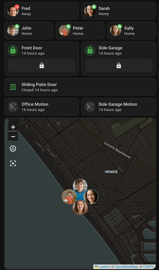

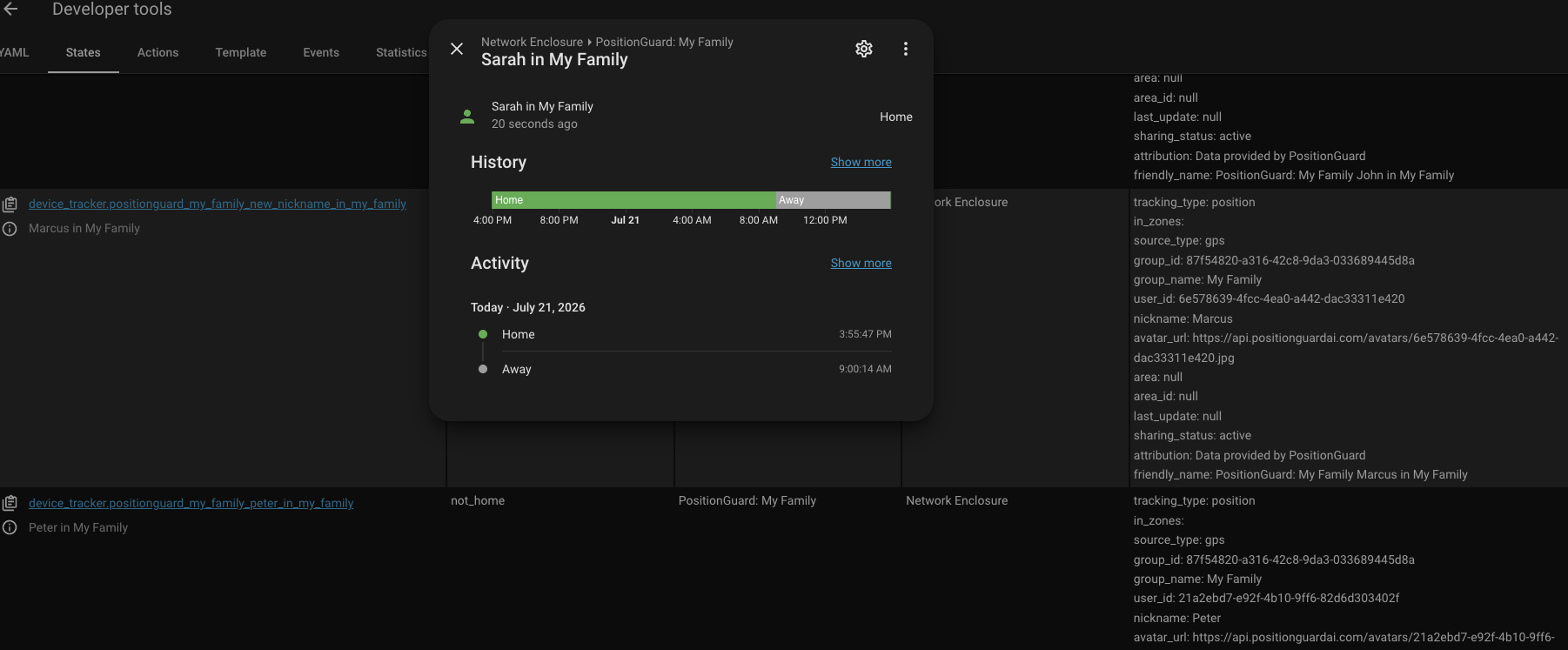

How it works
Family members install the PositionGuard app and join your group. That’s it. The integration creates clean native device_tracker + binary_sensor entities. Standard Home / Away + named areas. Works across multiple HA instances too — each instance runs independently, same or separate API keys. Architecture’s proven on multi-hub Hubitat setups; haven’t personally verified it across multiple HA instances yet, so treat that as confident-but-unconfirmed for now.
In action
Example Lovelace dashboard (using Mushroom cards — see README for full templates and variations):
