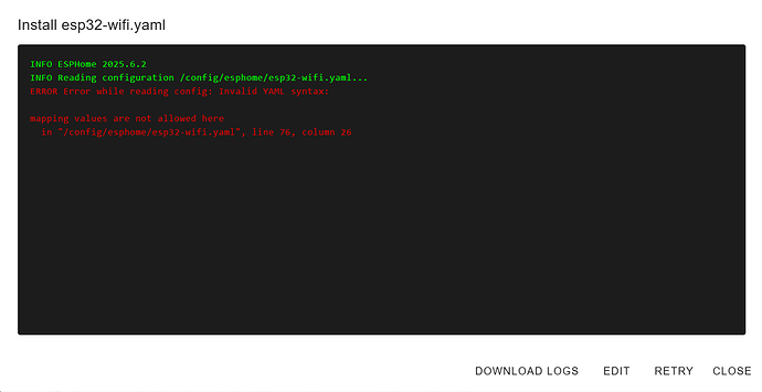

hello
im trying to used this code to control the humidity in the bath but i got this error
any help please ?
Thanks

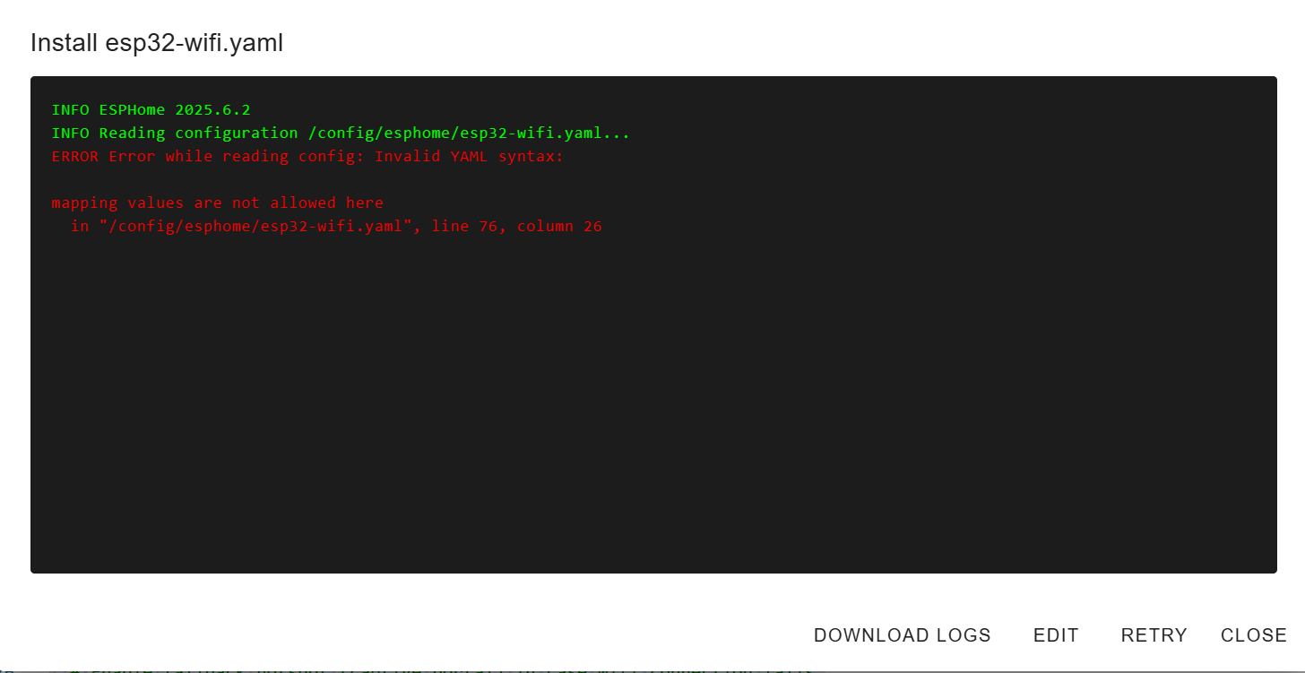

In YAML indentation is everything. Your indentation (assuming you just copy/pasted) will not work.
As an example:
light:
  - platform: binary
    output: on_off
    restore_mode: ALWAYS_OFF
output:
  - platform: gpio
    pin: 33
And so forth.
try again fixing the rest of the code - the indentation you see in the documentation is not just to make it pretty - it is part of the syntax.

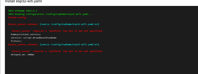

thanks alot i fixed the code and i got now this one any idea ?

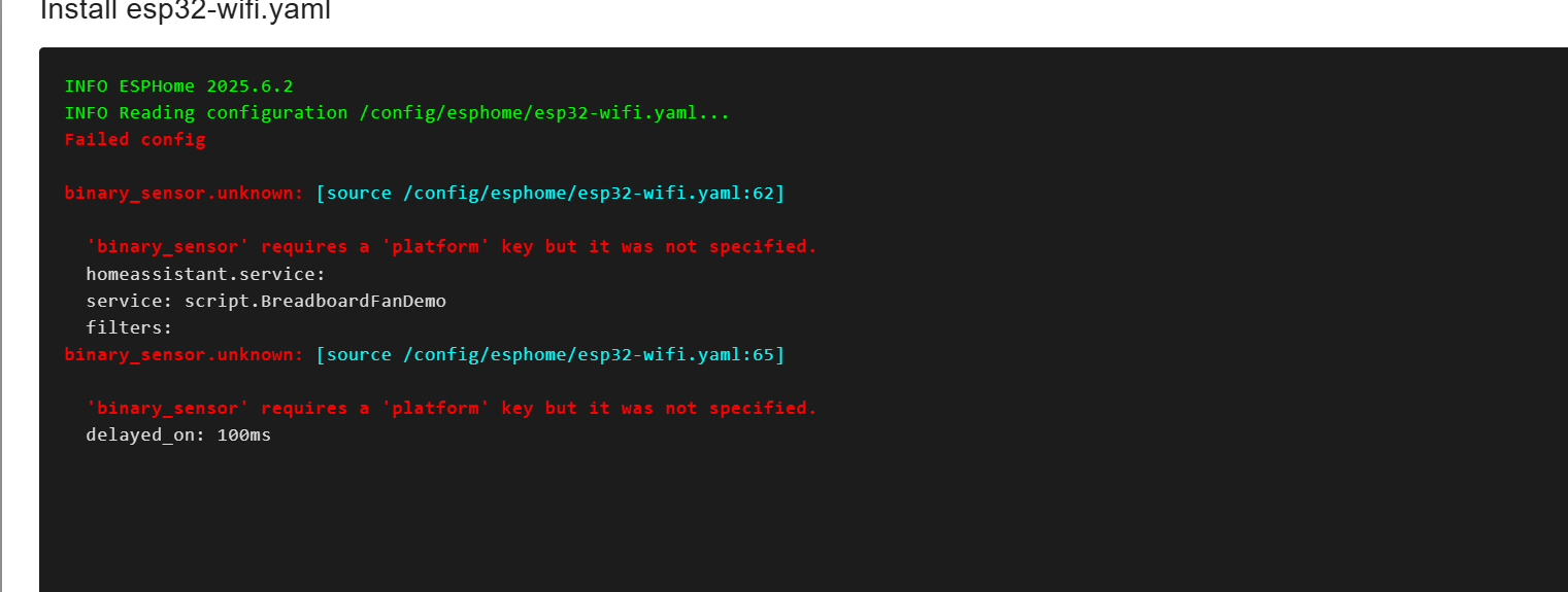

Again - indentation…
binary_sensor:
  - platform: gpio
    pin:
      number: 32
      mode:
        input: true
        pullup: true
    device_class: power
    filters:
      - delayed_on: 100ms
    on_press:
      then:
        - homeassistant.service:
            service: script.BreadboardFanDemo
Look at the the docs. The first example on this page shows you the correct indentations.
Also - home assistant.service: is depreciated - use home assistant.action: instead.

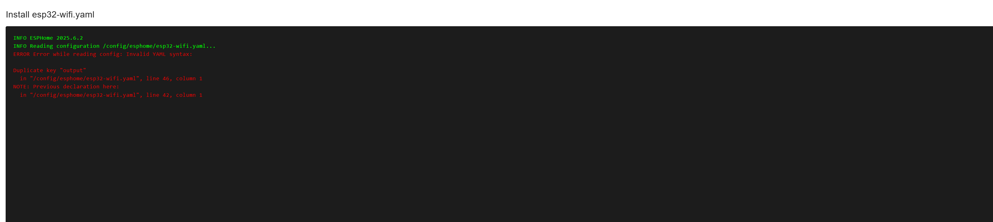

hi
im sorry to bother you again i got stuck here whenever i change the code im getting different error i dont know how to fixed this i went through the doc and i didnt get it ??

Something like this. Indentations are PITA, but documentation gives examples…
sensor:
  - platform: bme280_i2c
    temperature:
      name: "WorkBench Temperature"
      oversampling: 16x
      filters:
        - lambda: return x * (9.0/5.0) + 29.0;
      unit_of_measurement: "°F"
    humidity:
      name: "WorkBench Humidity"
      filters:
        - lambda: return x + 6;
    address: 0x76
    update_interval: 5s
