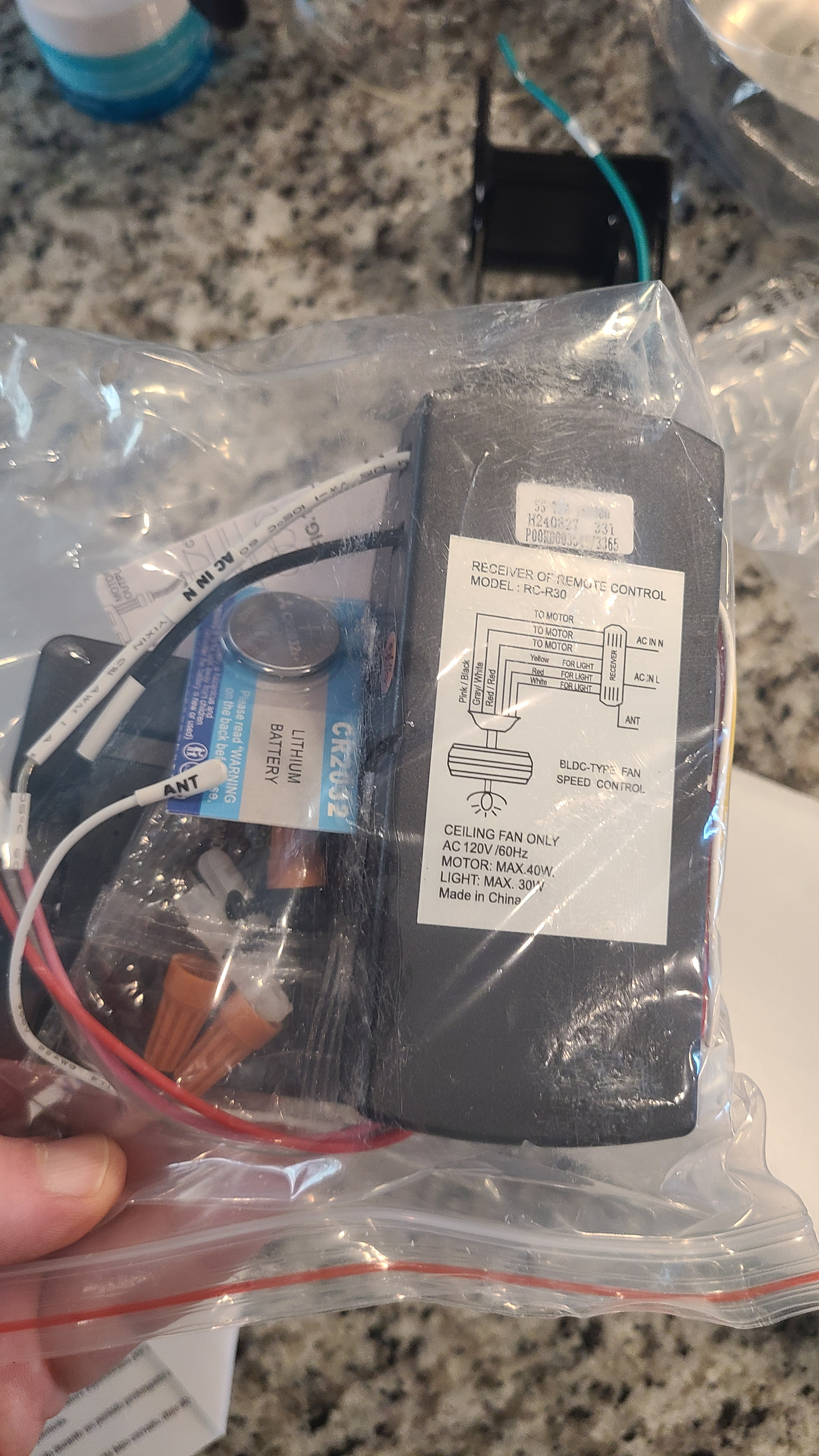

We have a ceiling fan/light that I'm having trouble integrating to our HA system. All our other fan/lights use regular AC into the fan and light, so I've been able to use Z-Wave switches at the wall for both local and remote control. However, this unit uses some kind of RF-based controller I can't identify. Pictures below.
I tried to integrate it using a Bond, which only works intermittently and still doesn't provide feedback on actual state.
Is anybody aware of what this controller is and what a good replacement to get it directly on the Z-Wave mesh might be?

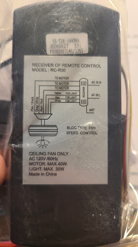

Looking at the product website, it looks like this uses a DC (Brushless DC - BLDC) Motor. You can’t just use any old AC controller. This is a very proprietary setup. Your best bet might be to program a ZWave dev board to activate the buttons on the included remote.
RC-R30 is 433MHz receiver (according to schematic I found online) so shouldn't be difficult to capture the signals and control the fan.
