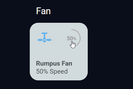

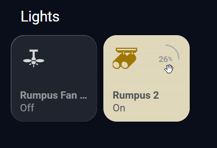

I have a heavily customized button-card template with a circular slider, exactly the one tamper evident on youtube created for his dashboard.
For lights, drag-to-change brightness works perfectly.
For fans (Tuya integration), I can see percentage and change speed from the HA more-info popup,
but the same circular slider does not allow dragging to change fan speed.
Facts:
  • Fan entity has attributes:
    percentage, percentage_step
  • fan.set_percentage works from popup
  • circle SVG renders and % text updates
  • cursor never changes to grab
  • dragging does nothing
Question:
What is the correct way to enable drag interaction for fan entities in button-card?
Is there a frontend restriction for fan sliders compared to light brightness sliders?
Any insight into how the HA frontend handles fan sliders internally would help.
Since, I really don’t know where the error is coming from, i have added the code where i think issue can be.

    custom_fields:
      circle: |
          if (entity) {
              let r = 22.1,
                  c = r * 2 * Math.PI,
                  tspan = '<tspan dx=".2" dy="-.4">',
                  domain = entity.entity_id.split('.')[0],
                  state = variables.state_on,
                  input =
                  domain === 'fan'
                      ? entity.attributes.percentage ?? 0
                      : variables.circle_input || ' ',
                  unit =
                  domain === 'fan'
                      : variables.circle_input_unit || ' ';
              *             CIRCLE              *
              let circle = (state, input, unit) => {
                  return `
                    <svg viewBox="0 0 50 50">
                      <style>
                        circle {
                          transform: rotate(-90deg);
                          transform-origin: 50% 50%;
                          stroke-dasharray: ${c};
                          stroke-dashoffset: ${typeof input === 'number' && c - input / 100 * c};
                          stroke-width: var(--c-stroke-width);
                          stroke: ${state ? 'var(--c-stroke-color-on)' : 'var(--c-stroke-color-off)'};
                          fill: ${state ? 'var(--c-fill-color-on)' : 'var(--c-fill-color-off)'};
                        text {
                          font-size: var(--c-font-size);
                          font-weight: var(--c-font-weight);
                          letter-spacing: var(--c-letter-spacing);
                          fill: var(--c-font-color);
                        tspan {
                          font-size: var(--c-unit-font-size);
                        #circle_value, tspan {
                          text-anchor: middle;
                          dominant-baseline: central;
                      </style>
                      <circle id="circle_stroke" cx="25" cy="25" r="${r}"/>
                      <text id="circle_value" x="50%" y="52%">${input}${tspan}${unit}</tspan></text>
                    </svg>
                    ${(domain === 'light' || domain === 'fan') && `
                        <input id="circle_slider"
                          type="range"
                          min="0"
                          max="100"
                          step="${domain === 'fan'
                            ? (entity.attributes.percentage_step || 1)
                            : 1}"
                          value="${input}">
              *              LIGHT              *
              if (domain === 'light' && state) {
                  // wait 0ms for shadow dom
                  setTimeout(() => {
                      // then get elements
                      let elt = this.shadowRoot,
                          circle_slider = elt.getElementById('circle_slider'),
                          circle_value = elt.getElementById('circle_value'),
                          circle_stroke = elt.getElementById('circle_stroke');
                      // approximate position of thumb relative to circle
                      circle_slider.style.top = `${(circle_slider.value - 50) / 1.66 - 1}%`;
                      // debug position
                      let debug = false;
                      if (debug) circle_slider.style.opacity = 0.3;
                      // pass each event to handler
                      ['click', 'input', 'mousedown', 'mouseup', 'touchstart', 'touchend'].forEach((event) => {
                          circle_slider.addEventListener(event, handler, { passive: true })
                      function handler(event) {
                          // "this" refers to slider
                          if (event.target === this) {
                              // bypass button-card tap_action
                              event.stopPropagation();
                              // update circle_value
                              circle_value.innerHTML = `${this.value}${tspan}${unit}</tspan>`;
                              // update stroke
                              circle_stroke.style.strokeDashoffset = c - this.value / 100 * c;
                              circle_stroke.style.strokeWidth = 'var(--c-stroke-width-dragging)';
                              // set cursor while dragging
                              if (event.type === 'mousedown' || event.type === 'input') {
                                  this.style.cursor = 'grabbing';
                              } else {
                                  this.style.cursor = 'grab';
                              // reset stroke width if value doesn't change
                              if (input == this.value && (event.type === 'click' || event.type === 'touchend'))
                                  circle_stroke.style.strokeWidth = 'var(--c-stroke-width)';
                              // on release
                              if (event.type === 'mouseup' || event.type === 'touchend') {
                                  // display loader if brightness is 0
                                  if (circle_slider.value == 0 && elt.getElementById('loader')) {
                                      elt.getElementById('loader').style.display = 'initial';
                                      elt.getElementById('circle').style.display = 'none';
                                  // set brightness
                                  hass.callService('light', 'turn_on', {
                                      entity_id: entity.entity_id,
                                      brightness_pct: this.value
                  }, 0);
                  return circle(state, input, unit);
              *             PERSON              *
              else if (domain === 'person') {
                  let time = c => {
                      let s = (c/1e3),
                          m = (c/6e4),
                          h = (c/36e5),
                          d = (c/864e5);
                      return s < 60
                          ? parseInt(s) + 's'
                          : m < 60 ? parseInt(m) + 'm'
                          : h < 24 ? parseInt(h) + 'h'
                          : parseInt(d) + 'd';
                  let input = states[variables.retain] === undefined || states[variables.retain].state === 'unavailable'
                          ? time(Date.now() - Date.parse(entity.last_changed))
                          : time(Date.now() - Date.parse(states[variables.retain].state)),
                      unit = ' ';
              *             CLIMATE             *
              else if (domain === 'fan' && state) {
                  setTimeout(() => {
                    const elt = this.shadowRoot;
                    const slider = elt.getElementById('circle_slider');
                    const circle_value = elt.getElementById('circle_value');
                    const circle_stroke = elt.getElementById('circle_stroke');
                    if (!slider) return;
                    // ENABLE interaction
                    slider.style.pointerEvents = 'auto';
                    const updateUI = (val) => {
                      circle_value.innerHTML = `${val}${tspan}%</tspan>`;
                      circle_stroke.style.strokeDashoffset = c - val / 100 * c;
                      slider.style.cursor = 'grabbing';
                    // LIVE UI update while dragging
                    slider.addEventListener('input', (e) => {
                      updateUI(e.target.value);
                    // APPLY SPEED ONLY ON RELEASE
                    slider.addEventListener('mouseup', apply);
                    slider.addEventListener('touchend', apply);
                    function apply(e) {
                      slider.style.cursor = 'grab';
                      hass.callService('fan', 'set_percentage', {
                        percentage: Number(e.target.value)
                  }, 0);
                  return `
                    ${circle(state, entity.attributes.percentage ?? 0, '%')}
                      type="range"
                      min="0"
                      max="100"
                      step="${entity.attributes.percentage_step || 1}"
                      value="${entity.attributes.percentage ?? 0}">
