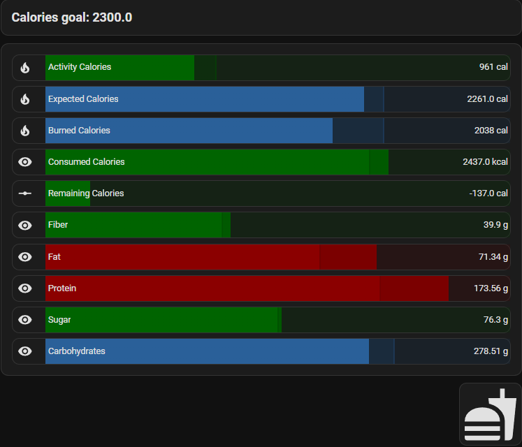

Here’s how I use it in my own dashboard: a custom bar-card to show daily nutrition values alongside my Fitbit burned calories, with a refresh button at the bottom:

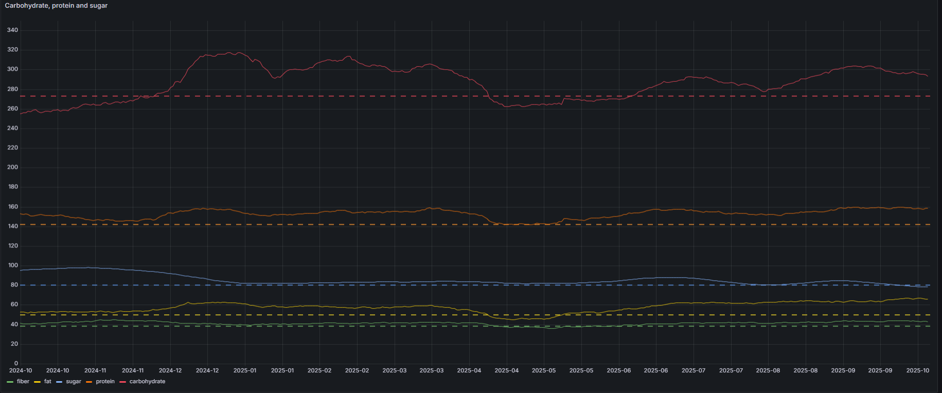

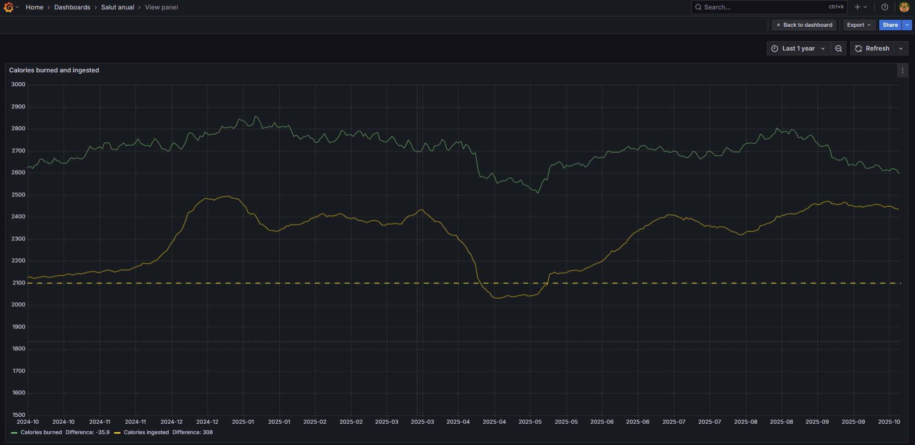

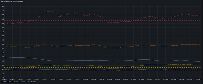

I also use Grafana to visualize historical nutrition data over time:

This is brilliant. I use myfitnesspal to track food/calories but I’ve never found a way to get it into HA and it’s now bloated with ads so going to make the switch to fatsecret. Can you share your yaml for the bar cards? That looks great!
Thanks! I also came from MyFitnessPal and changed to FatSecret some time ago.
Here’s the YAML I use for the bar-cards. I’m using the custom:bar-card and a custom:button-card at the bottom.
