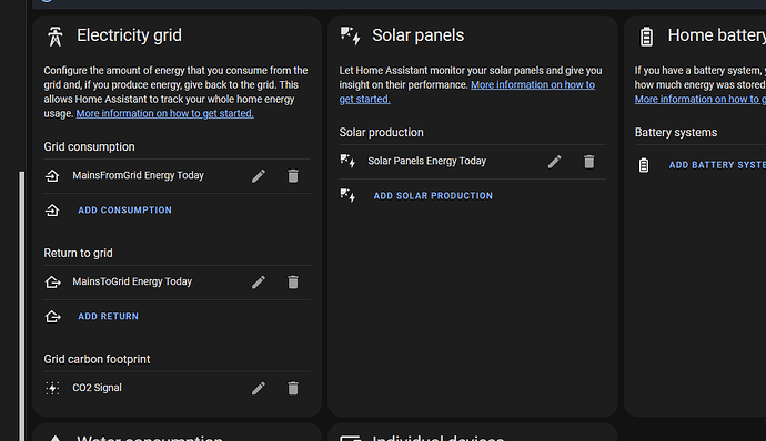

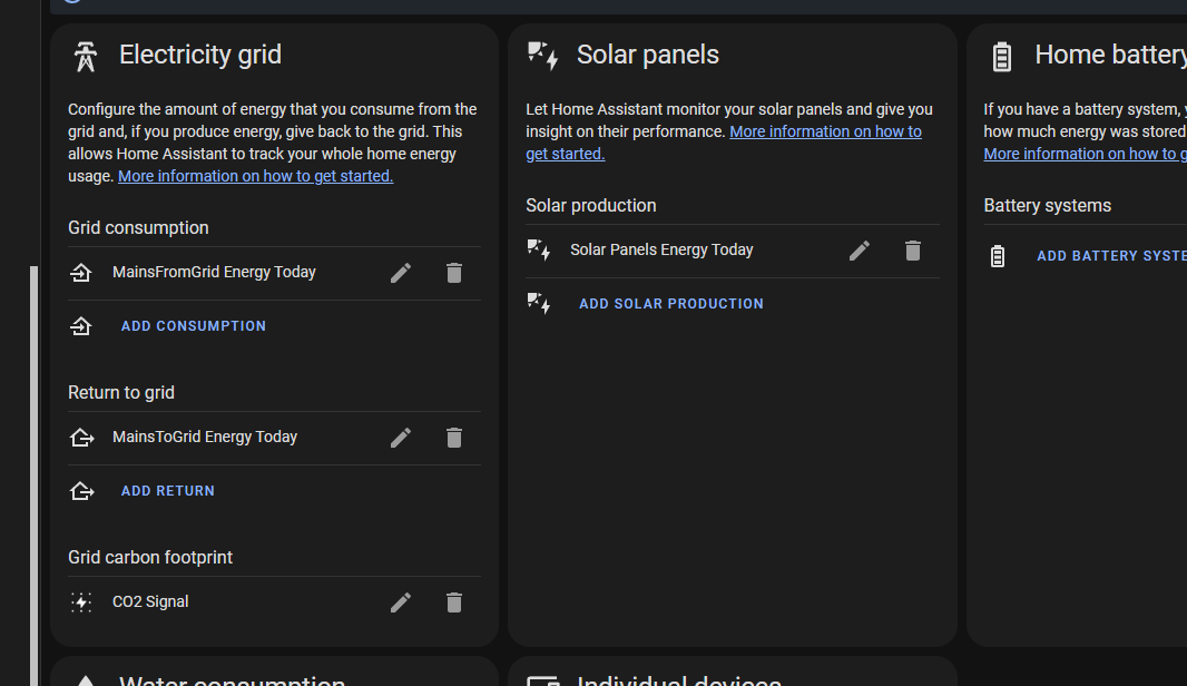

When you go to the dashboard configuration, your total house consumption is…
What you see is my house. So my house simply is Channel A + Channel B = total house consumption.
Ok, that seems clear. However, I get all these numbers from my solaredge and they should add up to ±zero. Seems there is need for more contemplation.

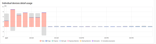

Today, I just noticed some “negative untracked consumption”. I was initially thinking “this is a bug” but then I remembered the even buggier thing that I just enabled… I do not have CT clamps on my 240V split phase dryer or my 240V split phase heat pump, so I am using the Sense integration. Sense uses “machine learning” to figure out if I am using either of these devices and it reporting out the numbers its finding in the Sense platform into HA, but the energy values Appear to come in quite chunky, and can happen out of sync with the hours tracked by HA. This results in too much consumption in one hour compared with the data from my electrical meter. On the day the data is good, but bad energy accumulation populating into the wrong hour appears to be the culprit here.

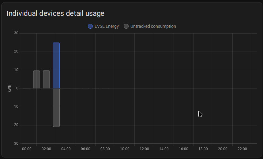

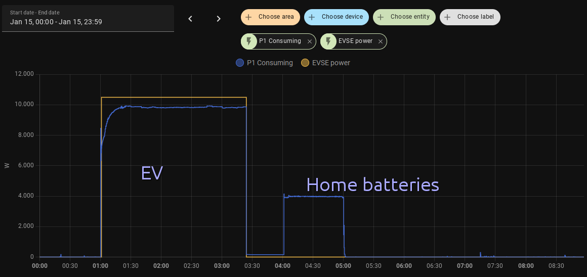

There is clearly something wrong with the untracked consumption timing.
This is my consumption last night, including our EV (and later home batteries). The EVSE power is a phantom power device that reports the default EV consumed power when the charger is ‘on’. It is a little bit of to reality, but not much.
The Energy dashboard however reports Untracked consumption during the charge and all the energy that was consumed crammed into the 3-4 am slot?
I can’t even start to imagine what the dashboard was thinking here?
Hmm… now I think of it, the EVSE energy is an integrator over the EVSE power, so I guess it’ll only integrate on the left or rightside steps depending on the configuration of the integrator. And there are only two steps (on/off). That’s the problem here?

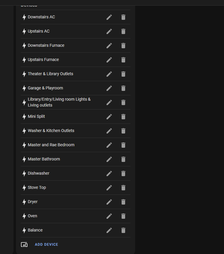

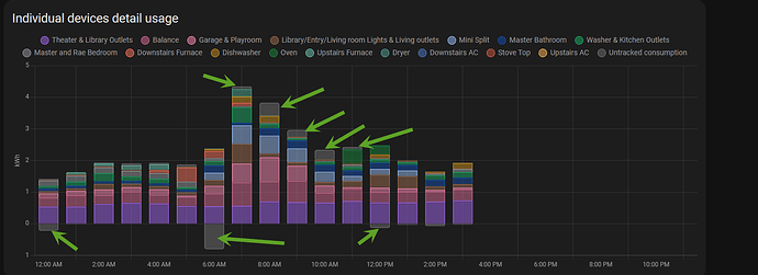

Having some issues here, and am trying to figure outo where I am going wrong…I have an Emporia Vue, so 2 big clamps attached to my mains, and a bunch attached to my others. The way the Vue works, is if its not in those it gets called “Balance”
Yet I still have untracked consumption even when I have the balance in my individual devices.
Here is how I have everything laid out.
I dont see how I am getting these figures.
You would need to share the entire view of your energy for the same period for us to understand, just showing a picture of individual devices we have no way to verify if it is correct or not.
Exporting a csv and sharing it would be a helpful way to share some context.
Sorry, I missed your reply.
Here is the CSV.
Ok, using that, look at your 6AM hour, as you pointed out with your arrow.
Grid consumption sensor says 1.564kWh. Solar is 0.008kWh.
So you have a total energy coming into the house of 1.572 kWh.
Add up all your individual device consumption sensors for that hour, and they total 2.377kWh.
Subtracting your known device consumption from your total available energy gives (1.572 - 2.377 = -0.8kWh). That’s why there is a big negative untracked consumption there, because you’re consuming more energy than possibly exists.
One of your sensors must be wrong, whether that is the grid or one of the devices I don’t know, but what your sensors are collectively reporting is impossible in reality.

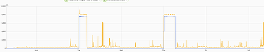

Seems to only be happening when I’m charging my EV. I don’t return to grid, but the graph shows as though I do.
Seems ok if I log Watts of the EV vs. overall house consumption:

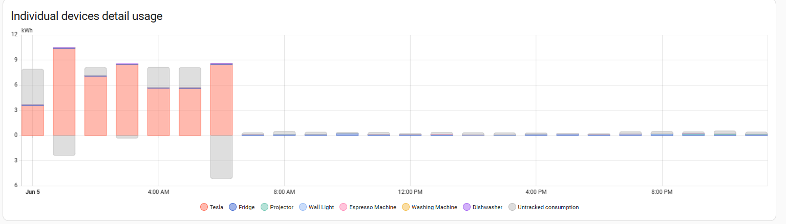

Saw this issue today in my energy dashboard, I believe it’s a sampling/framing issue from what I understand. A fix would still be nice, as “negative consumption” does not make sense in this context.
