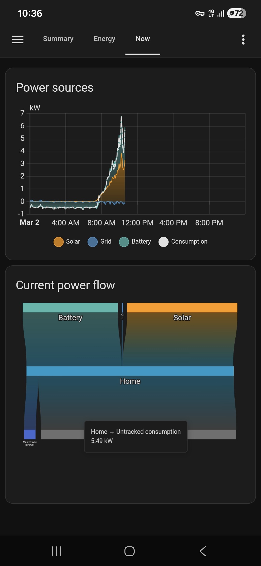

I am one of them too, I have this untracked energy which is proportional to the solar production.
So my system is a victron system and it has an energy metter, and before the energy is consumed by the household appliances, the energy is also measured by a zigbee circuit breaker with energy metter “MasterSwitch Power”, therefore I should not see all this untracked energy.
All the untracked energy should eventually be the loses in the inverters, bit 5kW???

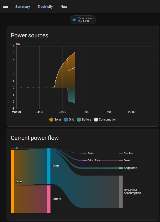

My configuration consider also the battery charge and discharge, it seems that the untracked consuption consider also the energy that goes into the battery.
Some time ago - can’t match to specific HA release - I started to see invalid untracked consumption, which wasn’t case before. During the winter there’s low PV gains, thus system mostly charge batteries slowly. But since we have more sun here, I see correct bar graph on a Summary page, correct battery charge/discharge values, but obviously battery charge is now missing in the calculation formula and misreport it as untracked consumption. I think an image is self-explaining. I think it’s started with update which added Power sources and some other changes to Energy dashboard.
