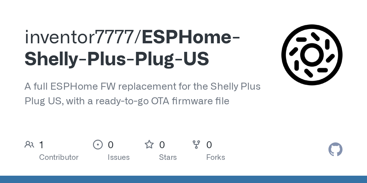

Feature-rich ESPHome OTA firmware for FW 1.7+ Shelly Plus Plug US
Hey everyone! After Shelly was acquired by Schneider, as well as recent trends towards secure bootloaders, I decided to take true ownership of my 5 Shelly Plus Plug USes and move fully to ESPHome
I started just hoping to get all the original features, but that quickly turned into a full on replacement firmware with all kinds of new features :grinning_face_with_smiling_eyes:
E.g
  • Persistent lifetime energy, relay on-time, relay-cycle, and button-press counters.
  • Peak power, current, voltage, internal temperature, and minimum-voltage records.
  • Apparent power and power factor.
  • Configurable overcurrent, overvoltage, undervoltage, overpower, and overtemperature limits, with trip counters, last-trip reason, and optional automatic recovery.
  • Configurable power-on behavior, auto-off timer, button lock, and blue LED brightness for on and standby states.
  • Reset buttons for statistics, protection history, extrema, and lifetime energy.
Unlike the previous shenanigans involving Tasmota bridge on pre-1.5 FW, I’ve discovered that it is possible to simply recreate Shelly’s firmware file but replaced with the ESPHome app, then you can use ESPHome to OTA update the bootloader and then finally use it like a normal ESPHome device.
I wouldn’t be surprised if the same method worked to OTA other Shelly devices, but currently I only have the Plus Plug US to test.
Instructions and details are at my GitHub repo below​:backhand_index_pointing_down:t2:
