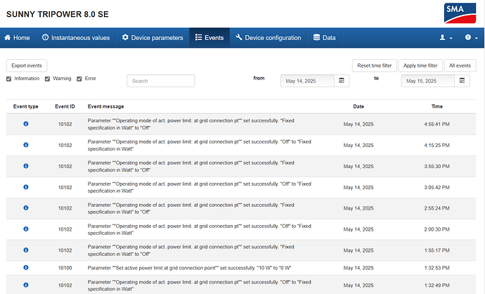

The reset seems to be happening every hour based on the logs of SMA UI (see below)
All settings have been applied manually in the SMA UI (except the resets which have been happening automagically)
The shell commands are doing what you would do when you log in via a browsers using the inverter IP adress to manually do this:

  Periodically puts inverter back into correct mode, as SMA automatically
  disables it by itself

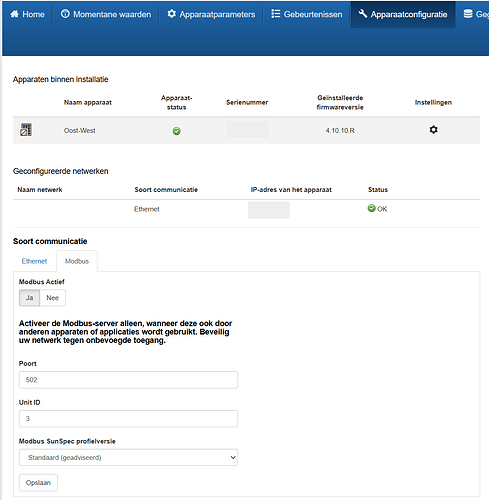

I have a SMA Tripower 8.0 and after some research, I’ve found a way to limit the power without writing to registers that are located in flash: SMA warns against cyclically writing to most registers, except a few in the sunspec modbus interface. (https://sunspec.org/wp-content/uploads/2025/01/SunSpec-Modbus-IEEE-1547-2018-Profile-Specification-and-Implementation-Guide-v1.1-1.pdf)
Access to the sunspec modbus (as opposed to the direct SMA modbus interface) is over slave address 126 (when the device address in the modbus setup is set to 3). The register to control is 40349 (40348 in Home Assistant) and contains the power as a percentage of the max power. 0 is off, 10000 is 100% The factor 1.25 for raw_power is the result of this calculation: (required_power / 8000)*10000 to map the required power on the scale from 0 to 10000 with a max power of 8000W.
With some AI assistance, this automation came out, is tested and seems 100% functional:

Thanks for sharing. Besides activating Modbus, are there any other settings that need to be enabled in the SMA local web interface? I’m using a SUNNY TRIPOWER 10.0, but on my side it doesn’t seem to respond to the register change.

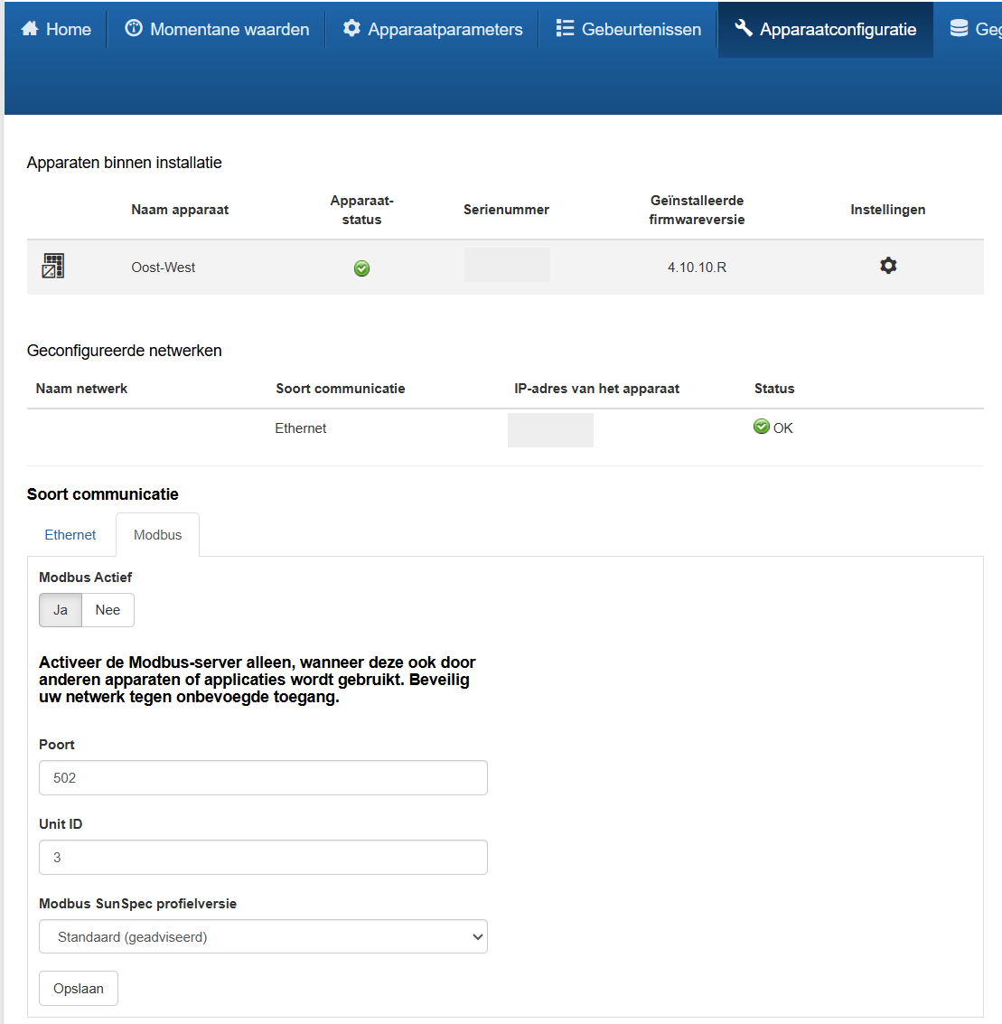

This is my settings page.

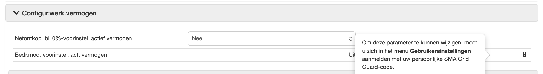

I’m afraid it’s not working on my side due to the setting “Operating mode of active power limitation” not being set to “External active power setpoint”. Changing this setting requires an SMA Grid Guard code.
Although I can successfully write to and read from the configured register, the active power does not change in real time.
Update: The solution of @johanbos is working at my side. Thanks for sharing your insights!
