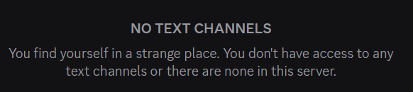

Hi. Sorry, that Discord link doesn’t work for me.

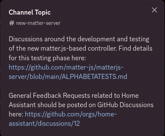

It’s there…
Try this: Home Assistant
It’s called new-matter-server. it’s in the feedback category where the beta channel was just moved to…
Thank you. I’m in now.
