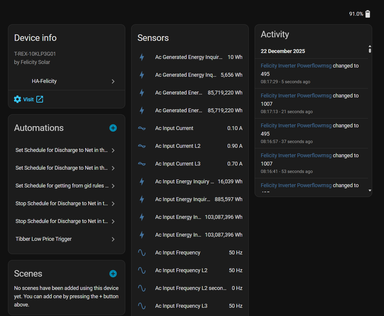

After switch_port_card_pro, went on to SDM630 integration to learn about modbus and today launching Felicity inverter integration. Super happy with this, no more yaml modbus anywhere in my setup. Finally!
Fully tested, running smoothly.
Probably not super many Felicity inverters out there but if you do, enjoy.
Currently only one model supported (see picture). Other models should be easy enough to add if configuration wise they are similar.

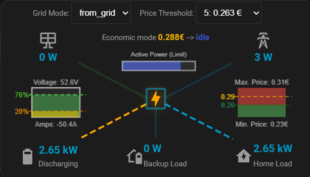

Also, which entity should i use to see ac output to load / backup and to grid?
The card will show all of it, animated :slight_smile:
