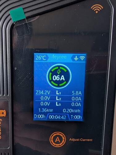

I was inpatient so already tested it even on my side. It indeed works if I disconnect L2 and L3. So I can dynamically control amps delivered even on just single phase with power ranging from 1.36kW to 3.5kW on 3-phase feyree portable charger - cool.

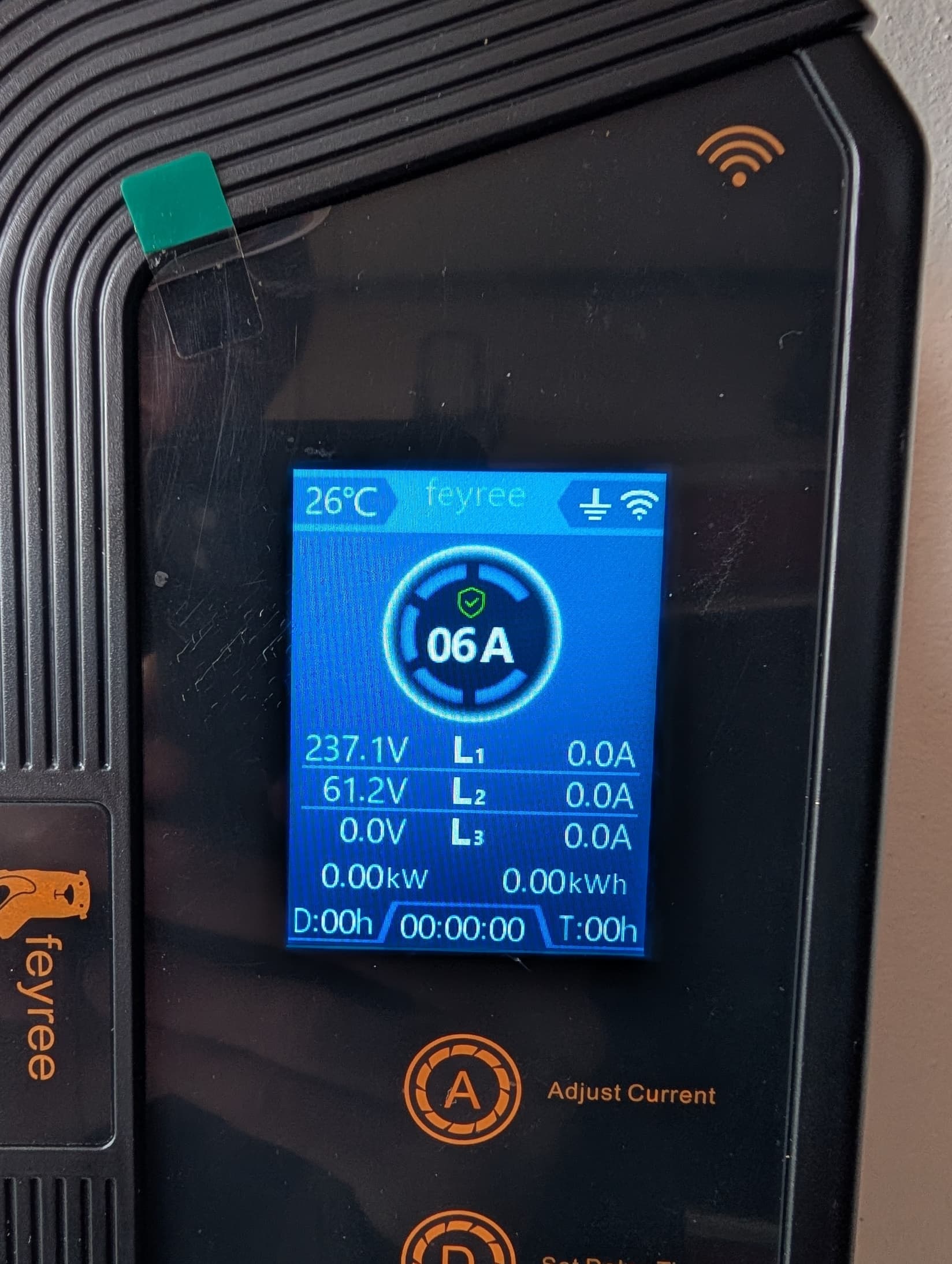

The only thing what surprised me is that charger reports 60V in L2 phase in idle state. But once the charging start, it show 0V in L2. Does it happen also to you guys? I hope I will not damage the car because of that. I am certain this is not because of some bad wiring.

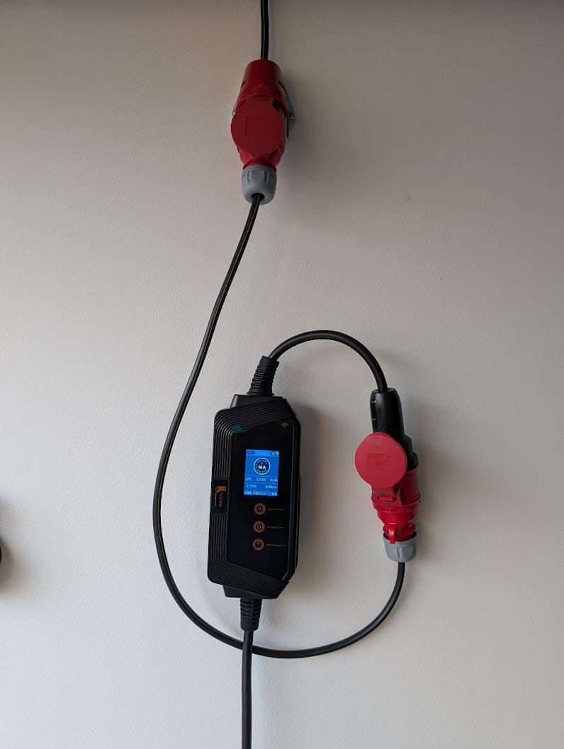

Just follow up to my post. I build “3phase>1phase cable” and now portable 3phase feyree ev charger even switch its UI to 1-phase mode. Didn’t expect that. :slight_smile: I have also 230V charger, but that doesn’t connect to HA, so I am happy to be able to use my feyree charger even for lower power. Switching back to 3-phase charging is just by quick disconnection of that middle cable.
