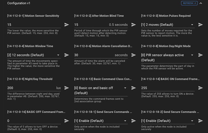

You will find the right settings in the manual but it is also pretty clear when you open the device in ZwaveJS-UI, config:

I’ve set parameter 62 (measuring interval) and 64 (reporting interval) to 300 on one sensor, left them blank on the other one. No difference.
