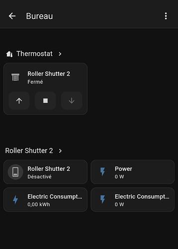

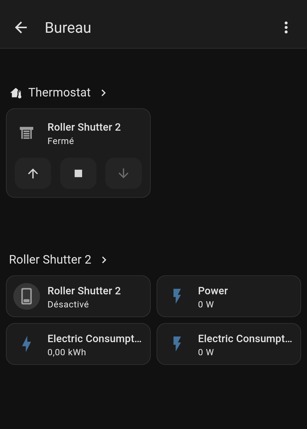

My issue is the following: I included a roller shutter 2 Fibaro ton test and it is seen as Thermostat category !!!
I don’t understand why. I can get access to all parameters, I can use it but seen as thermostat
Do you have any tips to change the category to Switch ???

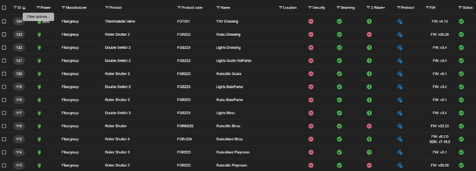

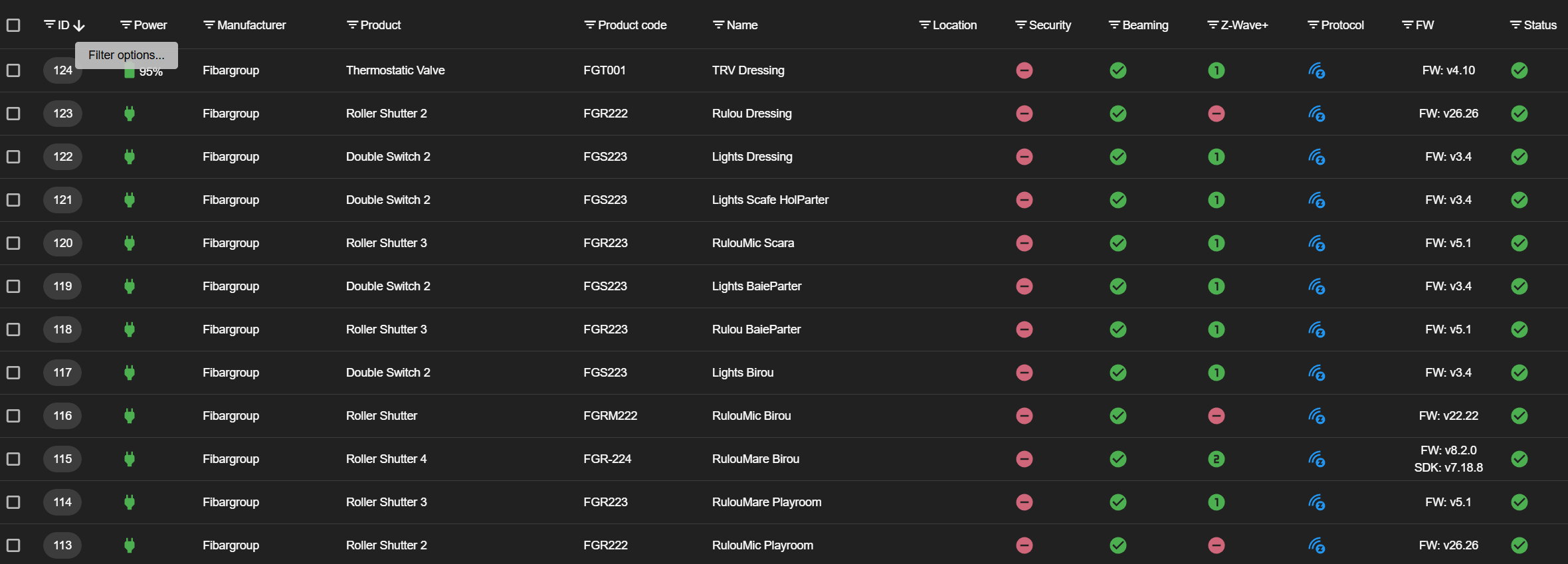

I included a bunch of Fibaro Roller Shutter 2 and they all work well.
I suggest you exclude/include again. I’m using the Zwave JS UI with ZWA-2.
Almost always when the included device is not presented as it should be there is an issue with the signal while including. Also , make sure you extended the default inclusion time which is 30 sec. This helped me a lot with the NWI.
