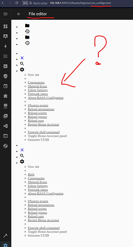

since a couple of months the file-editor addon looks “strange”. I’ve tried to reinstall the add-on many times (and even the complete HA-installation) without any improvement.

Did you try to clear your browser cache ?
in all the companion apps (even on new installed devices) the same behavior. I’ve tried right now the browser I never used before for HA (edge), so it looks the same.
Therefore I guess the cache is not the reason.
The css is not rendered correct. What version of file editor are you using ?
I’ve reinstalled the file editor a couple of minutes ago. So, I currently have the latest 5.8.0 version of the add-on.
Any add blockers active ? Pihole, adguard ?
yes, adguard is installed.
one minute later
adguard deactivated and the file-editor looks fine.
Hmm, ok.
Thank you, at least I know now the reason.
Maybe try with adguard disabled.
I’ve encountered the same, checked the adguard logs, and based on that, I allowed access to “aepxlg.adobe.com”, and the file editor seems to work again.
Tnx for the tip, I have no-script on in firefox and this blocked calls to cloudflare.com. After granting acces to cloudflare the File Editor addon worked again. I don’t like these calls to external sites, I really would like to run it local.
