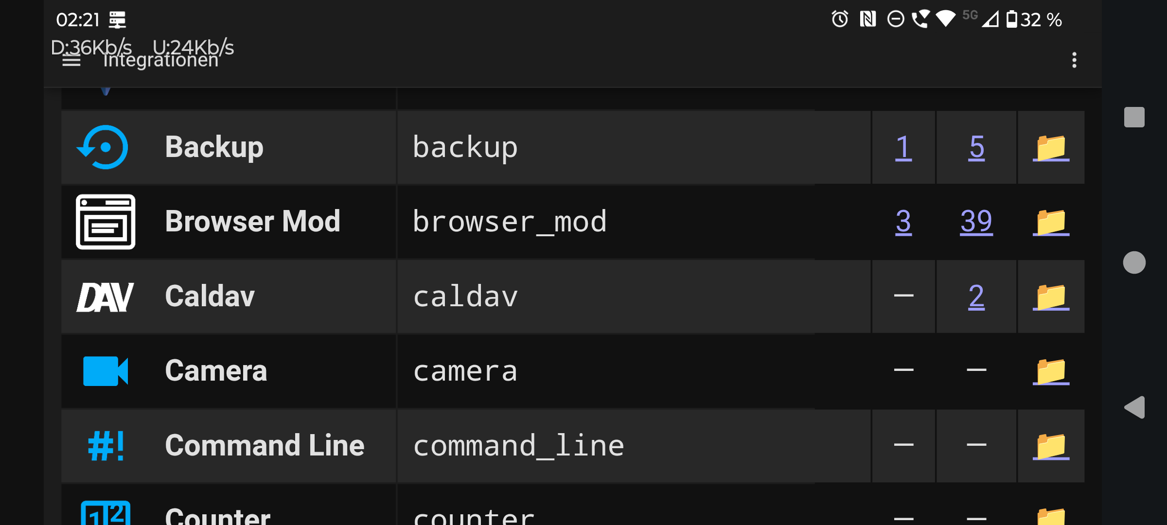

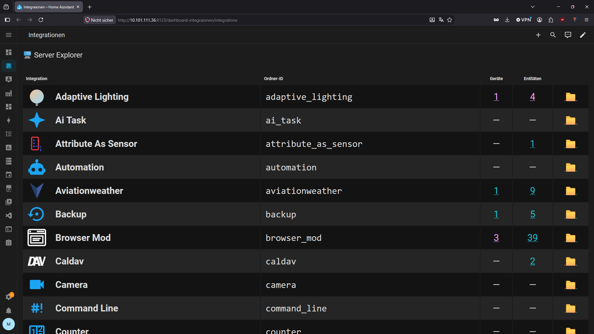

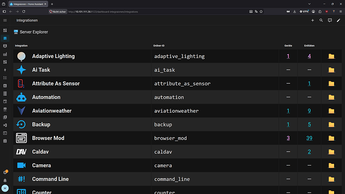

And that’s how it looks:
Desktop:

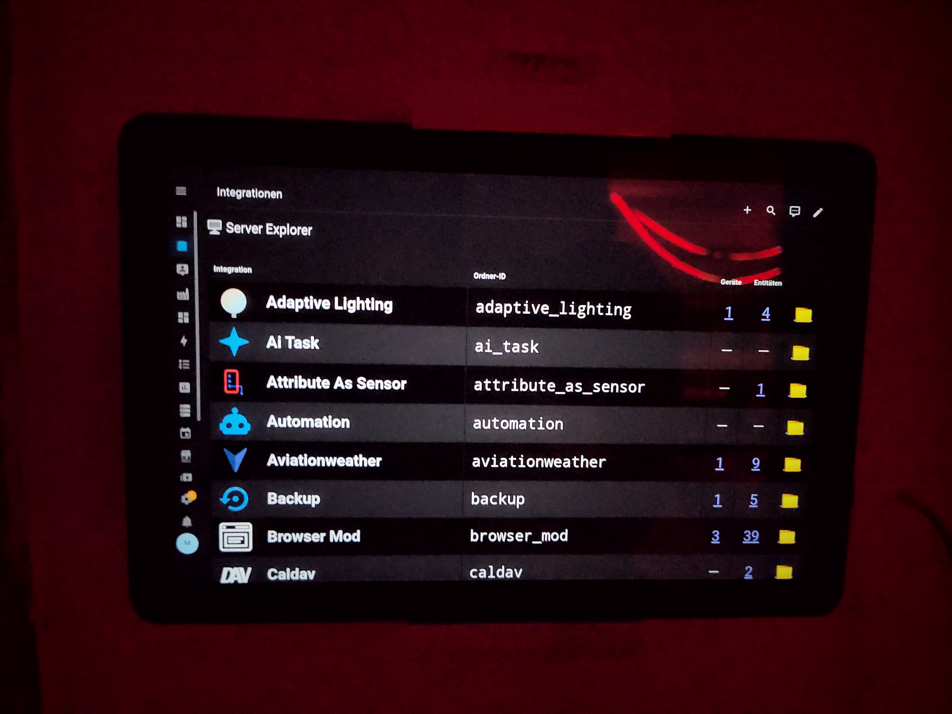

Tablet 10" landscape:
(sorry for the background, night lighting due to sleeping kids)

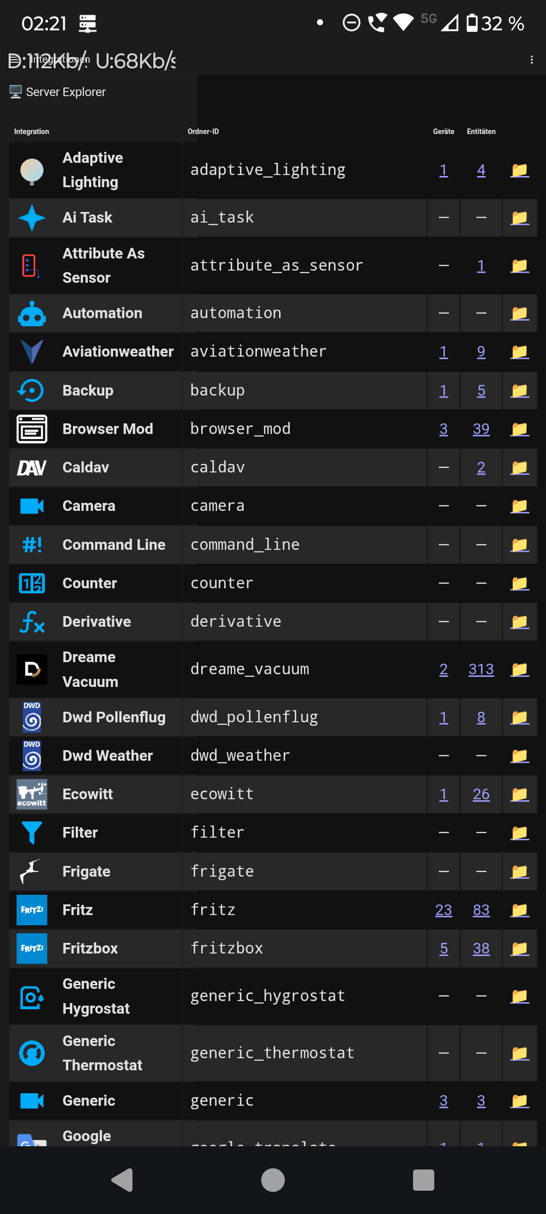

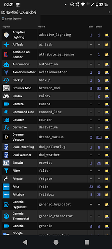

Companion App on a Motorola Edge 30 Pro:
Landscape:
Portrait:
