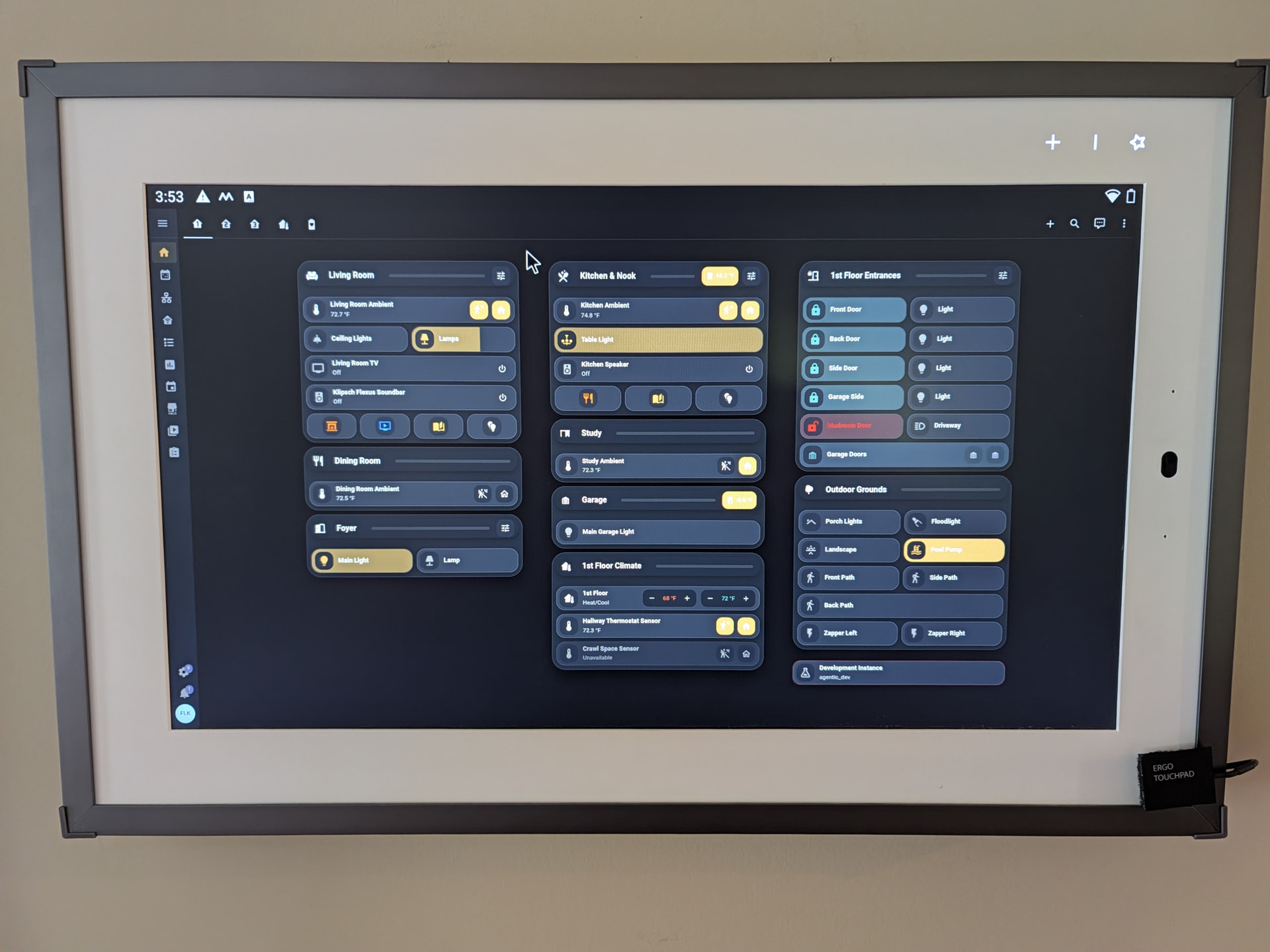

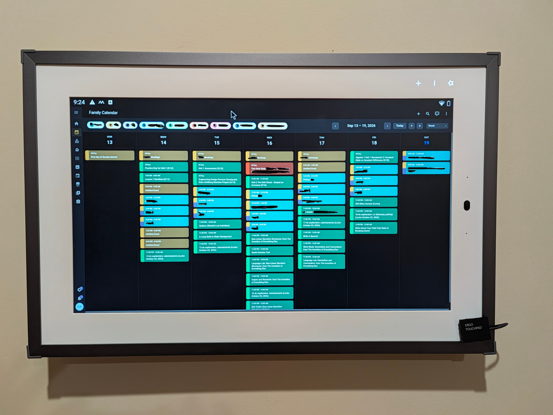

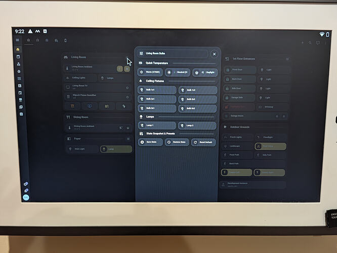

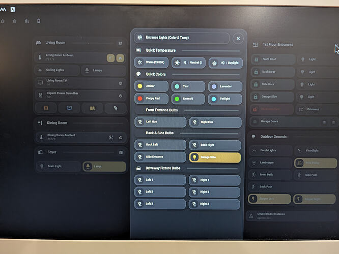

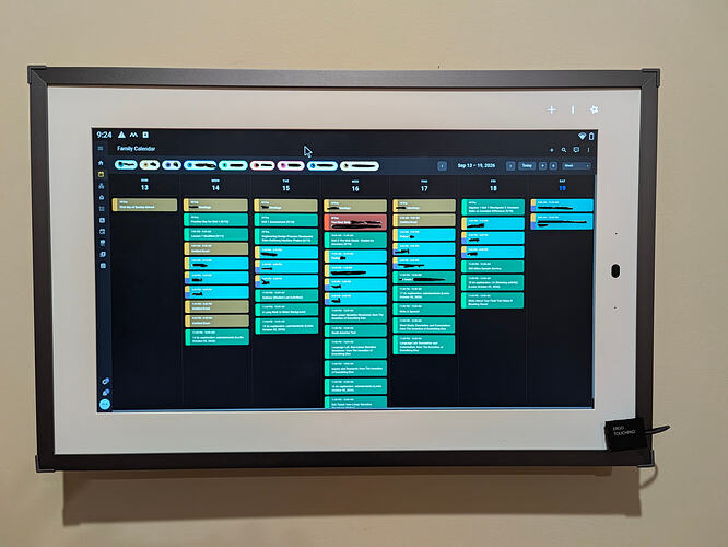

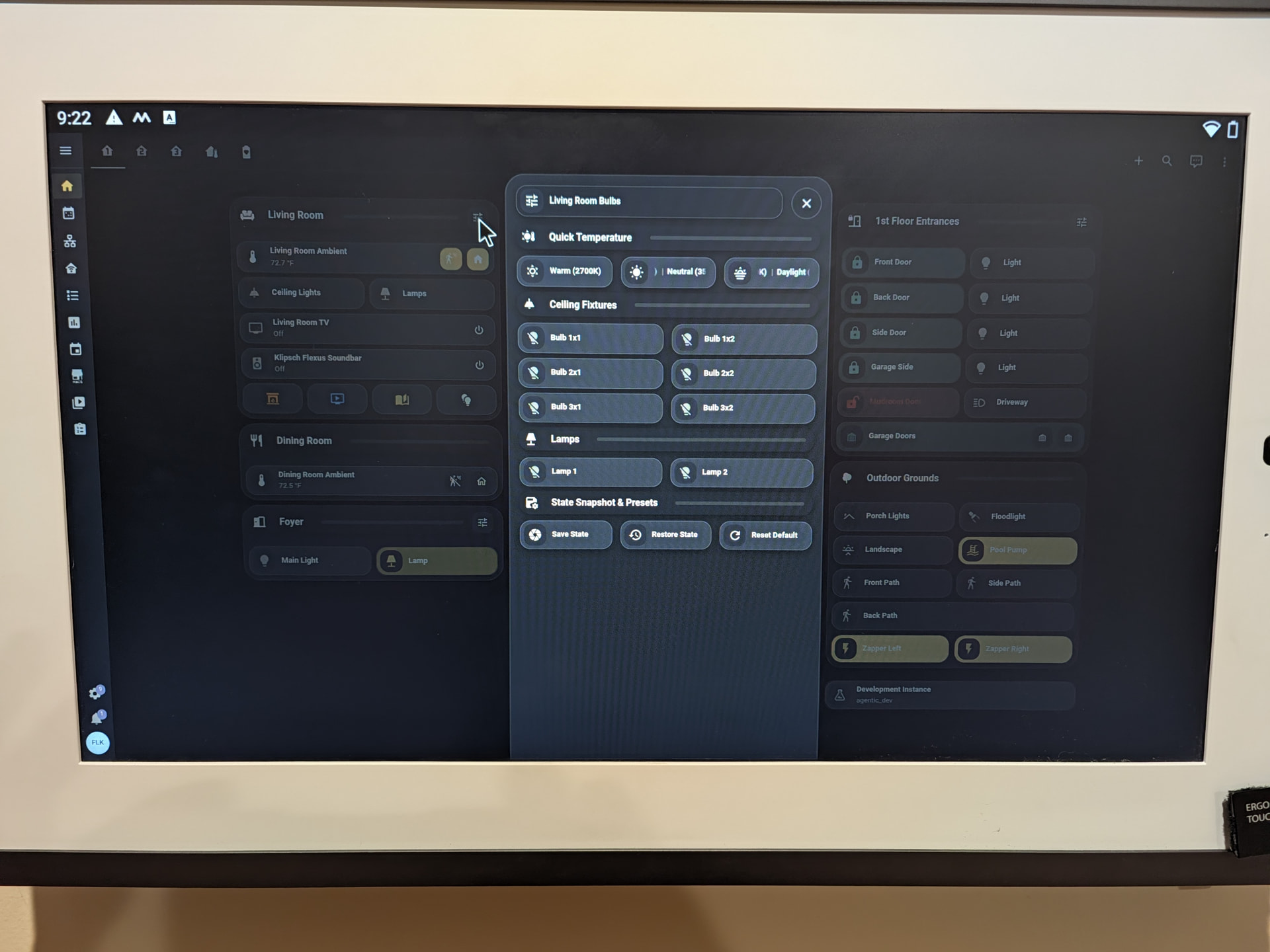

My Home Assistant sits is a docker on my Synology. I have mqtt sitting between it and Hubitat. I run Gitlab, so I have all of my yamls sitting in a repo with a main branch serving my ha-production container and an agentic-dev branch serving my ha-development container. I have a clever git pull script that I webhook from gitlab. As soon as I commit the respective branch, the change is visible 10 seconds later. I have been using. Antigravity IDE for doing all of my dashboard work. Since I have stood up an MCP that pulls from MQTT, it is super smart and effective in its changes.
Looks nice! What dashboard cards/popups are those?
Mushroom, bubble, and stack in card are installed. I am not sure which one the Antigravity used. :smiley:
