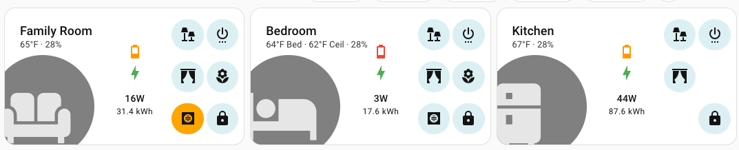

To give you an idea of the direction I was going, these are a few cards. They take a disturbing amount of code to achieve, with each room summary being about 300 total lines of YAML. It’s beyond just “pretty”, those big icons are also visual cues and change color based on if there is motion in that room or how many lights are on.

Those room overviews do use custom button cards, along with some Mushroom cards. I think where it all really goes downhill is I have each of those buttons call a popup of auto entities, that’s where the real templating and card-modding happens. So if you figure even just 6 buttons per card for 10 areas = 60 heavily templated and card modded popups - that’s where the real problem lies.
I’m exploring cross-dashboard popups, which will likely fix the problem, but I think also cutting down on the need for card mod and auto entities to be so heavily templated in the card but rather in a template entity that stashes what’s needed in attributes might be the only way to get this dash moving forward.
