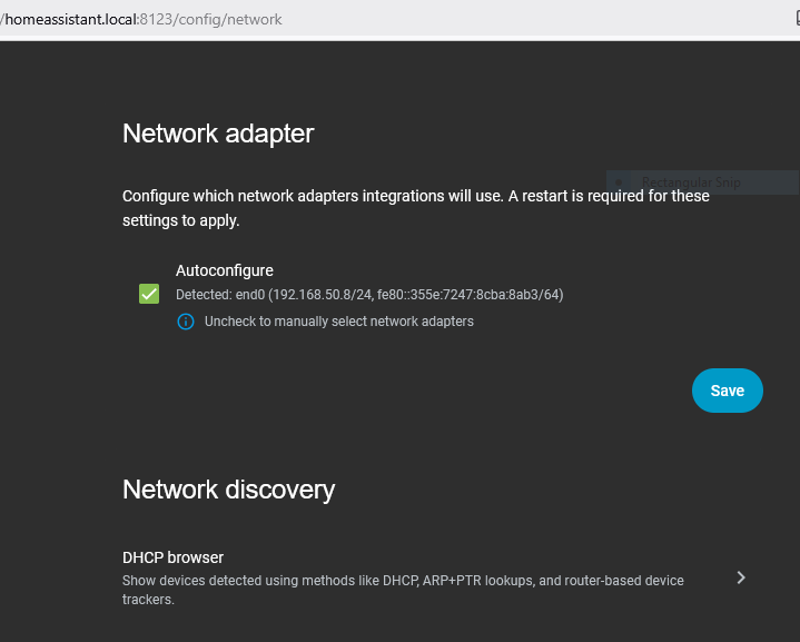

Here you find MAC/IP in HA, And on your Router , as mentioned in above post, you should have a similar view
