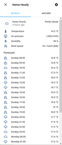

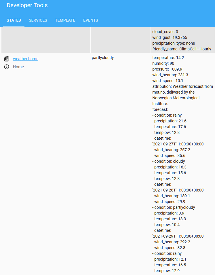

Have a look to see if you can find an Integration that provides hourly forcasts for you area (e.g. Climacall or Meteorologisk institutt (Met.no). I live in the UK and the latter provides an entity that gives an hourly forcast in the Front End:
Presumably the temperature for the time you require could be extracted using a suitable template (note that there is a ‘templow’ attribute but I am unsure of what this actually is).

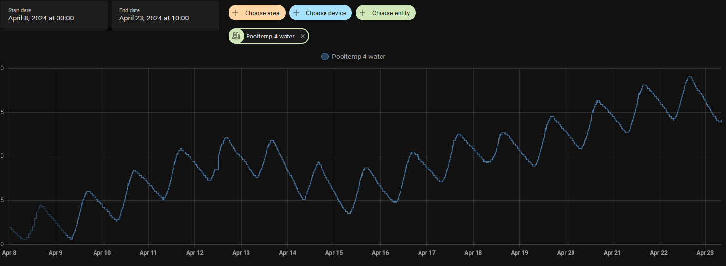

We’re in the south-west US and pool-season is upon us. I have a sensor for pool water temperature which records ever 5 minutes. I keep a 14 day recorder trail.
Wifey asked if I could set up a sensor which could estimate when the pool water would be at it’s highest temperature today and tomorrow.
Based on the data I have available and what I’m seeing above, it seems possible?
I am not sure what is causing the pool water to heat, is this just sunshine?

@Emphyrio - Yep, in summer our pool will easily reach 90-91°F just by sunshine
I was asking because you might want to look for a correlation with predicted temperature or sunshine (uv index).
