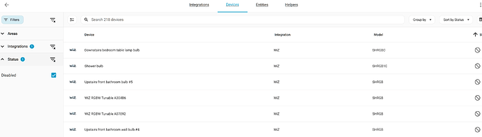

The issue is that the “Filters / Status / Disabled” check box under “Devices” performs an “OR” operation, not an “AND” filter. I see a list of 736 devices with the checkbox checked, and 620 devices with the checkbox unchecked. This is inconsistent with the “Status / Disabled” filter when clicking the “Entities” tab, which is properly an AND filter.
I was eventually able to find the 116 disabled devices by adding the “Status” column under “Customize table” in the “Devices tab”, and sorting by that column.

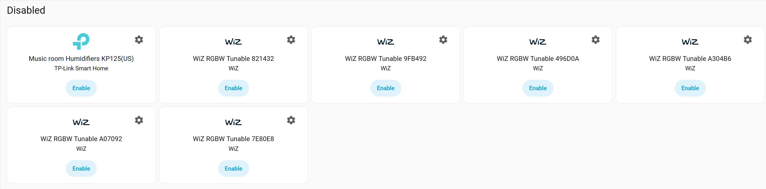

Following up on this, the method you suggested is not entirely satisfactory.

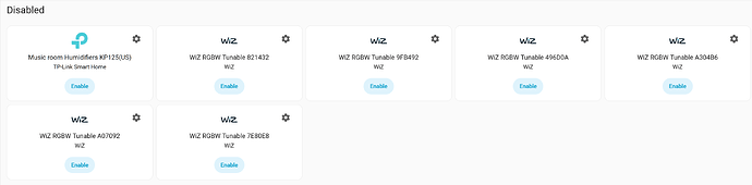

Here is what it shows right now, for instance, with my Wiz bulbs.
The device names shown are too generic to make sense of. This seems to be the integration’s original device name. The only specifics are the last 6 hex digits of the MAC address - not enough to identify the device.
I renamed most of my Wiz devices, including several of these disabled ones.

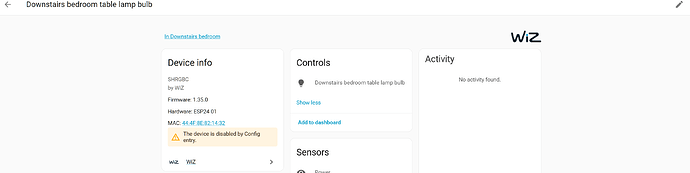

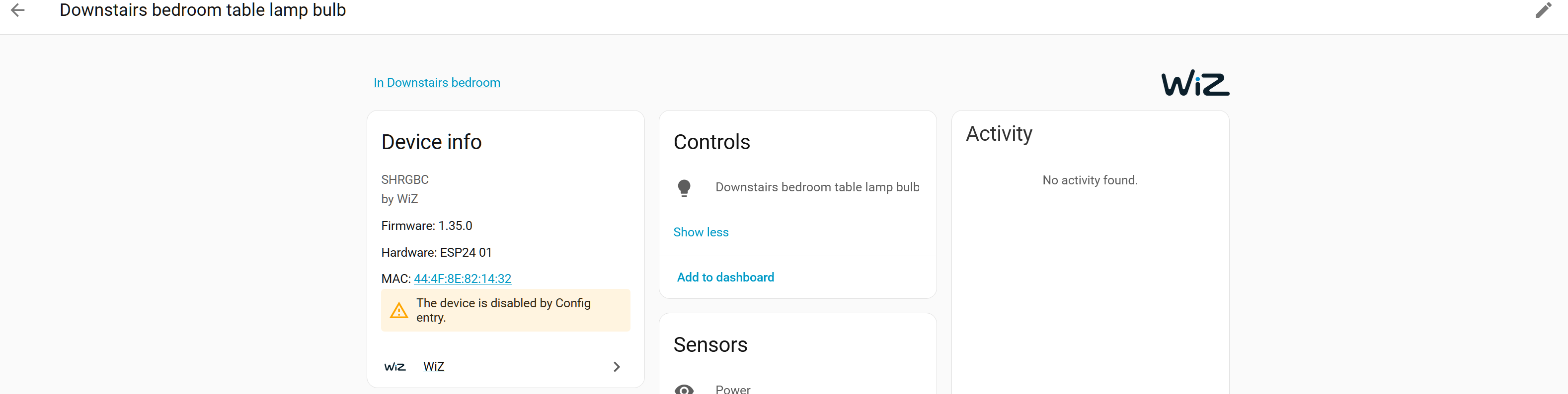

For example, this one :
It shows as “WIZ RGBW Tunable 821432” in the “Integrations / disabled” screen, but shows as “Downstairs bedroom table lamp bulb” when I filter by “Integrations: Wiz”, include : “Status: disabled”, add the “Status” column to the columns, and sort by the status column.
I’m not sure why the proper device names don’t show in Integrations / Disabled, but do show in Devices, with the above parameters.
