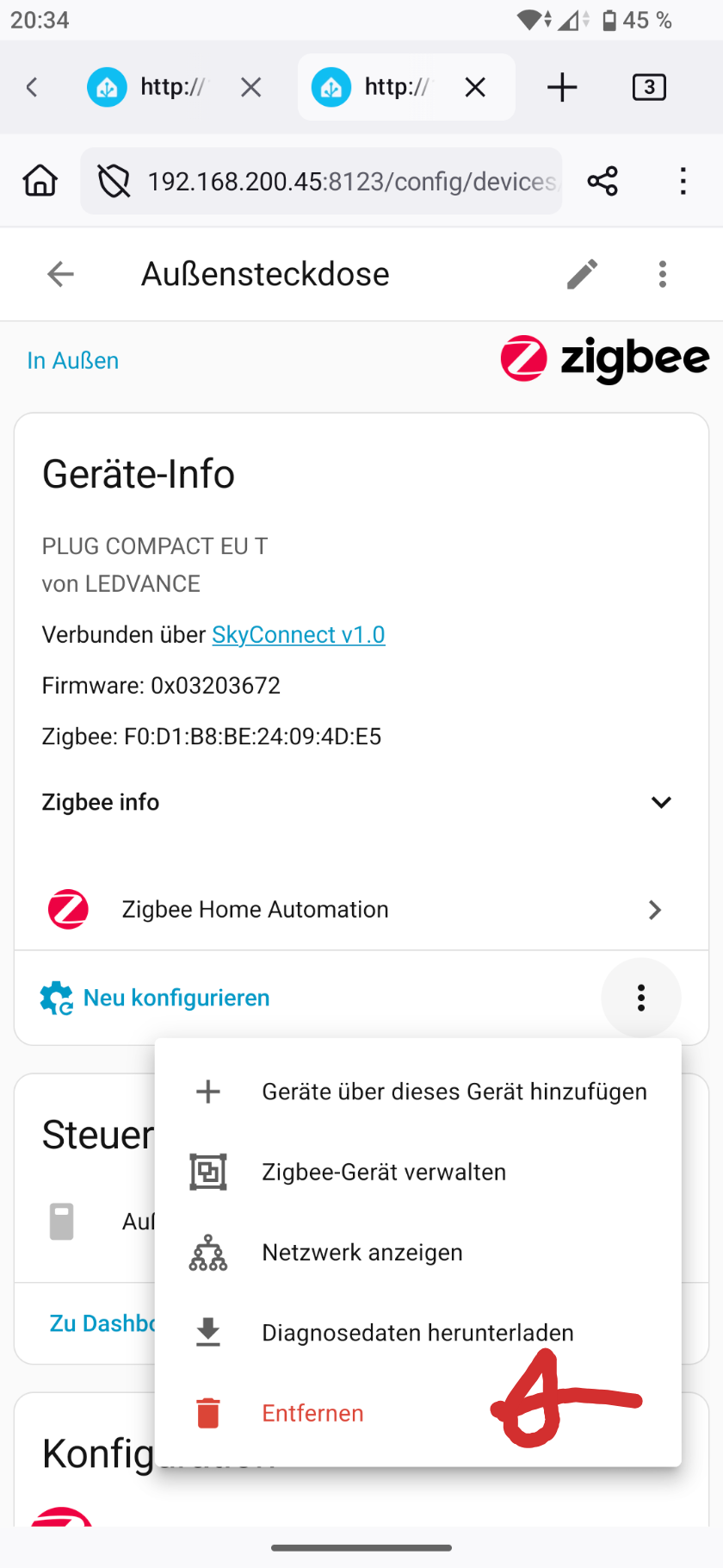

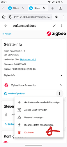

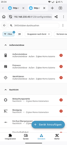

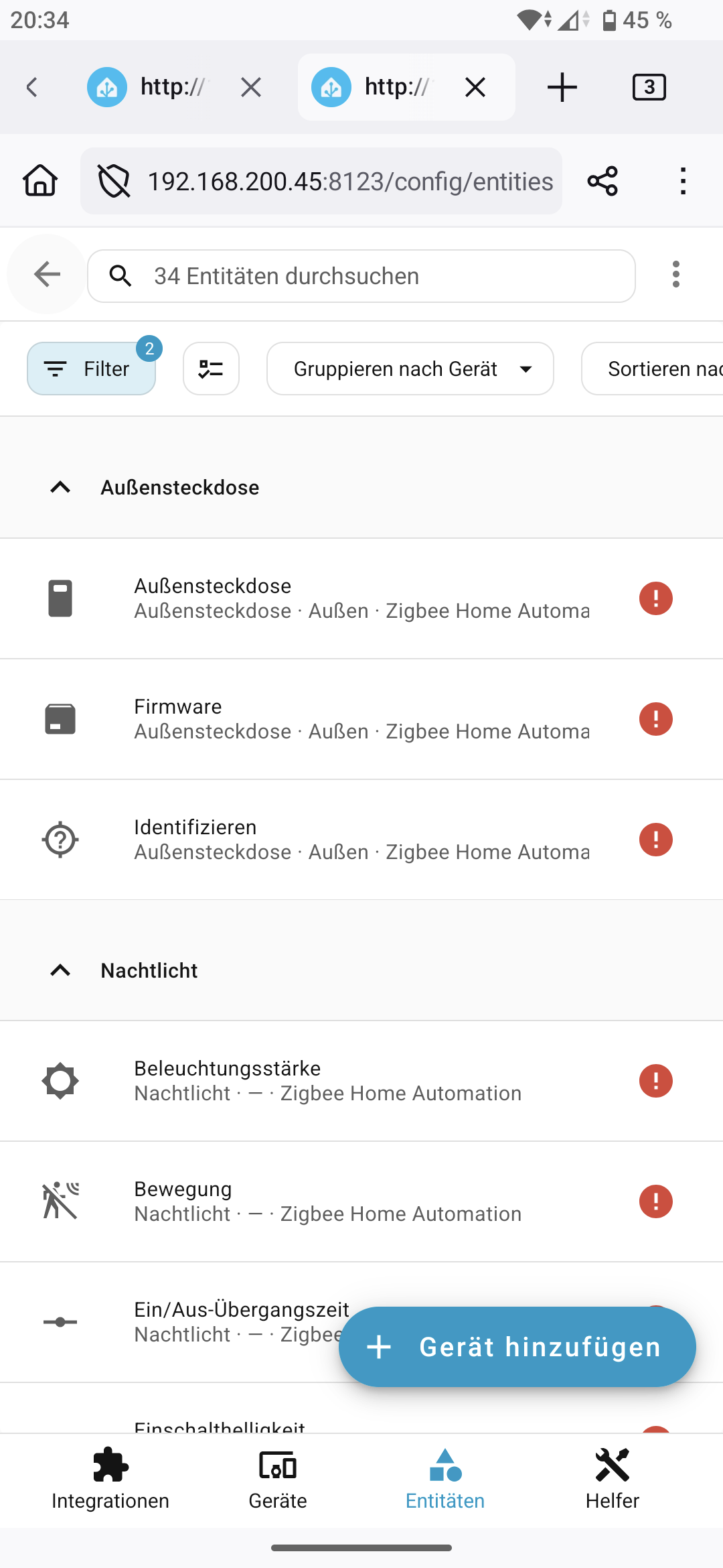

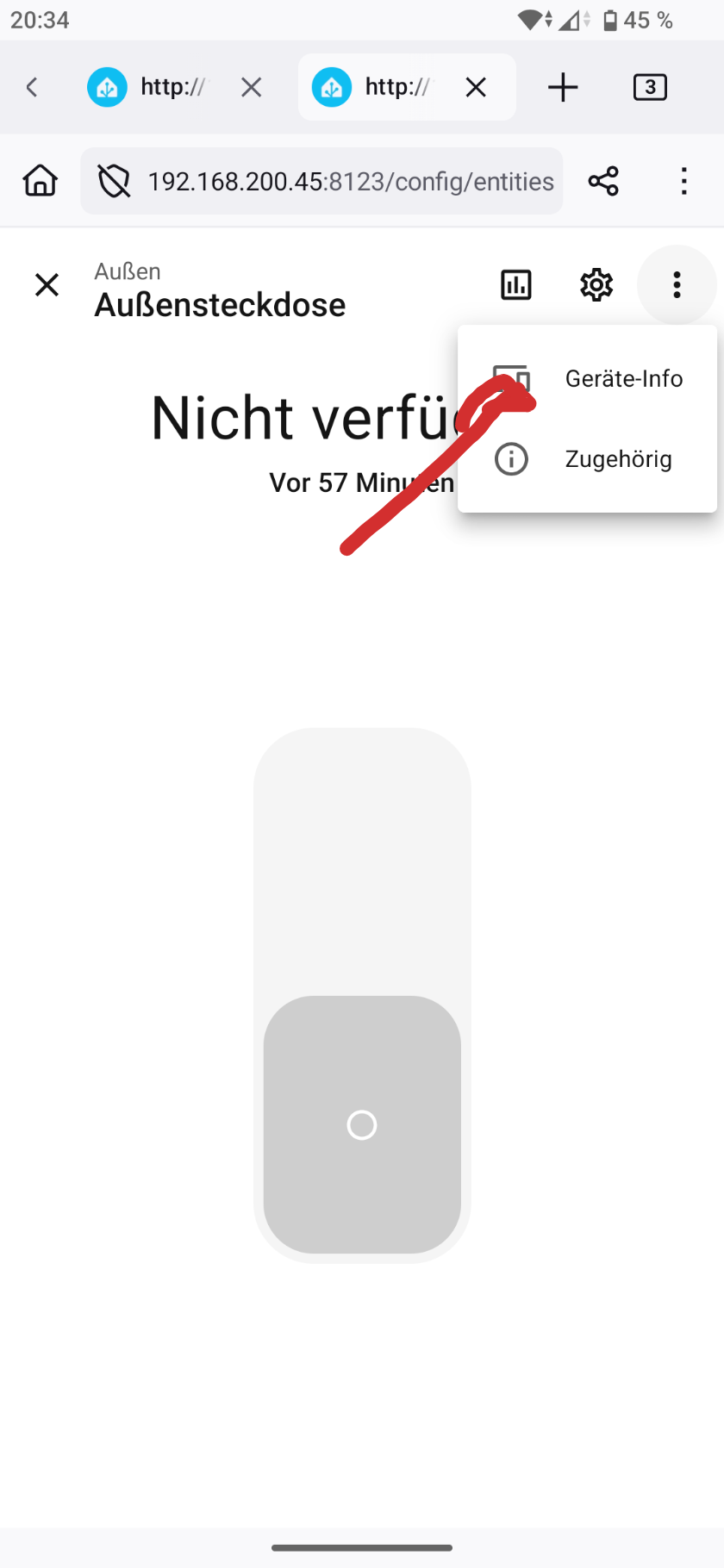

Go to entities list and filter by integration “ZigBee” and state “unavailable”, group by device. Then select some entity and go from there to the corresponding device, then you can delete the device from HA:
