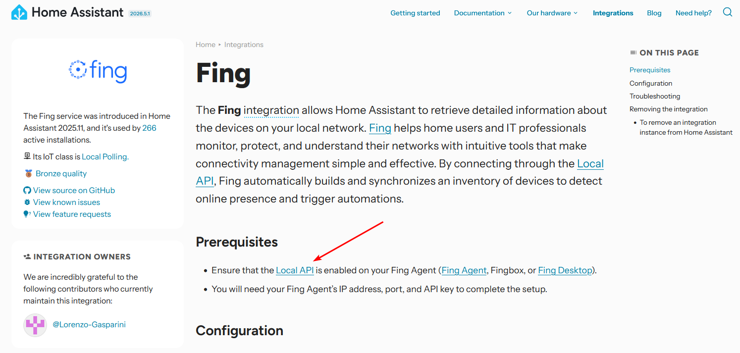

The Fing integration requires that (Fing Agent) software to be installed somewhere else on your network, on some other physical device.
Do you have Fing Agent set up on some other device that's connected to your network?

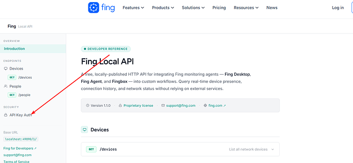

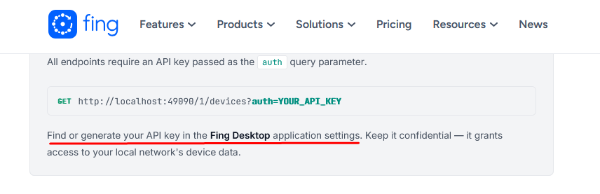

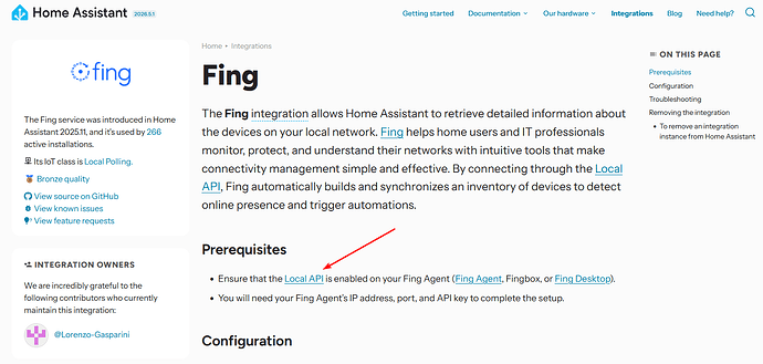

I highly suggest you use the documentation. I've never seen this software until your question and found your answer by just following links:
So worked it out that install of fing agent on Raspberry was easy it was finding the api that took soem doing. And that was a case of using the desktop windows app and the cloud app to find. Once I had those HAOS worked fine.

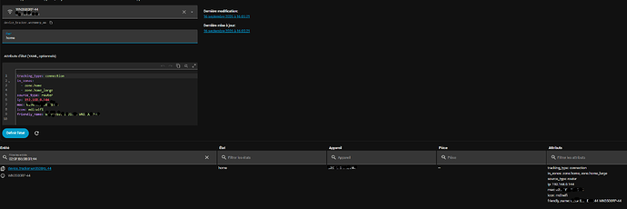

i’ve installed the fing integration on my HA instance but not sure how to use it to id which mac is up or down!??
who could shed some
lights : i get a list of all my devices but …not sure how?
