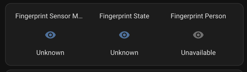

The sensor is working fine as verified through Arduino serial monitor and I’ve successfully made an automation to open a door by reading info within the MQTT state topic but my lovelace cards which should show the state of reading/learning entities are just showing a status “unknown” and don’t seem to be getting any info through MQTT. When I subscribe to the relevant topics they are being received by my Home Assistant MQTT server but the entities don’t seem to be ‘connecting’ to them.
This is the configuration code I used to try to set up the entities; I’m suspecting it’s some kind of json formatting problem but I just don’t know enough about programming to identify the problem. Anyone able to help please?

Figured it out. Parent MQTT entity was formatted wrong.
