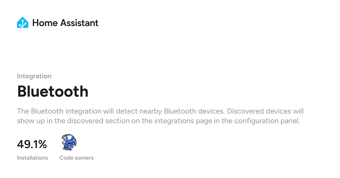

Could it be bluetooth? FireTV can use bluetooth for remotes, HID, and headphones... and Homekit supports it for accessory control.
