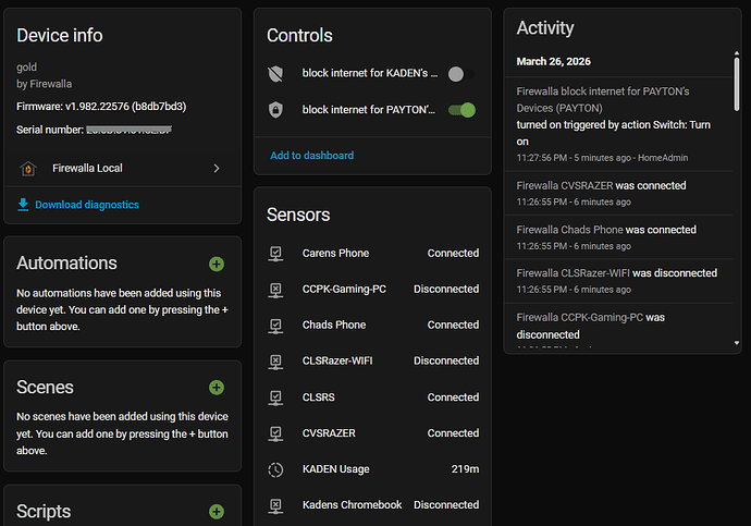

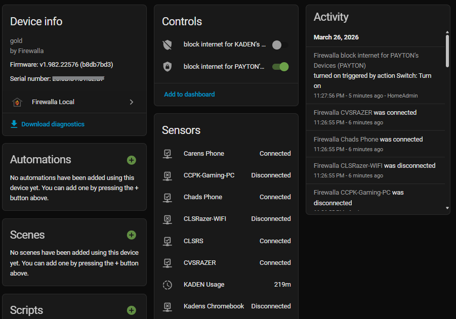

Today I’m releasing Firewalla Local (v1.0.0). It’s available via HACS and built from the ground up to meet Home Assistant’s “Platinum” quality standards with a 100% local data plane.
What it enables:
  • Rule-Backed Switches: Expose your most-used rules (Internet Block, Social, Gaming, etc.) as simple switches with Optimistic UI—meaning your HA dashboard updates immediately with zero latency.
  • Watched-User & Device Monitoring: Select specific household users or endpoints to track daily usage minutes, active apps, and connectivity, backed by the proven local payload.
  • Timed Pauses: Use native pause_rule and resume_rule services in your automations (e.g., “Give the kids 30 more minutes of gaming”).
  • Appliance Monitoring: Track system load, memory, disk usage, WAN IP details, and the latest successful Speed Test result natively in HA.
Security & Architecture:
This isn’t just a wrapper for a few scripts. It uses the official “Additional Pairing” protocol to securely retrieve the router’s local cryptographic bundle. After a one-time cloud-brokered pairing (identical to adding a second phone via the Firewalla app), all communication is 100% local, bypassing the cloud entirely. Note on Access: Because the integration communicates directly with the local hardware using this shared symmetric key, “unpairing” the device in your Firewalla app only removes the cloud association. To fully remove access, you simply delete the integration directly within Home Assistant to wipe the locally stored keys.
Hardware Testing:
I developed and actively run this on a Firewalla Gold. It should be fully compatible with the Purple, Gold Pro, and any other series running the Firewalla Box software that supports the local API. If you have one of those units, I’d love for you to install it and drop a note in the GitHub Discussions so I can update the supported hardware list.
Confirmed working models from user reports:
  • Gold
  • Gold Plus
  • Purple

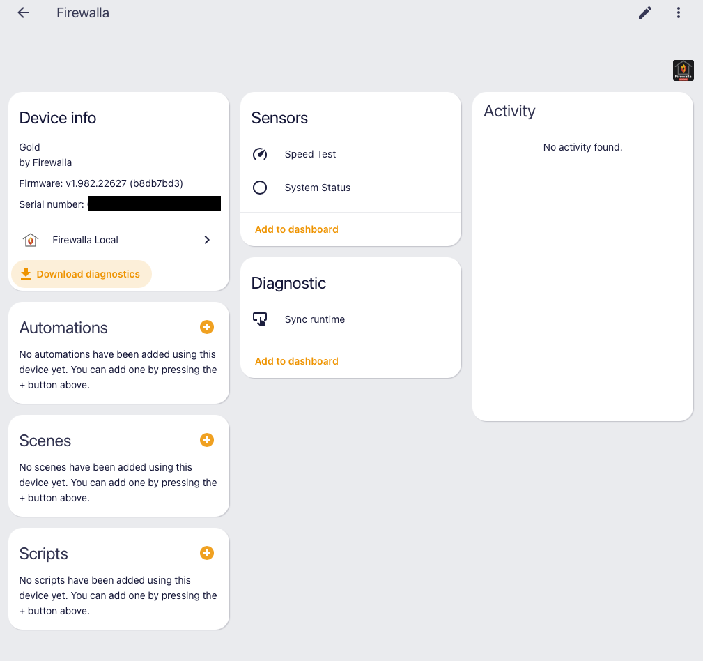

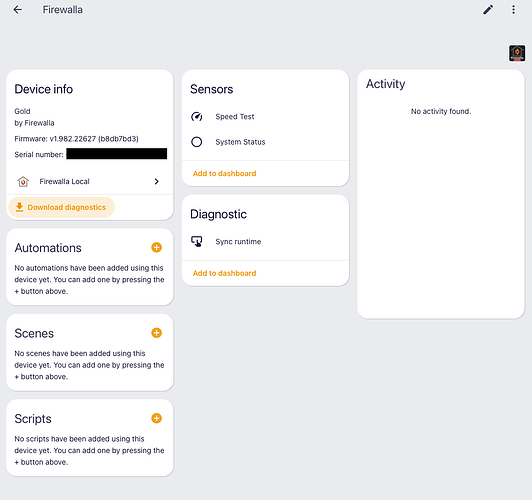

Very cool integration, Chad - I’m super excited to get this up and running on my home network. Have installed following instructions, but don’t see anything useful populated…? I’ve a Firewalla Gold Plus.
Set up the integration around 24 hours before screenshot (thought it might poll after a while). What am I missing?

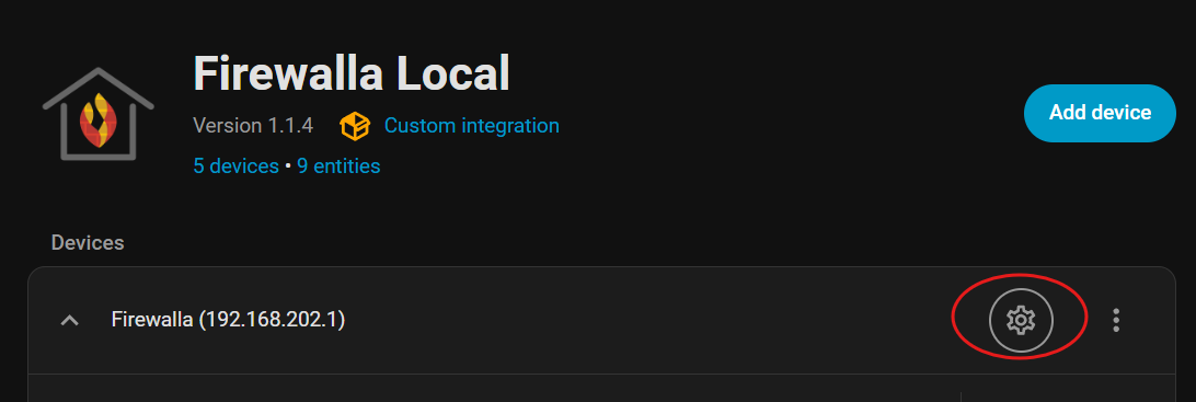

What you are seeing is totally normal. The integration is built with an ‘opt-in’ model so it doesn’t instantly flood your Home Assistant with hundreds of firewall rules and devices.
By default, it only exposes a few basic entities like System Status (which holds a lot of good data in its attributes). For everything else—like specific rules you want to toggle—you just need to go into the integration’s Configure menu and select the exact items you want to bring in and control.
More detail about the different item types and configurations can be found in the User Guide.

Aaaaaahhhhh! Well guess who was too excited to install this to read ALL the documentation. :man_facepalming:
Thanks for the reply. And all the amazing work in building this integration.

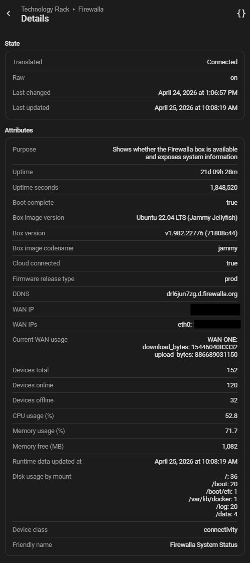

:light_bulb: Tip: Don’t miss the hidden data in your Firewalla Local attributes!
I’ve gotten a few questions recently from folks asking if I plan to add sensors for things like CPU usage, specific app tracking, or speed test latency.
The good news is: that data is already there! To keep your Home Assistant instance from getting completely cluttered with hundreds of individual sensors, I designed the integration to pack as much related data as possible into the Attributes of the default entities.
If you click on your Firewalla entities and look at the details, you’ll find a lot of rich data. Here are a few examples of what is running under the hood:

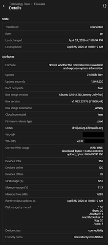

1. System Status is more than just “Connected”
The System Status entity state might just say “Connected,” but if you look at the attributes, it acts as a full dashboard. It tracks your exact device counts (online vs. offline), live CPU and Memory usage, Disk usage by mount, and even your current WAN download/upload bytes.

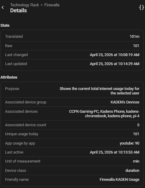

2. User & Device Usage breaks down the details
If you look at a User Usage entity (like the “KADEN Usage” example in the screenshots), the main state shows the total internet time. But the attributes break that down further, showing you exactly which devices are associated with that profile, the last active time, and even an App usage by app breakdown (e.g., seeing exactly how much of that time was spent on YouTube, Instagram, etc).

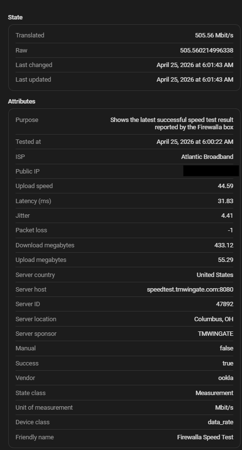

3. Speed Test gives you the full diagnostic
The main state gives you your translated download speed, but the attributes hold your upload speed, latency, jitter, packet loss, and the specific ISP and server data from the test.
How to use this on your dashboards
If you want to pull any of this specific data out to display on a Mushroom card, an entity card, or use it in an automation, you can easily grab it using a template.
For example, to display the CPU Usage from the system status attribute, you would just use a template like this:
{{ state_attr('binary_sensor.firewalla_system_status', 'cpu_usage') }}
Or to pull a specific app’s usage time from a user profile:
{{ state_attr('sensor.firewalla_kaden_usage', 'app_usage_by_app').youtube | default(0) }}
Take a look through the attributes on your setup—you might find exactly what you’ve been looking to automate!
