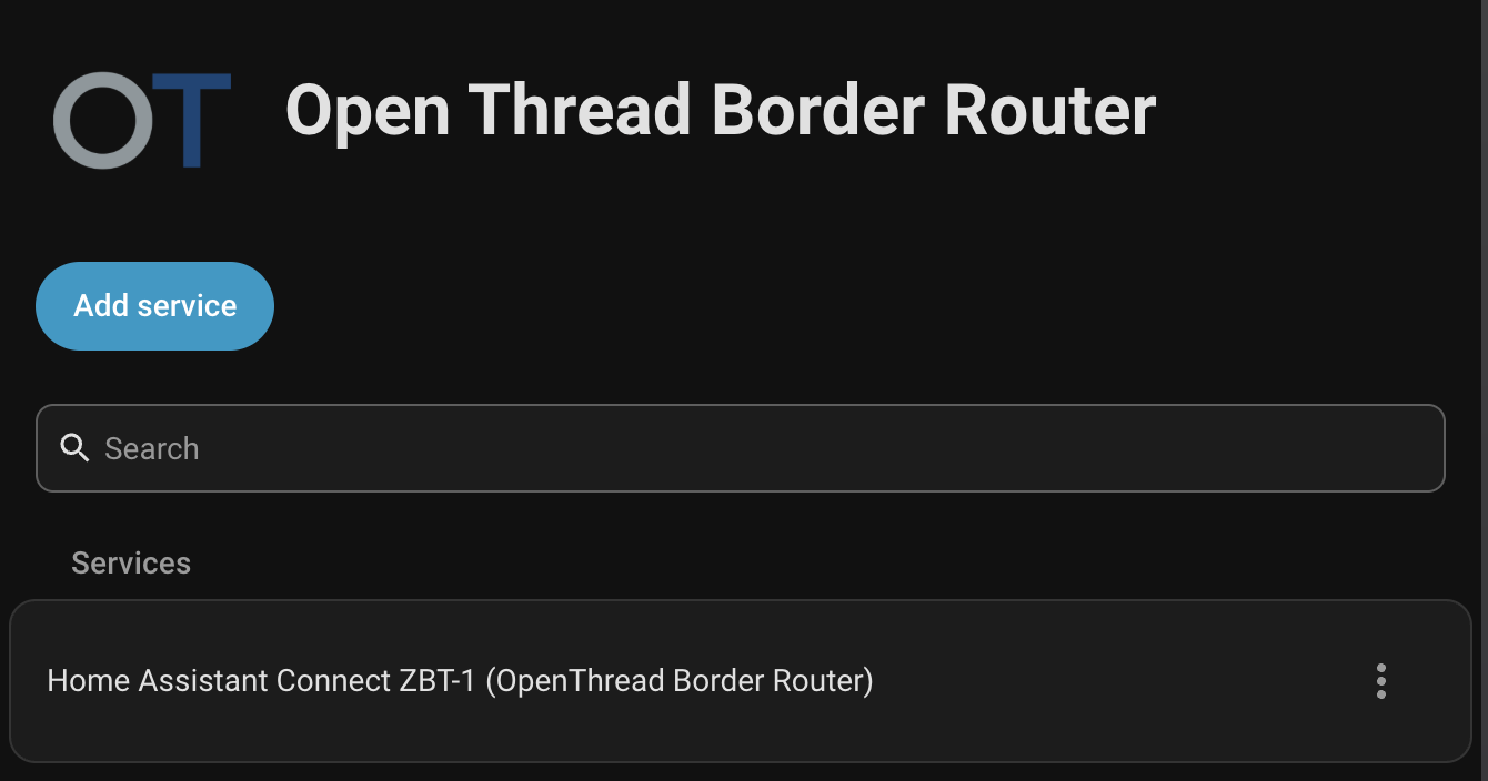

I have a ZBT-1 with the thread firmware, and it shows up as an OTBR in Home Assistant:

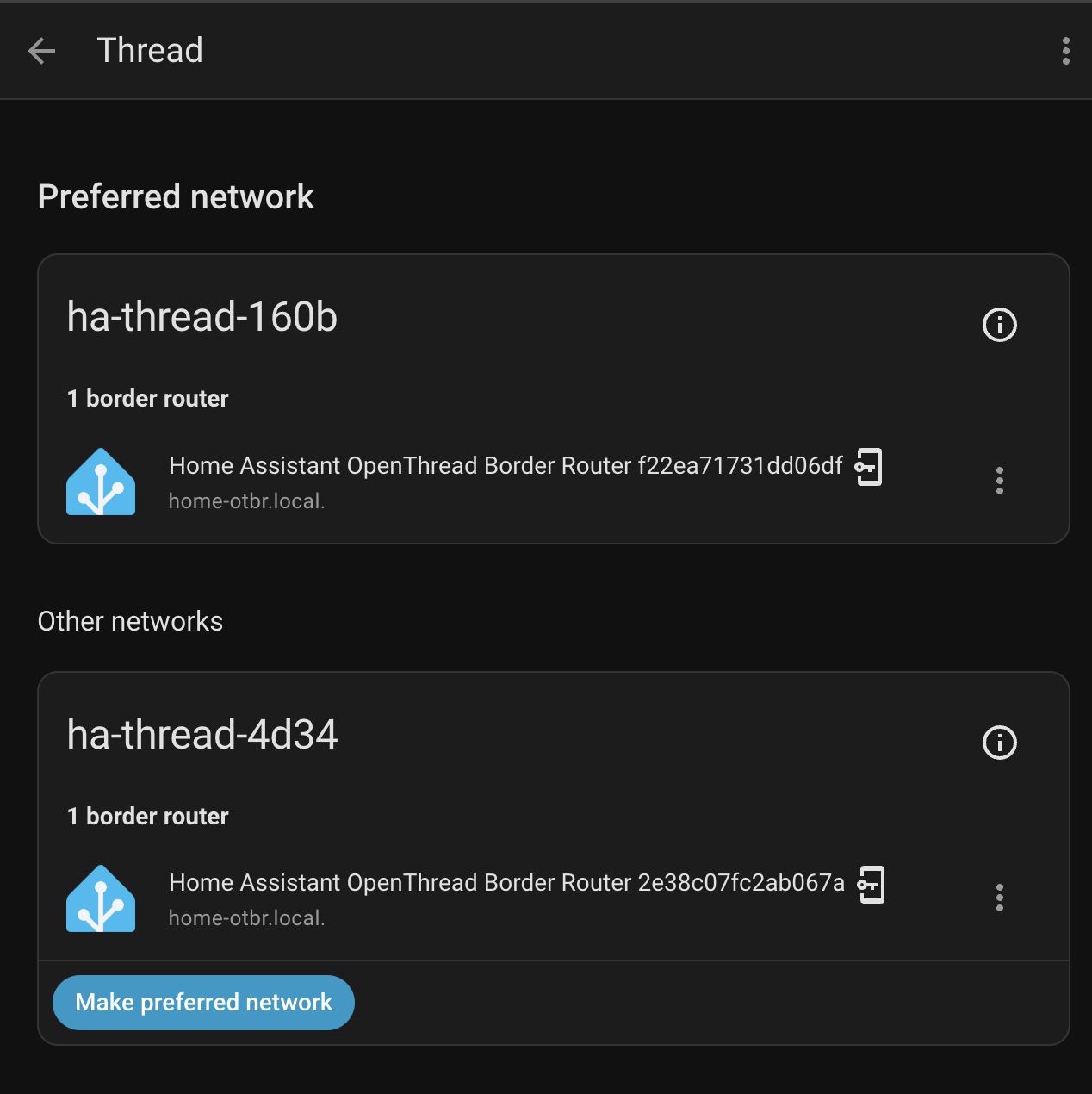

For some reason that I dont fully grok, there are two thread networks, and I have no ability to delete the one that's not preferred.

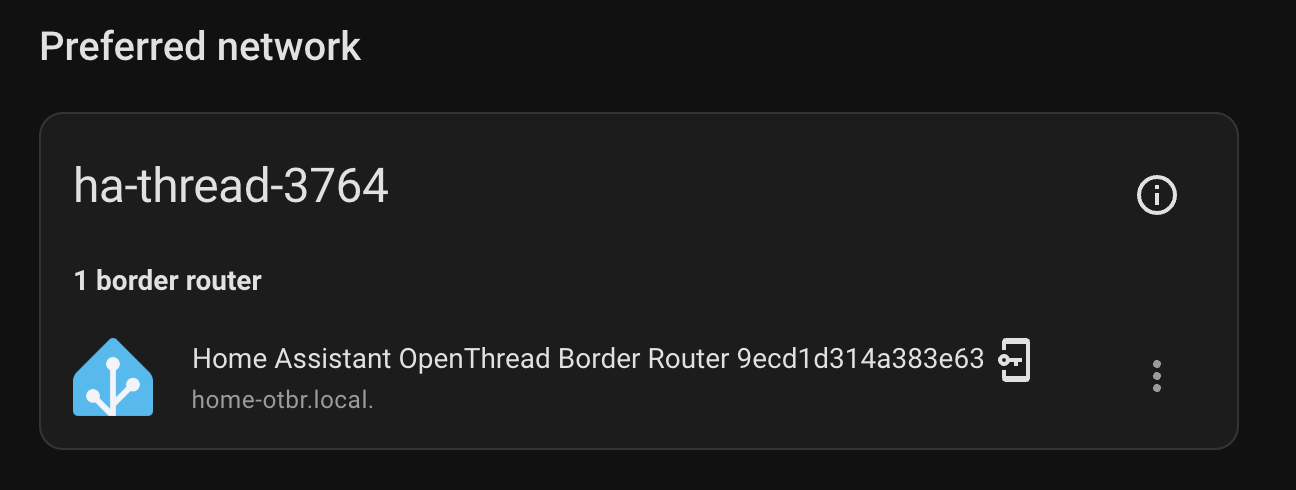

I was able to get one thread network with an assigned border router (checked via both Settings > Integrations > OTBR, and Settings > Integrations > Matter > Thread settings).
Still, commissioning the device fails with the error that I need a Thread border router.

After I completely re-flashed the ZBT-1 and re-set up everything, a new network appeared in the Thread list, with an associated key, and with the "key in mobile" icon.
But still, the comissioning flow ends up in telling me I need to add a border router.
The "Send credentials to home assistant" button tells me "You don't have any credentials to import". That sounds like, no I dont have anything on my phone related to thread or a network?
