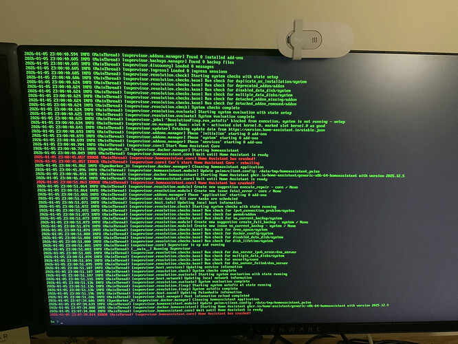

All went well until I started up the mini PC with HAOS installed (only usb connected was my keyboard, wired connection to internet), I got the CLI on the screen
BUT whenever I tried to reach the HA page, it would not work (I tried both the homeassistant.local & IP addresses)
I dig a little bit more an now run in circles between errors:
When using the « core restart » command:
Processing… Done
Error: unknown error, see Supervisor logs (check with ‘ha supervisor logs’)
When using the « core rebuild » command:
I get the following error: cannot import ‘AwesomeVersion’ from ‘awesomeversion’ (/usr/local/lib/python3.13/site-packages/awesomeversion/init.py)
When using the « supervisor logs » command:
I get multiple errors:
Error (mainthread) [supervisor.homeassistant.core] Home assistant has crashed!
Error (mainthread) [supervisor.core] can’t start home assistant core - rebuilding
What should I do to be able to reach the HA page and start the configuration?
I am a newbie, so please let me know if you need more info in order to help me out.
Thanks in advance

Hi, thanks for the help. Actually I solved the issue by doing everything again and now it is working fine.
The only thing I did differently was to download ubuntu and flash the usb flash drive from a Windows environment instead of my very old Mac.
Clarification as well: I did install HAOS via ubuntu which is exactly what is described in the methodology in your link (that I had followed in the first place).
