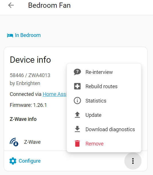

If you want to try and use the previously managed devices by that controller you can go to each “Node” device and do a “re-interview”. That will query the device and do the same process as if you had included it fresh into HA to begin with. Of course for any sleepy devices (battery powered) you’ll need to wake them up after hitting re-interview.
