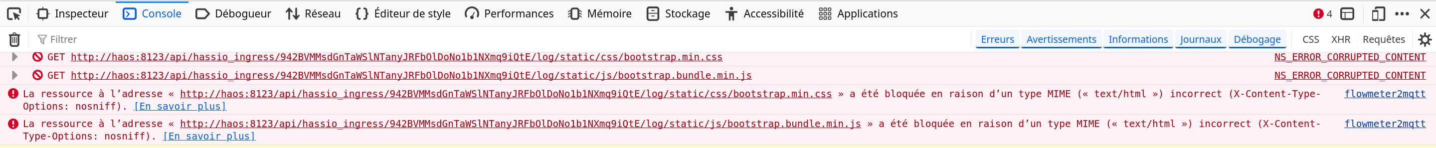

2025-12-27 13:51:05 local-serviceslog werkzeug[100] INFO 172.30.32.2 - - [27/Dec/2025 13:51:05] "GET /log/flowmeter2mqtt HTTP/1.1" 200 -
2025-12-27 13:51:05 local-serviceslog werkzeug[100] INFO 172.30.32.2 - - [27/Dec/2025 13:51:05] "GET /log/static/css/bootstrap.min.css HTTP/1.1" 404 -
2025-12-27 13:51:05 local-serviceslog werkzeug[100] INFO 172.30.32.2 - - [27/Dec/2025 13:51:05] "GET /log/static/js/bootstrap.bundle.min.js HTTP/1.1" 404 -
Log dev Firefox:
I have tried several solutions, such as using url_for to load the js/css files as follows:
<script src="{{url_for(‘static’, filename=‘bootstrap.bundle.min.js’)}}"></script>
or modified the static file directory in the code like this:
app = Flask(__name__, static_url_path="/", static_folder=‘./’)
But I still have the problem.
