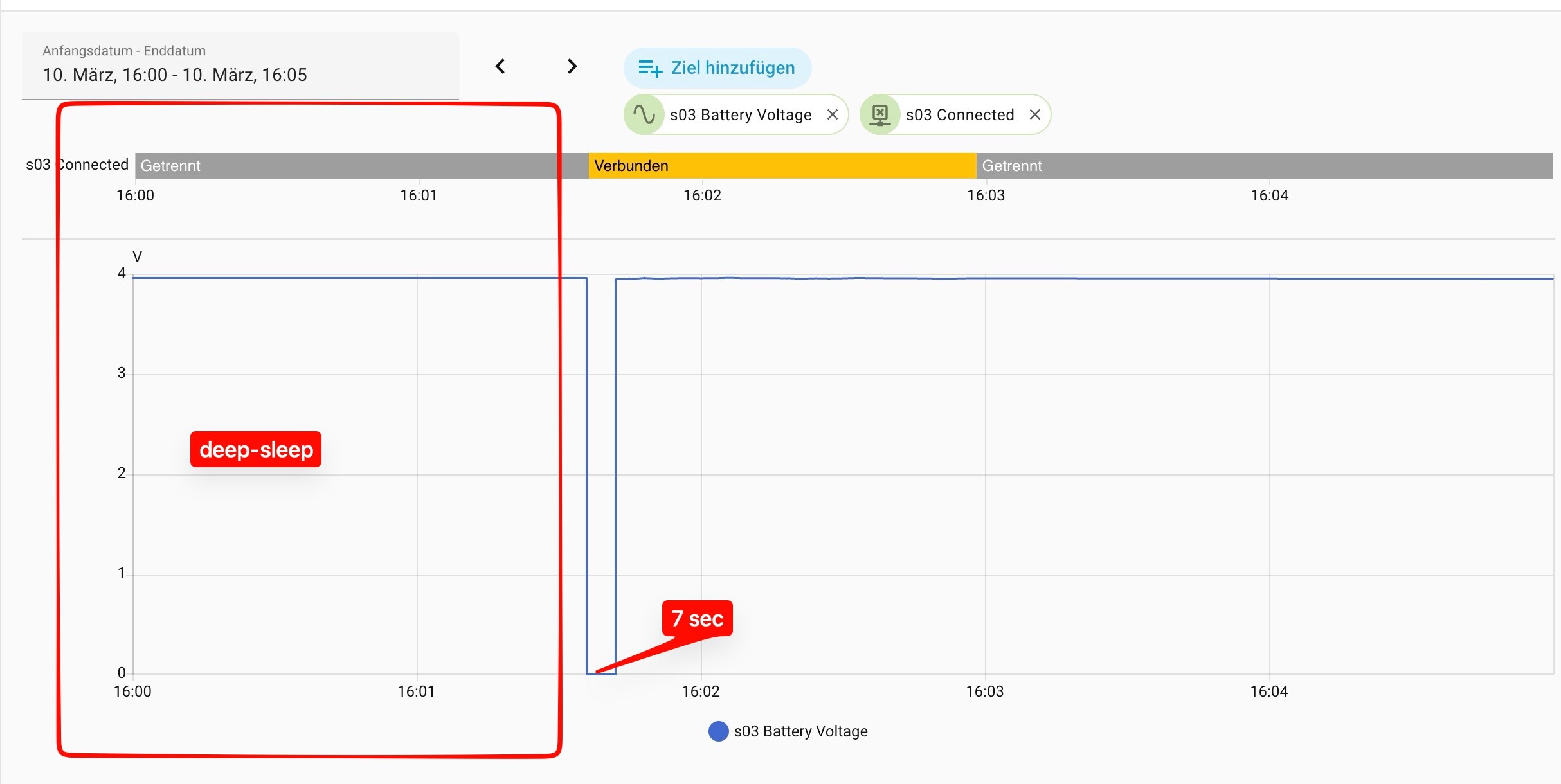

I have an E1001 terminal from seeed, and want to show the user the voltage percentage directly after the E1001 coming from deep sleep and I want the Voltage itself in HomeAssistant in the statistics. The view for the user on the ePaper works.
For this reason I put the sensor measurement in the on_boot, wait for the API beeing there and than continue with my program.
My problem is, that on every wakeup after deep sleep the first value HomeAssistant gets is “0” (zero), which “kills” the nicely shown graphs.
See here one cutout of my statistic data:

I do not understand why this
lambda: 'return id(${rmgr_device_name}_battery_voltage).has_state() && id(${rmgr_device_name}_battery_voltage).state > 2.0;'
is still delivering values below 2 to HomeAssiant.
Does anyone have any idea what I am doing wrong?

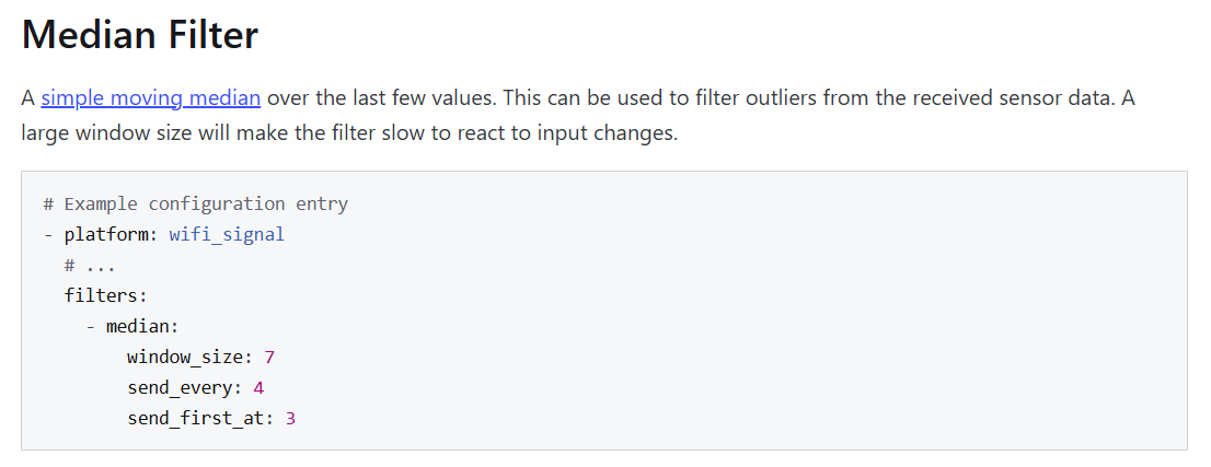

But sensors are initialized way before API connects and HA gets the value when API connects. Your automations after API are not relevant, make sure you have valid sensor readings before instead.
On ESPhome you can filter out the first or first few readings to avoid this
thanks a bunch for the idea. I “somehow” got it to work. I say “somehow”, because I have no real clue why. This works as a battery Voltage that has “smooth” Voltage, not “0” drops, and “seems” to work. I now see graphs I want to see and they show a value, that I “believe”. All for E1001 from seeed, I do not know where it might work for as well.

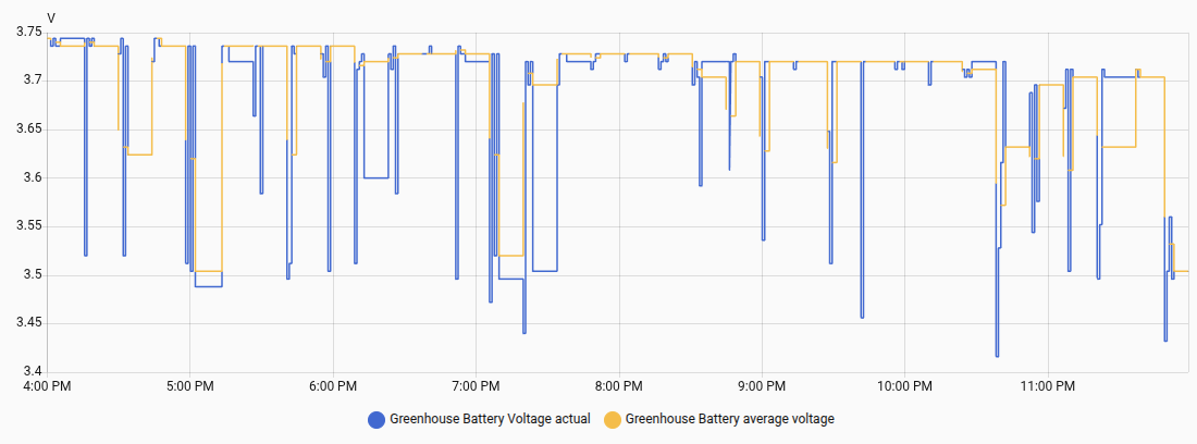

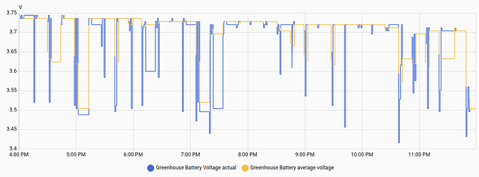

FWIW, I am using an INA3221 to do the measuring, but I have also noticed that my first LiPo battery voltage reading after deep_sleep is most often low - sometimes by as much as 0.3V. This doesn’t sound like much, but when it falsely triggers my low_battery_panic automation at 3.6V instead of 3.3V … :slightly_frowning_face:
I also have used filters to skip_initial and median to average out the rest of the readings. Still not ideal, but much better.

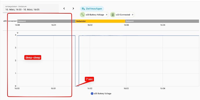

back again with my sensor drop to “0”. Now if the ESP connects I see an “unknown” shortly in the device overview. Like half a second “old value”-“unknown”-“old-value”
My guess is, that the HomeAssistant/ESP API is getting something wrong, but I have no clue if I am right.
I also “assume” that this happens since one of the new updates. I am both with ESPHome and HomeAssistand on newest. But this is even a wilder guess.
any ideas how to debug this closer?
Or can I “somehow” in HomeAssistant “deny” values for a filter, that are unkown?
