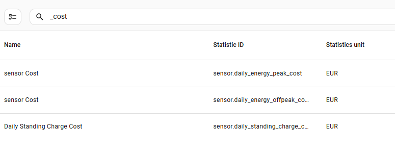

There is a separate _cost statistic you should be able to find from developer-tools/statistics that will allow you to adjust sum on the total cost.
Can’t find it
Only see these 3 there:
Oh right I think for export it’s _compensation
Got it fixed, a lot of manual editing of statistics table, this should not be this hard, should have been a feature by now.
