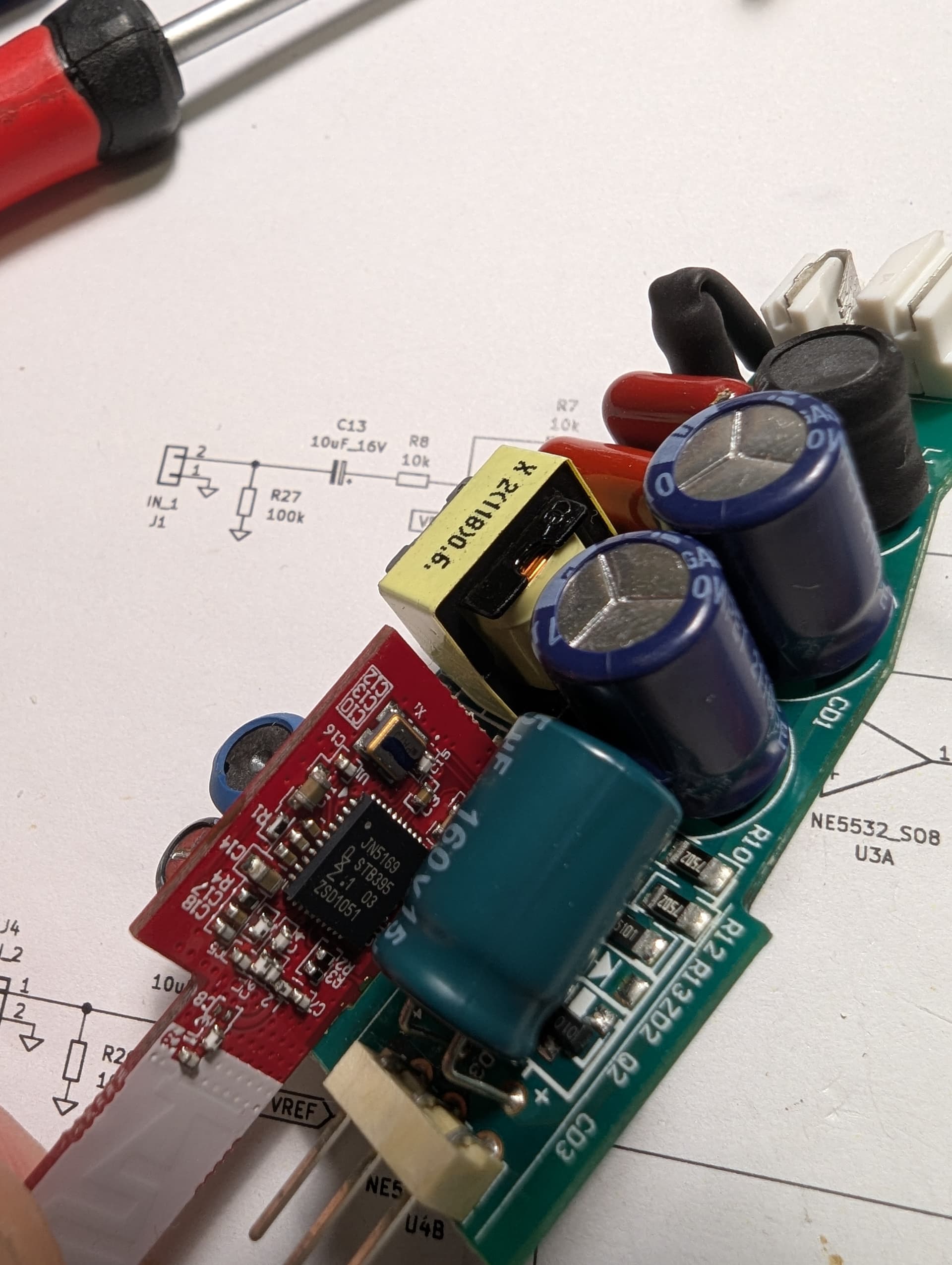

I have 3 Flair 10011723 smart bulbs (manufactured for Hornbach) that have misteriously stopped working. I’ve used them with Home Assistant via zigbee2mqtt, paired with a Sonoff E dongle, and put them to storage for a few months during renovation. When I plugged them back in, nothing, no activity, couldn’t “reset” them or get them into pairing mode.
So I dismantled the units and found a JN5169 controller. I checked the power supply, which was fine, and the reset line, which was high. There was no activity on the PWM pins. After soldering some wires trying to probe the MCU, one of the units unexpectedly came back to life. Not the other ones though.
I guess the next option would be to see if there’s any activity on the UART port.
Has anyone had any issues with JN5169 based devices?

I actually discovered that the main bulk capacitor for the 3.3V line went bad, and so the MCU went into some kind of locked state. It probably uses that voltage to decide how to go into pairing mode. I replaced the capacitor and reset the MCU by shorting the reset pin to GND.
