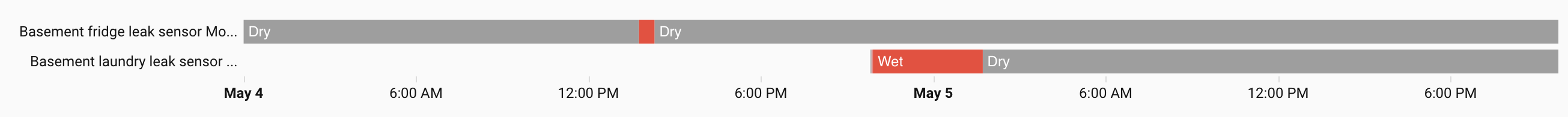

However, it looks like some history was lost as I only saw data back a few minutes before it stabilized:

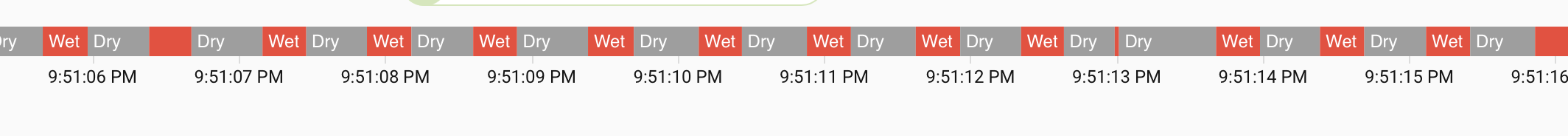

Zoomed in:
Compared with some other sensors which don’t exhibit the flapping, and they do show more historical data:
These sensors were installed around the same time. Does this mean I lost some data because of the flapping sensor — like there is a limit on the number of state changes that is stored?
