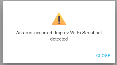

i tried do install my esp32 via web and get the following error.
than i tried to install it via usb and no errors but i have no connection no wifi no fallback etc any ideas?

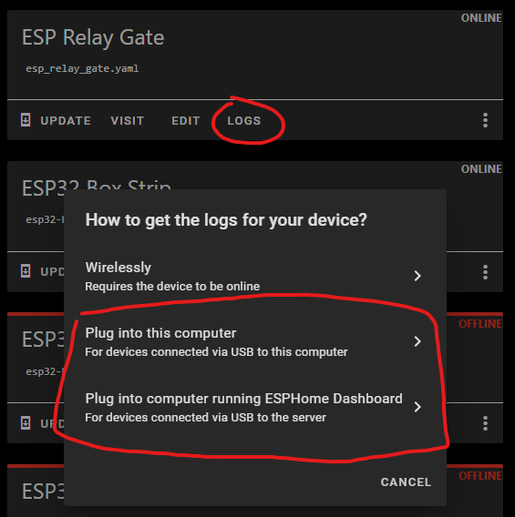

Check the logs of the ESP through USB
thanks guys, i found now the problem :slight_smile:
After the Web-Flash i need to reboot the device and than i can set the wifi setting succesfully
