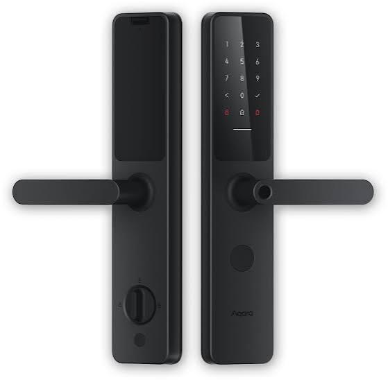

After a long journey of searching for a smart lock that integrates smoothly with Home Assistant, I finally settled on the Aqara A100 Zigbee international version. I installed two of them at my villa and wanted to share my experience.

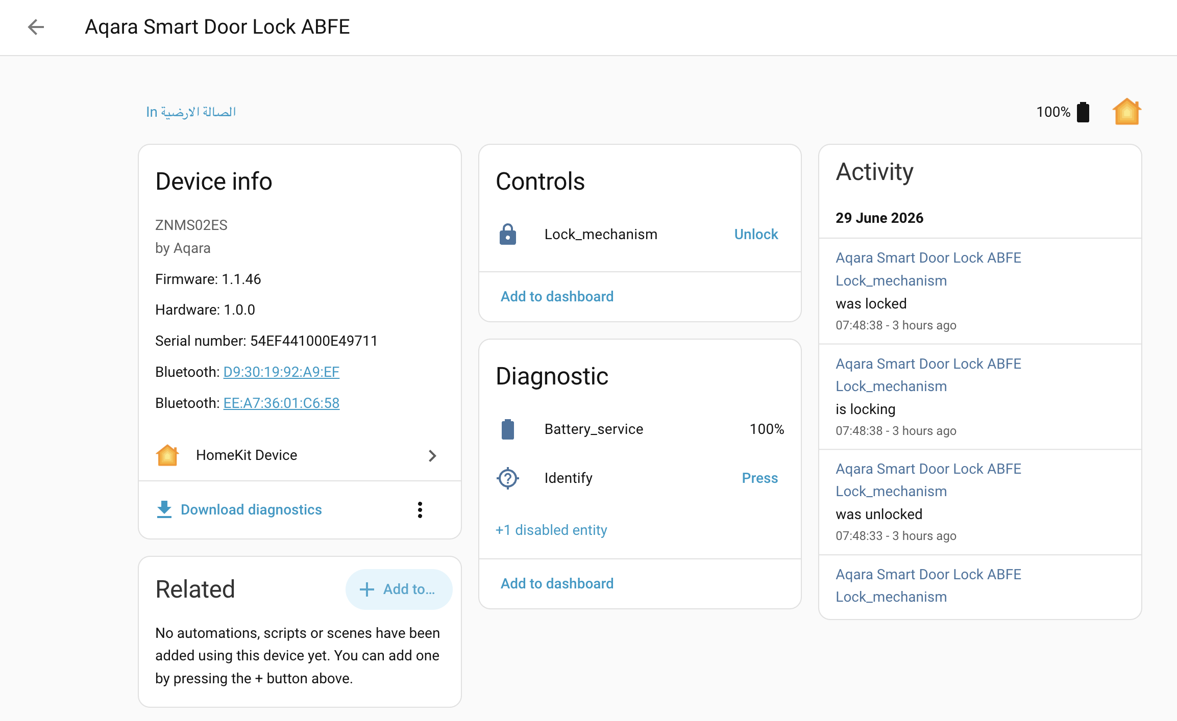

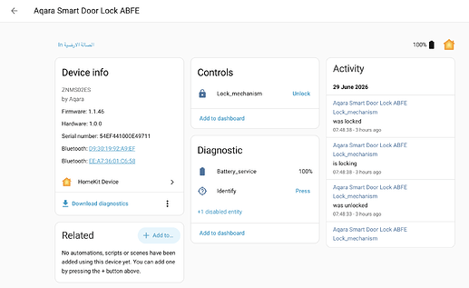

Exposed Entities & Controls
Through the HomeKit integration, the lock exposes exactly what you need. Here is a look at the device info and the controls exposed to HA (Lock mechanism, Battery service, and Identify):

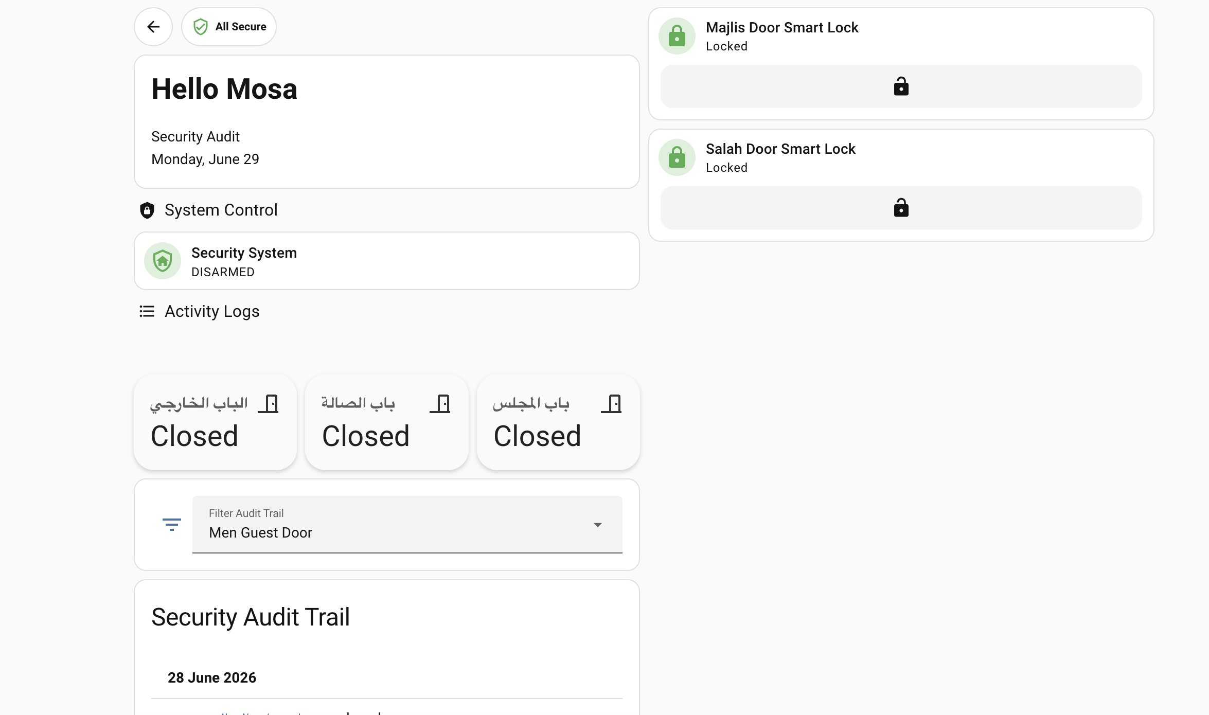

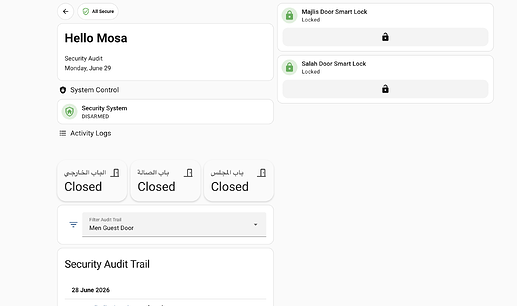

Dashboard Results
Now, I am able to seamlessly lock and unlock both doors directly from my Home Assistant dashboard. Here’s a peek at how it looks integrated into my security setup:

Are the deadbolts also locked an unlocked remotely and from the door exterior? Or just the small door latch?

furthermore, yes
yes.. i am able to unlock my doors from homeassiatnt dashboard from anywhere.
