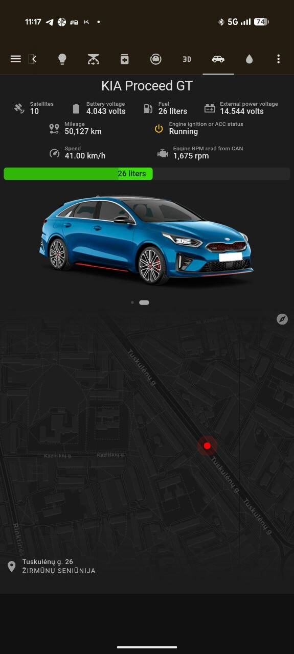

What you get
Per device:
  • device_tracker - location on the map
  • Sensors for speed, altitude, direction, satellites, battery voltage
  • binary_sensor online/offline status
  • Auto-discovery: every telemetry parameter the device reports becomes a sensor or binary_sensor with proper device_class and units. Common ones (fuel, ignition, external power) enabled by default; the rest added disabled - enable what you need
Account counters (new in 0.6.0):
With a Master-level token, add "Account counters" to your connection - ~140 sensors for flespi platform usage: API calls, MQTT messages/sessions, device/channel/stream counts, storage, traffic, plan limits. Push-fed via retained MQTT, no polling.
Works great with Vehicle Status Card for a car-dashboard-style UI.
