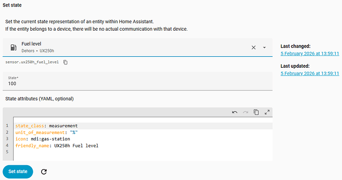

But I’m doing my best, I swear. From your message (and the fact the code doesn’t work :grimacing:), I understand I could do that only if my sensor had an attribute on top of its state, which isn’t the case:
I believe I cannot add an attribute to an entity created by an integration, so I shall create a custom sensor with a “liters_to_full” attribute, correct?
