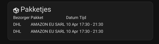

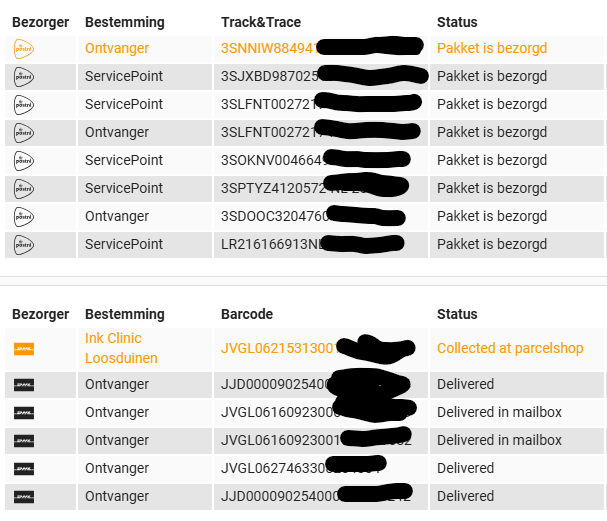

How can I combine/merge/concatenate 2 tables into 1 ?
I use this:
type: conditional
conditions:
  - condition: or
    conditions:
      - condition: numeric_state
        entity: sensor.postnl_delivery
        above: 0
        entity: sensor.dhl_packages
        above: 0
card:
  type: markdown
  card_mod:
    style:
      ha-markdown$: |
        table {
          width: 100%;
        thead {
          font-weight: bold;
        ha-icon {
             --icon-primary-color: #44739e;
  content: |
    <header style="display: flex; align-items: flex-end;">
      <ha-icon icon="mdi:package-variant" style="vertical-align: bottom;"></ha-icon>
      <font size="5">Pakketjes</font>
    </header>
    <table>
    <thead>
      <tr>
        <td>Bezorger</td>
        <td>Pakket</td>
        <td>Datum</td>
        <td>Tijd</td>
      </tr>
    </thead>
    <tbody>
    {% for package in state_attr('sensor.postnl_delivery', 'enroute') %}
      {% if package.planned_date is not none and package.planned_from is defined and package.planned_to is defined %}
      <tr>
        <td>PostNL</td>
        <td>{{ package.name }}</td>
        <td>{{ as_timestamp(package.planned_date) | timestamp_custom('%-d %b') }}</td>
        <td>{{ as_timestamp(package.planned_from) | timestamp_custom('%H:%M') }} - {{ as_timestamp(package.planned_to) | timestamp_custom('%H:%M') }}</td>
      </tr>
      {% endif %}
    {% endfor %}
    {% for package in state_attr('sensor.dhl_packages', 'parcels') %}
      {% if package.receivingTimeIndication is not none and package.receivingTimeIndication.start is defined and package.receivingTimeIndication.end is defined %}
      <tr>
        <td>DHL</td>
        <td>{{ package.sender.name if package.sender is defined else 'Unknown' }}</td>
        <td>{{ as_timestamp(package.receivingTimeIndication.start) | timestamp_custom('%-d %b') }}</td>
        <td>{{ as_timestamp(package.receivingTimeIndication.start) | timestamp_custom('%H:%M') }} - {{ as_timestamp(package.receivingTimeIndication.end) | timestamp_custom('%H:%M') }}</td>
      </tr>
      {% endif %}
    {% endfor %}
    </tbody>
    </table>
And it looks like this:
Only this time 2 packages from DHL are comming.
If something comming from postnl it will add to the list
Not related to flex-table-card, you are using Markdown.
Oh, sorry, you posted a possible solution, my fault.

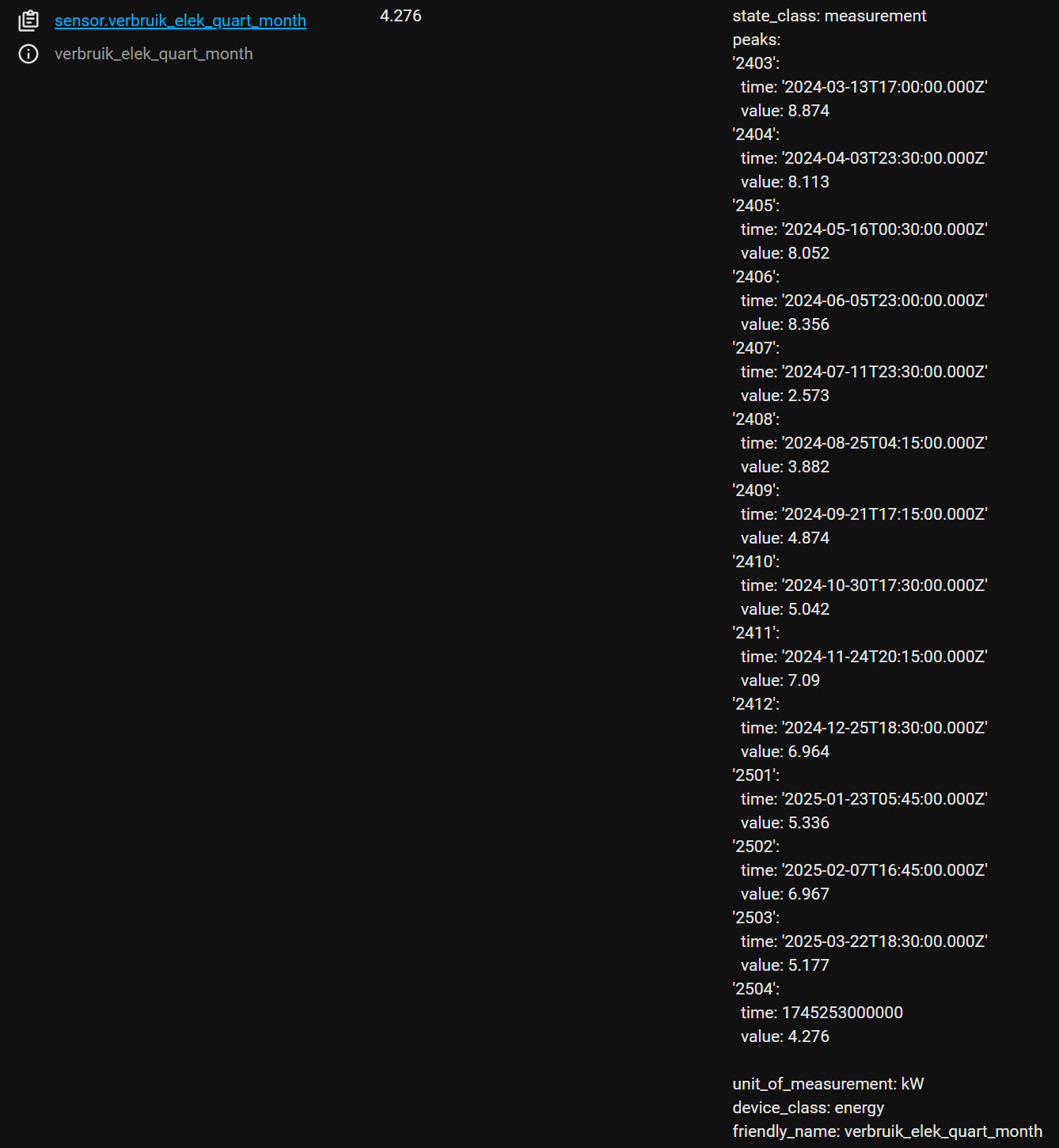

Hi I have a sensor with an attribute containing a dictionary with for the current and the past 12 months the peak consumption with its timestamp (coming from a Belgian digital meter). I want to show these in a table.
With a markdown card this is fairly easy:
type: markdown
title: Peaks
content: |-
  <table width="100%">
    <tr>
      <th align="center" width="20%">Month</th>
      <th align="center" width="30%">Peak</th>
      <th align="center" width="50%">Time</th>
    </tr>
    {% for key, value in state_attr('sensor.verbruik_elek_quart_month', 'peaks').items() %}
    <tr>
      <td align="center">{{ key }}</td>
      <td align="center">{{ value.value }}</td>
      <td align="center">{{ value.time }}</td>
    </tr>
    {% endfor %}
  </table>
But I cannot figure it out to get this in a flex-table like this:
Month Peak Time
2403 8.874 13th 17:00:00
2404 8.113 03th 23:30:00
2405 8.052 16th 00:30:00
Data is looking like this (a dictionary of dictionaries):
peaks: >
'2403': {'time': '2024-03-13T17:00:00.000Z', 'value': 8.874},
'2404': {'time': '2024-04-03T23:30:00.000Z', 'value': 8.113},
'2405': {'time': '2024-05-16T00:30:00.000Z', 'value': 8.052},
'2406': {'time': '2024-06-05T23:00:00.000Z', 'value': 8.356},
'2503': {'time': '2025-03-22T18:30:00.000Z', 'value': 5.177}}
I tried like below (proposed by CoPilot :slight_smile: ), but I don’t manage to get the data in the dictionary.
type: custom:flex-table-card
title: Piekverbruiken
entities:
  include: sensor.verbruik_elek_quart_month
columns:
  - name: Month
    data: peaks
    modify: x
  - name: Peak
    data: peaks
    modify: x.value
  - name: Time
    data: peaks
    modify: x.time
gives:
Month Peak Time
[object Object] undefinedundefinedundefined undefinedundefinedundefined
I would appreciate any help.
Posting a screenshot from Dev tools - State for this sensor may help users to understand a structure of the sensor.
Below is the screenshot.
I think you also can see the structure for the for loop in the markdown example (using the same sensor)
  <tr>
  </tr>
  {% endfor %}
