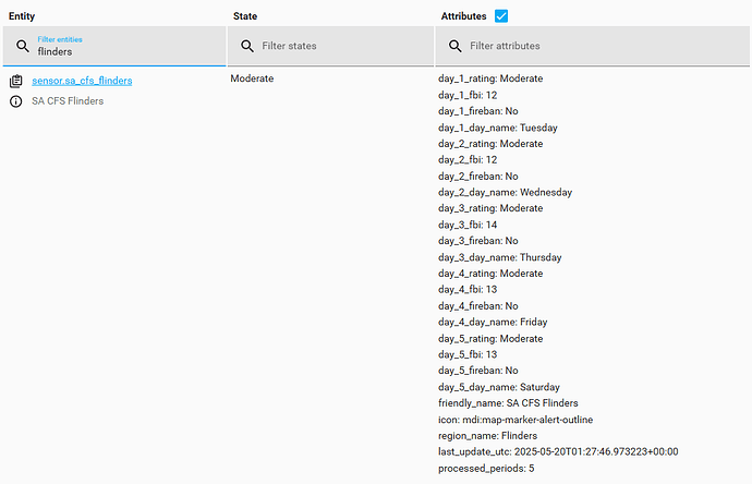

Not entirely sure what you mean - but this is one of the sensors returned:
I think in the context of the friendly_name, it comes back as text - however now under 2025.5.2 it works fine, so no idea.
I was playing around and have since added region_name to the attributes generated.

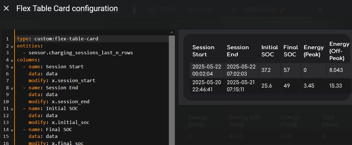

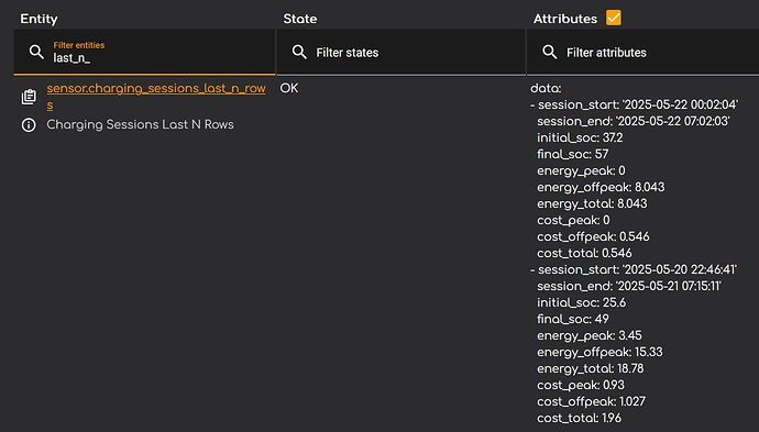

Hi @Ildar_Gabdullin and @Biscuit
I followed your approach of storing an array inside a single attribute of one sensor, in order to display some JSON data. It works nicely. Here is my sensor:
and here is my flex-table configuration:
However, I am not able to format the numbers in the columns. For example, do you know if there’s a simple way to format one of the columns to 2 decimal places? I have tried using something like this, but it’s not outputting anything:

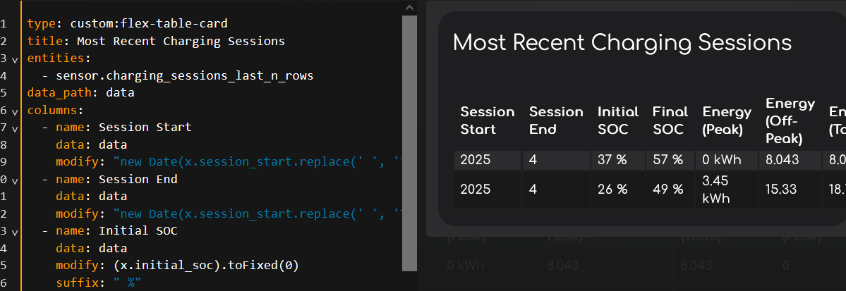

Thanks for this - you are right, this works:
type: custom:flex-table-card
title: Most Recent Charging Sessions
entities:
  - sensor.charging_sessions_last_n_rows
data_path: data
columns:
  - name: Session Start
    data: data
    modify: "new Date(x.session_start.replace(' ', 'T')).getFullYear();"
  - name: Session End
    data: data
    modify: "new Date(x.session_start.replace(' ', 'T')).getMonth();"
  - name: Initial SOC
    data: data
    modify: (x.initial_soc).toFixed(0)
    suffix: " %"
For some reason, we don’t use the “return” syntax, like with regular javascript expressions…

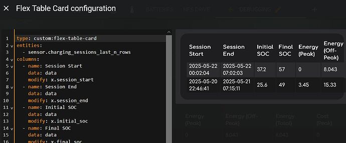

For example, I have my first two columns which contain strings for initial time and final time. I would like a new column which displays the difference between them in the format like “7h 8m”. But something like this results in an error:
title: Charging Sessions
entities:
columns:
    data: data
    modify: x.session_start
  - name: Session End
    data: data
    modify: x.session_end
  - name: Hours
    data: data
    modify: >
      const start = new Date(x.session_start.replace(' ', 'T'));
      const end = new Date(x.session_end.replace(' ', 'T'));
      const diffInMinutes = Math.round((end - start) / 60000);
      const hours = Math.floor(diffInMinutes / 60);
      const minutes = diffInMinutes % 60;
      return `${hours}h ${minutes}m`;
I can’t see a way to do it…
    modify: |-
      const p=(new Date(x.upto) - new Date(x.from))/60000;
      const hours = Math.floor(p / 60);
      const minutes = p % 60;
It is not a function, it uses eval, and the end result is the last line of JS
Change the x.upto etc to suit your needs

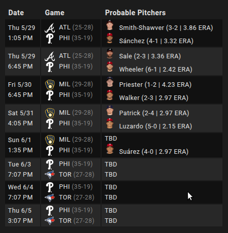

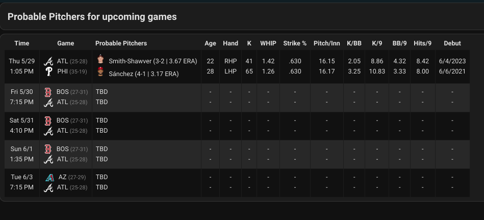

Hi all,
I have a working table that pulls in the upcoming MLB games and shows the starting pitcher match-ups. It works great for days where only one game is being played. On days where there is a double header (like today), I am only retrieving the first game.
What I’m trying to solve is showing both games of a single day when a double header exists.
My dashboard code is only grabbing the x.games[0] location, but I can’t seem to figure out how to make it work any other way.
Any thoughts on how to show both games of a double header?

Here’s my flex-table-card result. I’m not using all the data you are, but if you use games_list for your data, you should just need to remove games[0]. from your modify code.
title: Phillies Upcoming Games
entities:
  include: sensor.mlb_phillies_schedule
columns:
  - name: Date
    data: games_list
    modify: |-
      new Date(x.gameDate).toLocaleDateString('en-US', {
          weekday: 'short',
          month: 'numeric',
          day: 'numeric'
      }).replace(',', '') + '<br>' + new
      Date(x.gameDate).toLocaleTimeString('en-US', {
          hour: 'numeric',
          minute: '2-digit',
          hour12: true,
          timeZone: 'America/New_York'
  - name: Game
    data: games_list
    modify: |-
      `${x.status.statusCode === 'P' || x.status.statusCode === 'S' ||
      x.status.statusCode === 'I' ?
          `<img src="https://www.mlbstatic.com/team-logos/team-cap-on-dark/${x.teams.away?.team?.id}.svg"
           style="width: 20px; height: 20px; vertical-align: middle; margin-right: 5px;">
           ${x.teams.away?.team?.abbreviation || 'N/A'}
           <span style="font-size: 12px; color: gray;">
             (${x.teams.away?.leagueRecord?.wins || '0'}-${x.teams.away?.leagueRecord?.losses || '0'})
           </span><br>
           <img src="https://www.mlbstatic.com/team-logos/team-cap-on-dark/${x.teams.home?.team?.id}.svg"
           ${x.teams.home?.team?.abbreviation || 'N/A'}
             (${x.teams.home?.leagueRecord?.wins || '0'}-${x.teams.home?.leagueRecord?.losses || '0'})
           </span>`
  - name: Probable Pitchers
    data: games_list
    modify: |-
      `${x.teams.away.probablePitcher ?
        `<a href="https://www.mlb.com/player/${x.teams.away.probablePitcher.nameSlug}" target="_blank">
          <img src="https://midfield.mlbstatic.com/v1/people/${x.teams.away.probablePitcher.id}/silo/60?zoom=1.2"
               style="width:20px; height:20px; border-radius:50%; margin-right:5px;"></a>`
        ${x.teams.away.probablePitcher ? x.teams.away.probablePitcher.lastName : 'TBD'}
        ${x.teams.away.probablePitcher && x.teams.away.probablePitcher.stats && x.teams.away.probablePitcher.stats[3] ?
        '(' + x.teams.away.probablePitcher.stats[3].stats.summary + ')' : ''} <br>
       ${x.teams.home.probablePitcher ?
        `<a href="https://www.mlb.com/player/${x.teams.home.probablePitcher.nameSlug}" target="_blank">
          <img src="https://midfield.mlbstatic.com/v1/people/${x.teams.home.probablePitcher.id}/silo/60?zoom=1.2"
        ${x.teams.home.probablePitcher ? x.teams.home.probablePitcher.lastName : 'TBD'}
        ${x.teams.home.probablePitcher && x.teams.home.probablePitcher.stats && x.teams.home.probablePitcher.stats[3] ?
        '(' + x.teams.home.probablePitcher.stats[3].stats.summary + ')' : ''}`
Hope this helps! Thank you for your rest sensor details.

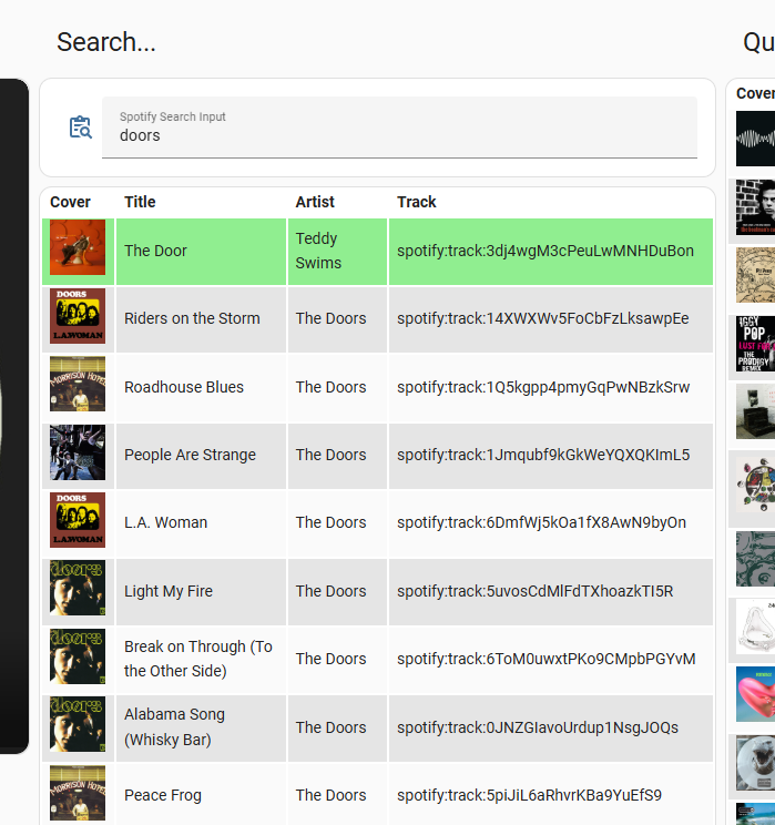

Stuck and hopefully someone can help.
I have a flex-table and wanted to have row-cells have a column that contains actions.
Read through everything but cannot get it to work (even the simple examples).
This shows the data table is fine:
The actual content for that cell should be passed to some action,
SUPPOSEDLY data-table supports this, allowing for an action.
Tried this and many other attempts, nothing is “clickable” I guess:
                  - name: Track
                    data: song_search
                    modify: x.uri
                    tap_action:
                      action: spotifyplus.add_player_queue_items
                        entity_id: media_player.spotifyplus_kevin_brown
                        uris: |
                          x.uri
Executing that code does as expected, so it just never runs or click (hold, double-click) or anything
