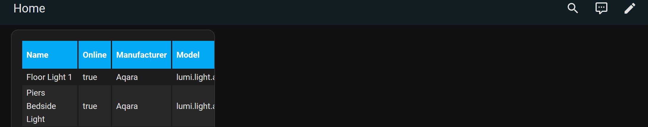

I have just set up the zha-network-card derivative of this card but I can’t work out how to display the table at the full width of the screen. At the moment, I see this:
How do I persuade the table to fill the available width of the dashboard?

The flex-table-card on which the zha-network-card was based has recently been modified so that it will expand on a Sections view to fill the selected width. If you want to experiment, take a look at the latest version.
The change was simple. At the end of class FlexTableCard I added the lines:
    getGridOptions() {
        return {
            columns: "full",
Another way is to set your view’s Layout to Panel (single card) mode. The flex-table-card must be the only card in the view, or must be the child of a container card such as a grid or vertical-stack.
Seems 0.7.9 broke the horizontal scrollbar example. It works after reverting back to 0.7.8
Version 1.0 fixes this. Horizontal scroll bars should work again, and the entire card should be constrained to its column. It should also respond to changes in column width on Section views.
Thank you for your reply. This is what I had done but it still wasn’t filling the available width. I’ll have another look when I am home again.
Thanks for the info.

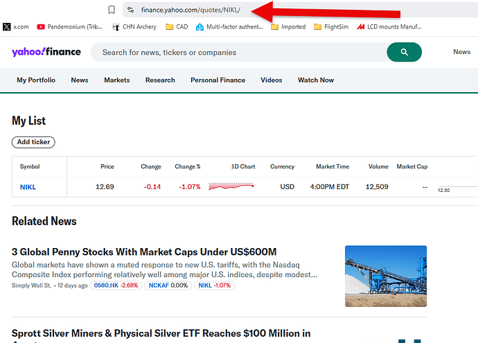

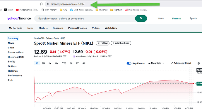

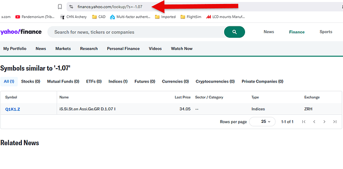

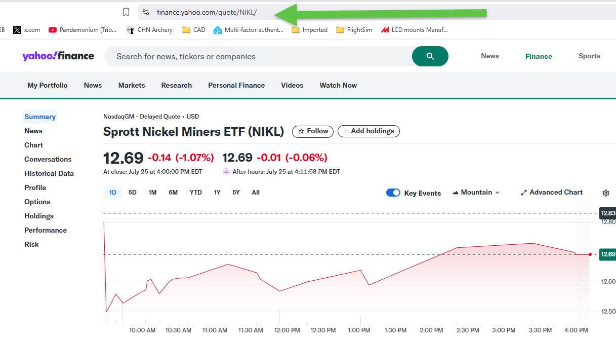

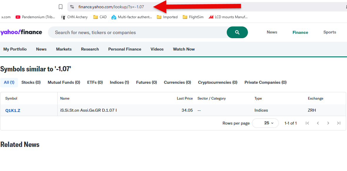

I can not get it to work. The url opens the web page (https://finance.yahoo.com/quote/NIKL/) but it does not use the ticker (NIKL). I am getting a generic page.Which has the ticker in “My List”.
If I use the ticker (NIKL) in the Yahoo search field, going direckt to the tickers page.
I am getting the same url…?
And now at a sudden, it pick up regularMarketChangePercent as col[3]
TIPS: Nicle miners is way down. This ETF is a winner in a 5 years perspective…
UPDATE: Got it working. The col points at the GUIs flex-table column.

Glad you figured it out. Also, when you use quotes, plural, in the URL, you get the My List page. When you use quote, singular, you get the stock page.

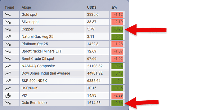

Any ide why this does not work?
type: custom:flex-table-card
entities:
  include:
    - sensor.yahoofinance*
  exclude:
    - sensor.yahoofinance_tnx
    - sensor.yahoofinance_nyicdx
columns:
  - name: Trend
    data: icon
    tap_action:
      action: url
      url_path: https://finance.yahoo.com/quote/col[1]

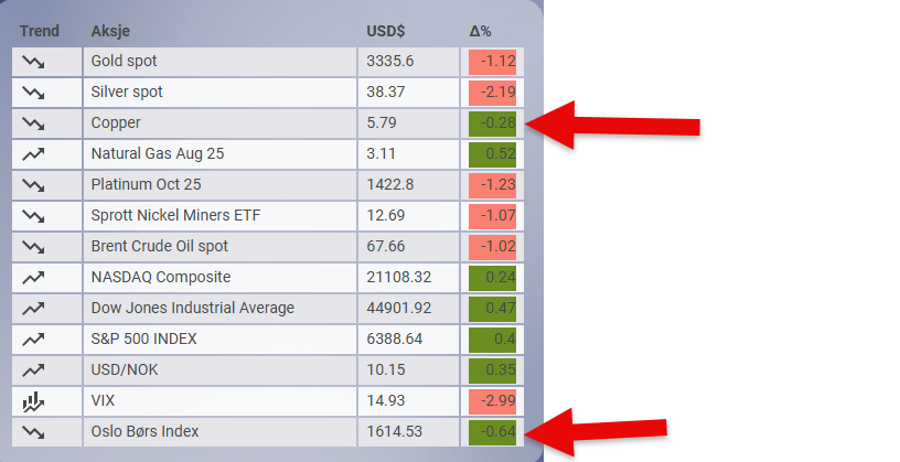

  - name: Ticker
    data: symbol
    hidden: true
  - name: Aksje
    data: friendly_name
  - name: USD$
    data: state
  - name: ∆%
    data: regularMarketChangePercent
    align: right
    modify: |-
      if (parseInt(x) >= 0 )
        '<div style="background-color: #6B8E23;">' + x + '</div>';
      else if (parseInt(x) < 0 )
        '<div style="background-color: #FA8072;">' + x + '</div>';
parsing as integer?
" The parseInt() function is used to parse a string and return an integer. When parseInt() is applied to a value that is a float (or a string representing a float), it truncates the decimal part and returns only the whole number."
Try parseFloat() ??
Of course the parseFloat(x) worked.

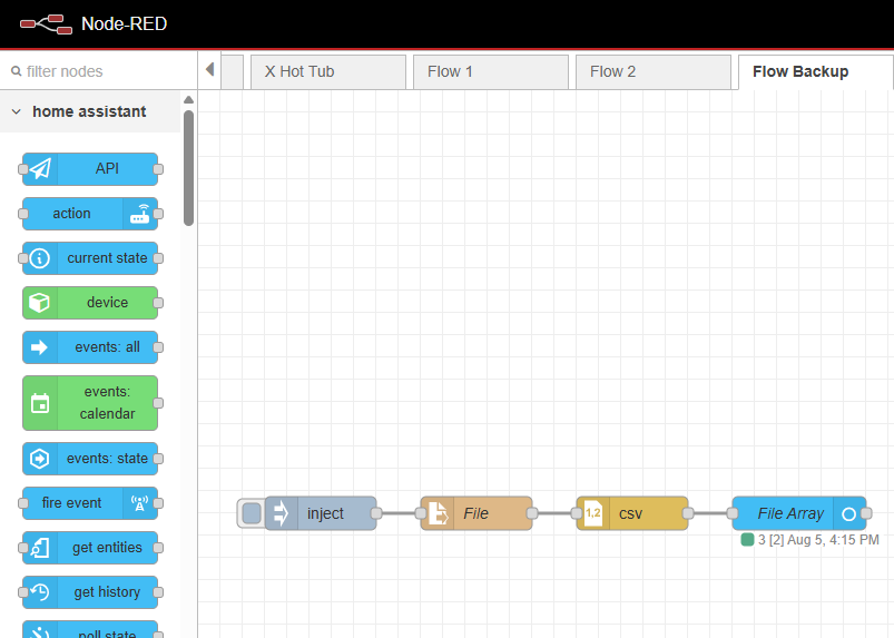

Yes it is certainly possible to populate the flex-table card from a .csv file
What is more, it takes very little to achieve this.
[{"id":"9ddf2f0773bbe17f","type":"file in","z":"6b44f4865618efa0","name":"File","filename":"/share/refill_log.csv","filenameType":"str","format":"lines","encoding":"none","allProps":false,"x":250,"y":980,"wires":[["8bed1dbb447a5b5a"]]},{"id":"b66f01cd48802b2b","type":"inject","z":"6b44f4865618efa0","name":"","props":[],"repeat":"","crontab":"","once":false,"onceDelay":0.1,"topic":"","x":110,"y":980,"wires":[["9ddf2f0773bbe17f"]]},{"id":"8bed1dbb447a5b5a","type":"csv","z":"6b44f4865618efa0","name":"","spec":"rfc","sep":",","hdrin":"","hdrout":"none","multi":"mult","ret":"\\n","temp":"tstamp,ca,cb,cc,cd","skip":"0","strings":true,"include_empty_strings":true,"include_null_values":true,"x":390,"y":980,"wires":[["8909afaf89cb1f90"]]},{"id":"8909afaf89cb1f90","type":"ha-sensor","z":"6b44f4865618efa0","name":"File Array","entityConfig":"ed5747f3ca86b4c7","version":0,"state":"$count(payload)","stateType":"jsonata","attributes":[{"property":"data_array","value":"payload","valueType":"msg"}],"inputOverride":"allow","outputProperties":[],"x":540,"y":980,"wires":[[]],"server":""},{"id":"ed5747f3ca86b4c7","type":"ha-entity-config","server":"","deviceConfig":"","name":"SC File Array","version":6,"entityType":"sensor","haConfig":[{"property":"name","value":"File Array"},{"property":"icon","value":""},{"property":"entity_picture","value":""},{"property":"entity_category","value":""},{"property":"device_class","value":""},{"property":"unit_of_measurement","value":""},{"property":"state_class","value":""}],"resend":false,"debugEnabled":false}]
Home Assistant is very powerful, but it does not handle files or arrays of data well. Yes there is a file integration, and it can read a file, but only the last line.
As has been said above, any user file should be in one of the open directories, ideally /share as that is where shared data should go. You should not be trying to work with files inside the config directory.
I have spent a day trying to use the ‘call action’ in the flex-table-card but can’t even get the examples to work, so I am back to good-old Node-RED.
Node-RED is not that popular around here, but it is a full programming language, it is easy to use (once you have it installed) and it eats data arrays for breakfast. The File node reads the file, the CSV node turns this into an array, and using the HA WebSocket nodes and the Sensor node I can put the array row count into the entity state, and the full file array into an attribute. After that, using the flex-table-card is easy.

I will admit that you have to install and setup Node-RED, and probably learn how to use it, but the payback in terms of being able to read files and APIs, process arrays, and then display just what you want is I believe worth the effort.
