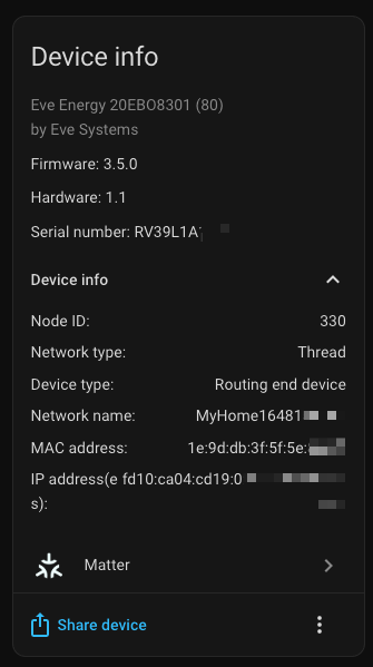

I want to build a table to diagnose the state of my Matter over Thread devices.
I envision the following structure:
  • only devices of the Matter integration are part of the table
  • every device of the Matter integration gets its own line in the table
Device name Area Brand/model Firmware Hardware Serial number Node ID Network type Device type Network name MAC address IP address(es) State State unavailable 1h State unavailable 1d State unavailable 1w State unavailable 1m
Abstellkammer Bewegung Abstellkammer Eve Motion 20EBY9901 (89) by Eve Systems 3.2.1 1.1 ZV38L1Axxxxx 11 Thread Sleepy end device MyHome16481xxxxx aa:0f:2f:1c:51:b1:xx:xx fd10:ca04:cd19:0:xxxx:xxx:xxxx:xxxx available 0 0 0 0
Büro Spot 1 Büro LED Bulb T2 (GU10, RGB CCT) (6149) by Aqara 1.0.0.0 1.0.0.0 4EF4410010xxxxx 327 Thread End device MyHome16481xxxxx 1a:0d:85:7f:e4:90:xx:xx fd10:ca04:cd19:0:xxxx:xxx:xxxx:xxxx available 0 0 0 1
Büro Radar Büro LWR01 (40961) by GL Technologies 1.0.0 1.0.0 d8505a4bf5fxxxxx 358 Thread Sleepy end device MyHome16481xxxxx 7a:27:48:8b:76:d2:xx:xx fd10:ca04:cd19:0:xxxx:xxx:xxxx:xxxx available 0 0 0 2
Wohnbereich Aquarium Wohnbereich Eve Energy 20EBO8301 (80) by Eve Systems 3.5.0 1.1 RV39L1Axxxxx 330 Thread Routing end device MyHome16481xxxxx 1e:9d:db:3f:5f:5e:xx:xx fd10:ca04:cd19:0:xxxx:xxx:xxxx:xxxx unavailable 1 4 17 36
The data is almost there, but not in this compressed form.
Most information can be found in the device info:
The real magic happens in the last 5 columns:

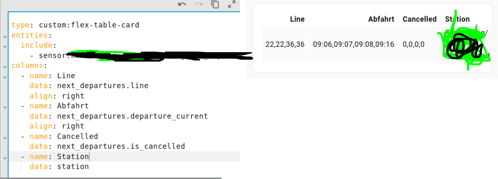

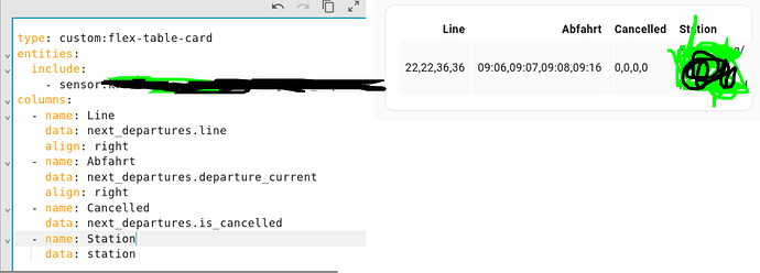

Sorry, if I missed it in the docs: How can I add the friendly_name to each row when I have a list of attributes that I want to get expanded?
Use case is from db-infoscreen, I have two sensors holding depature times as attributes, but the station is stored in the entity
What I want, is that each departure is a row, with each holding the station too
db-infoscreen data

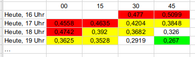

As I am not a programmer I am struggling to understand, if it is at all achievable what I want to do.
I use flex table card to have all upcoming energy prices to see at a glance, when it is the best time to charge the car, the home battery, etc.:
I was rather happy with this table when the price changed only every hour: The maximum no. of rows was 36 … since having quarterly energy prices the number of rows quadrupled and the table become unhandy.
I want to change the layout into something more heat-map like to reduce the number of rows:
… but all my attempts did not even bring me close to this :frowning:
The data is coming from a sensor with following attributes - not quite sure, if this is what the professionals call an “array”:
The code for the card looks currently straight forward:
type: custom:flex-table-card
title: Tibber - Strompreise
entities:
  include: sensor.electricity_price
sort:
  - future
columns:
  - name: Sorting columns
    data: future
    modify: x.startsAt
    hidden: true
  - name: Ab
    data: future
    modify: |
        var colors = [
            { level: "VERY_EXPENSIVE",  color: "red" },
            { level: "EXPENSIVE",       color: "goldenrod" },
            { level: "NORMAL",          color: "" },
            { level: "CHEAP",           color: "lightgreen" },
            { level: "VERY_CHEAP",      color: "limegreen" } ]
        var startsAt = new Date(x.startsAt)
        var d = new Date()
        var sday = ""
        if (startsAt.getDay() == d.getDay())
          sday = "Heute"
        else
          sday = "Morgen";
        '<div style="color: black; background-color: ' + colors.find(c => c.level === x.level).color + '">'
          + sday + ", " + startsAt.getHours().toLocaleString('de-DE', {minimumIntegerDigits: 2}) + ":" + startsAt.getMinutes().toLocaleString('de-DE', {minimumIntegerDigits: 2}) + " Uhr" +
        '</div>'
  - name: Arbeitspreis
    data: future
    modify: |
        var colors = [
            + x.total.toFixed(4)
  - name: Strompreis
    data: future
    modify: |
        var colors = [
            + x.energy.toFixed(4)
    align: right
Can I achieve this with the flex table card and - if yes - can someone point me into the right direction? Thanks!
