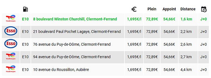

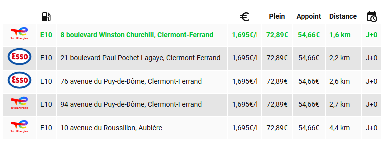

I use Flex-table-card to filter (I’m interested in certain types of fuel only), sort (the cheaper the better) and display the data.
It looks like this:
The column “Plein” shows the price multiplied by the tank capacity. I do that with a modify: Intl.NumberFormat('fr',{minimumFractionDigits:2,maximumFractionDigits:2}).format(parseFloat(x)*43), with 43 being the tank capacity in liters.
So far, so good.
Now, my issue is with the “Appoint” column: it should show the cost of a top-up from the current amount of fuel in the car to a full tank. The current level of fuel in the tank is stored by an entity created by another integration. Ildar_Gabdullin told me I couldn’t do math with another state and I had to create a template sensor with the current fuel level as an attribute, which I did. Of course, it’s not an attribute of the fuel price entity, it can’t be since data are generated independently by two integrations.
So my question is “How can do math based on another sensor?” Id est, how can I replace the hard-coded “43” by data from another entity?

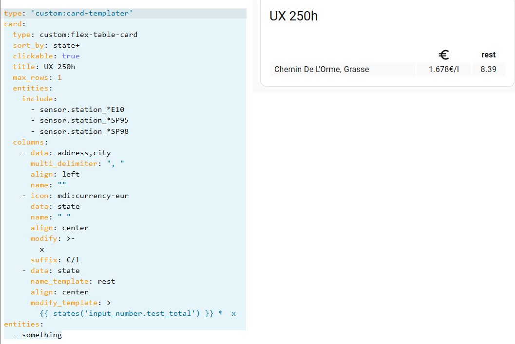

For as far as I can tell, this could do it, the helper has value ‘5’ right now
type: 'custom:card-templater'
card:
  type: custom:flex-table-card
  sort_by: state+
  clickable: true
  title: UX 250h
  max_rows: 1
  entities:
    include:
      - sensor.station_*E10
      - sensor.station_*SP95
      - sensor.station_*SP98
  columns:
    - data: address,city
      multi_delimiter: ", "
      align: left
    - icon: mdi:currency-eur
      data: state
      align: center
      modify: >-
        x
      suffix: €/l
    - data: state
      name_template: rest
      align: center
      modify_template: >
        {{ states('input_number.test_total') }} *  x
entities:
  - something

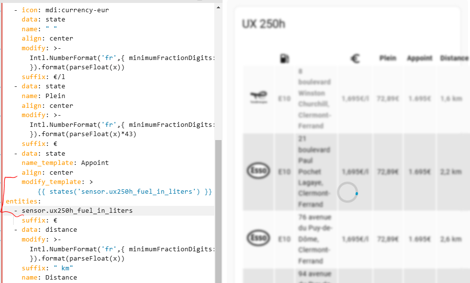

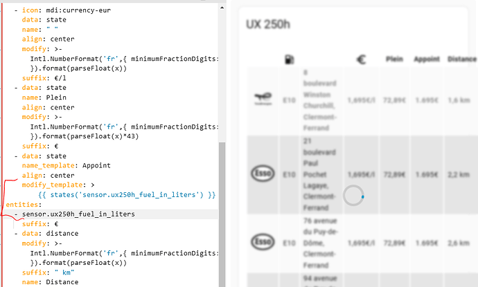

I probably misunderstood your code, it doesn’t work:
You have a second entities option at the same indentation with - something? That something is the entity that gives the fuel level?
We’re working with state and not attribute?
name vs name_template?
modify vs modify_template?
Sorry for being so helpless :-/
Just copy/paste the code and replace the input_helper… with yours, that should work, then you can take it stepwise further. You can even leave ‘something’ as is (read the card-templater docs if you want to extend its usage)
