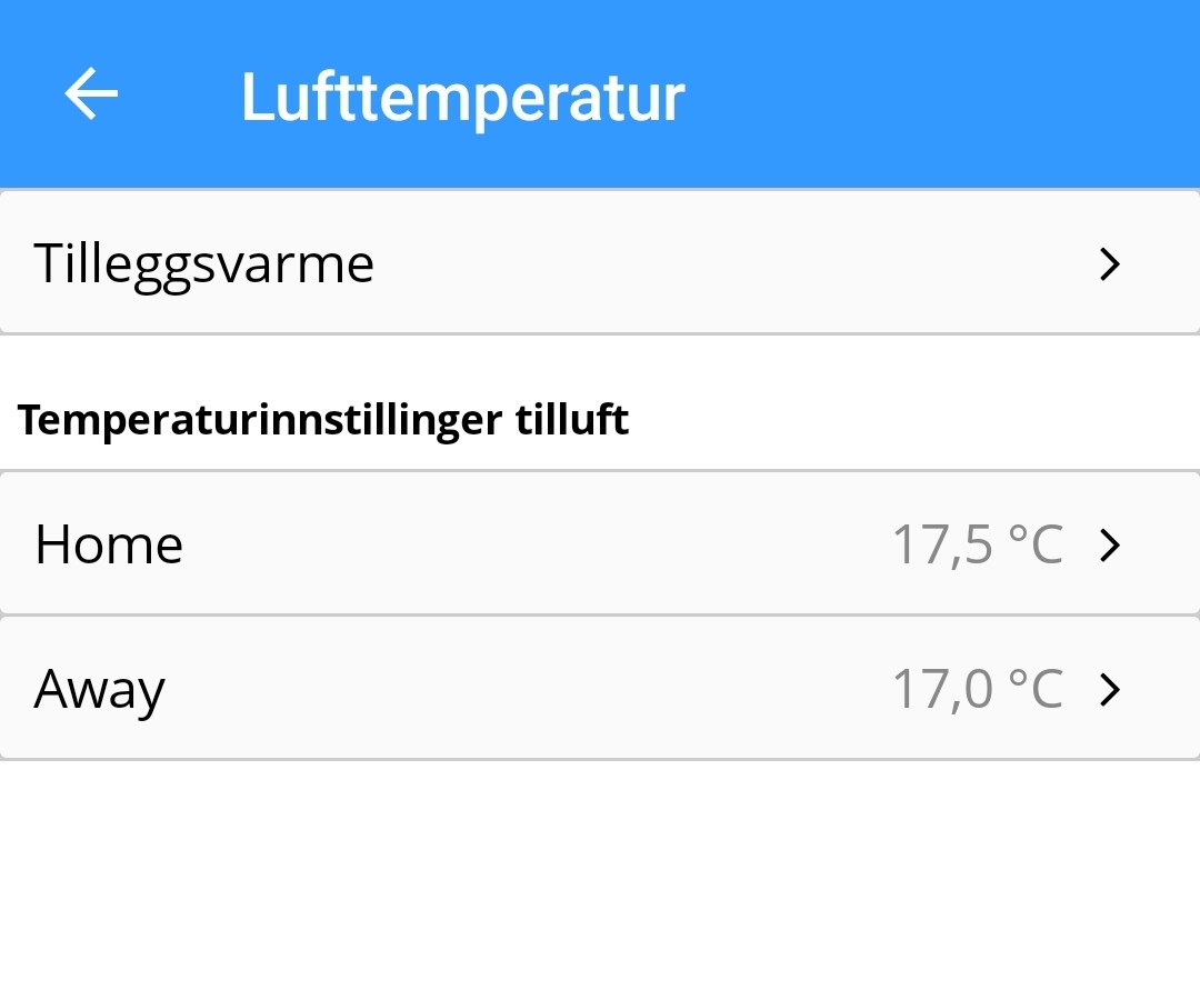

Can you expose the two individual temperature settings for home and away presets? Now it seems you are only setting it to whatever preset is active, and this can be confusing, especially with a large temperature difference between the two presets. When setting up smart solutions in HA, it is quite cumbersome to have to switch preset first, before setting a desired setpoint. The set point can typically be changed daily (day/night temp), or when it is particularly hot or cold outside the away temp could be different from the home temp.
Adding a screenshot from my app that shows these two different settings.
