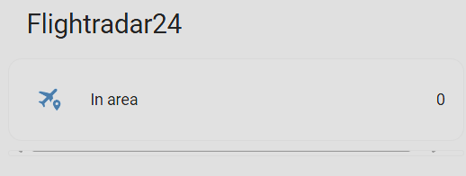

I have a vertical stack card on my dashboard that may show you what you want, automagically, from the FlightAware24 add-on. I hear the plane, look up and then glance at the dashboard.

When I use that code, the map graphic appears to be one pixel high -
When I paste the URL that is in the code (with my lat/lon), it opens flightradar map fine.
Wait till a plane comes overhead…
That code should give you enough hints to achieve your goals
Figured it out - there is a spurious ’ at the end of your code snippet.
