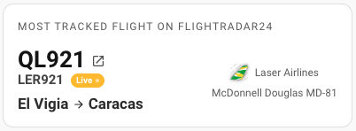

✈️ Flightradar24 Flight Card
:tada: Flightradar24 Flight Card :tada:
hacs_badge GitHub Release

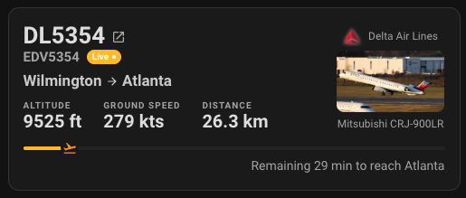

A custom Home Assistant card for displaying FlightRadar24 flight information.
This card requires the Flightradar24 integration to be installed and configured in Home Assistant.

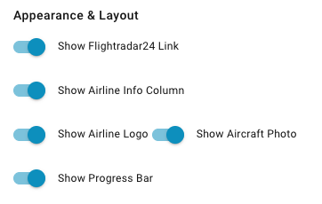

Now supports more control on layout, letting you to control which parts you want to show/hide.

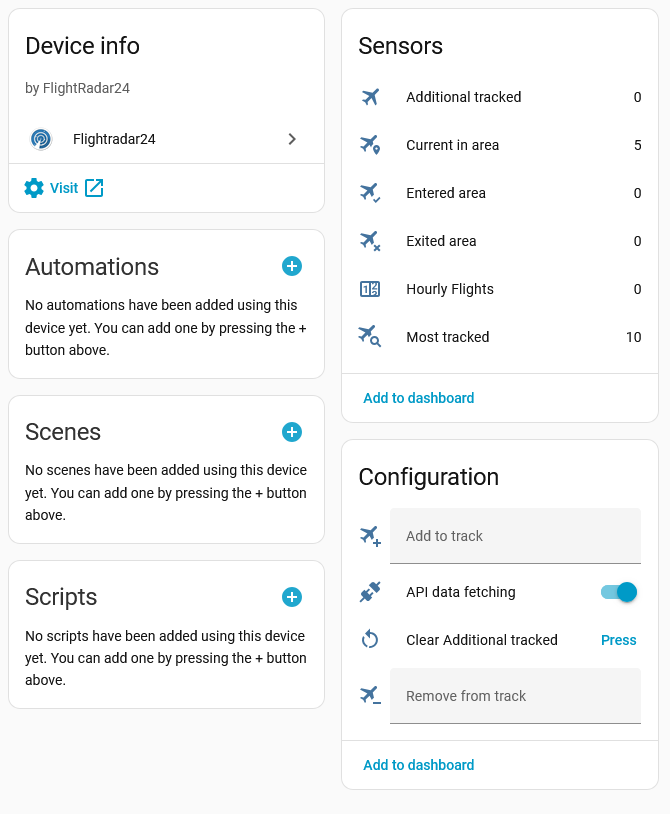

While the flightradar24 integration records multiple aircraft within my area of interest this card records no aircraft. I have installed and reinstalled following the instructions and consequently running out of ideas on what the issue is. Can someone please assist. Thanks.
First, and most important make sure the Flightradar24 custom integration is returning correct values. If it’s not, it’s integration fault and not the card. The card only reads data from entities created by the integration.

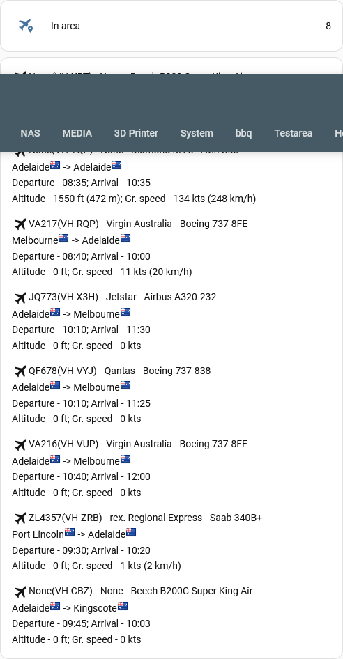

Thanks for your followup. I have been using Flightradar24 for a couple of years and never had a problem with entities coming though the integration. The code below is your card and returns no results. The following code is what I have been using and this returns a result. You will see from the screenshot that there are multiple aircraft within my area of interest.

      type: markdown
      content: >-
        {% set data = state_attr('sensor.flightradar24_current_in_area',
        'flights') %} {% for flight in data %}
          <ha-icon icon="mdi:airplane"></ha-icon>{{ flight.flight_number }}({{ flight.aircraft_registration }}) - {{ flight.airline_short }} - {{ flight.aircraft_model }}
          {{ flight.airport_origin_city }}{%if flight.airport_origin_city %}<img src="https://flagsapi.com/{{ flight.airport_origin_country_code }}/shiny/16.png" title='{{ flight.airport_origin_country_name }}'/>{% endif %} -> {{ flight.airport_destination_city }}{%
          if flight.airport_destination_country_code %}<img src="https://flagsapi.com/{{ flight.airport_destination_country_code }}/shiny/16.png" title='{{ flight.airport_destination_country_name }}'/>{% endif %}
          {%if flight.time_scheduled_departure %}Departure - {{ flight.time_scheduled_departure | timestamp_custom('%H:%M') }}; {% endif %}{%if flight.time_scheduled_arrival%}Arrival - {{ flight.time_scheduled_arrival | timestamp_custom('%H:%M') }}{% endif %}
          Altitude - {{ flight.altitude }} ft{%if flight.altitude > 0 %} ({{(flight.altitude * 0.3048)| round(0)}} m){% endif%}; Gr. speed - {{ flight.ground_speed }} kts{%if flight.ground_speed > 0 %} ({{(flight.ground_speed * 1.852)| round(0)}} km/h){% endif%}
          {% endfor %}

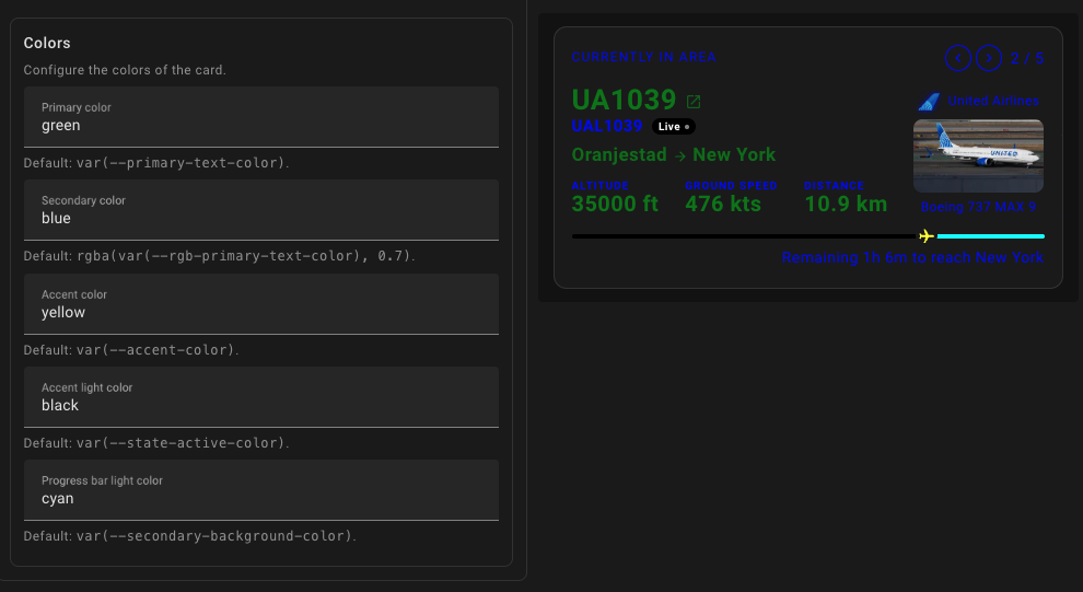

New version v1.7.0 available :tada:
This release brings two important features:
  • Determine if airplane is ascending or descending
  • Control color tokens via config
:point_up_2: Notice the airplane icon

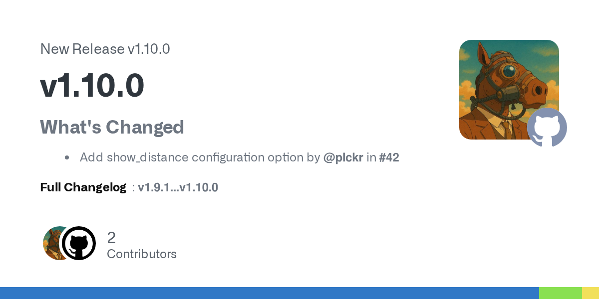

New version v1.10.0 available :tada:
With this new feature release, it introduced a new option to change visibility for distance. It will be possible to disable, or display current distance or closest distance (default).
