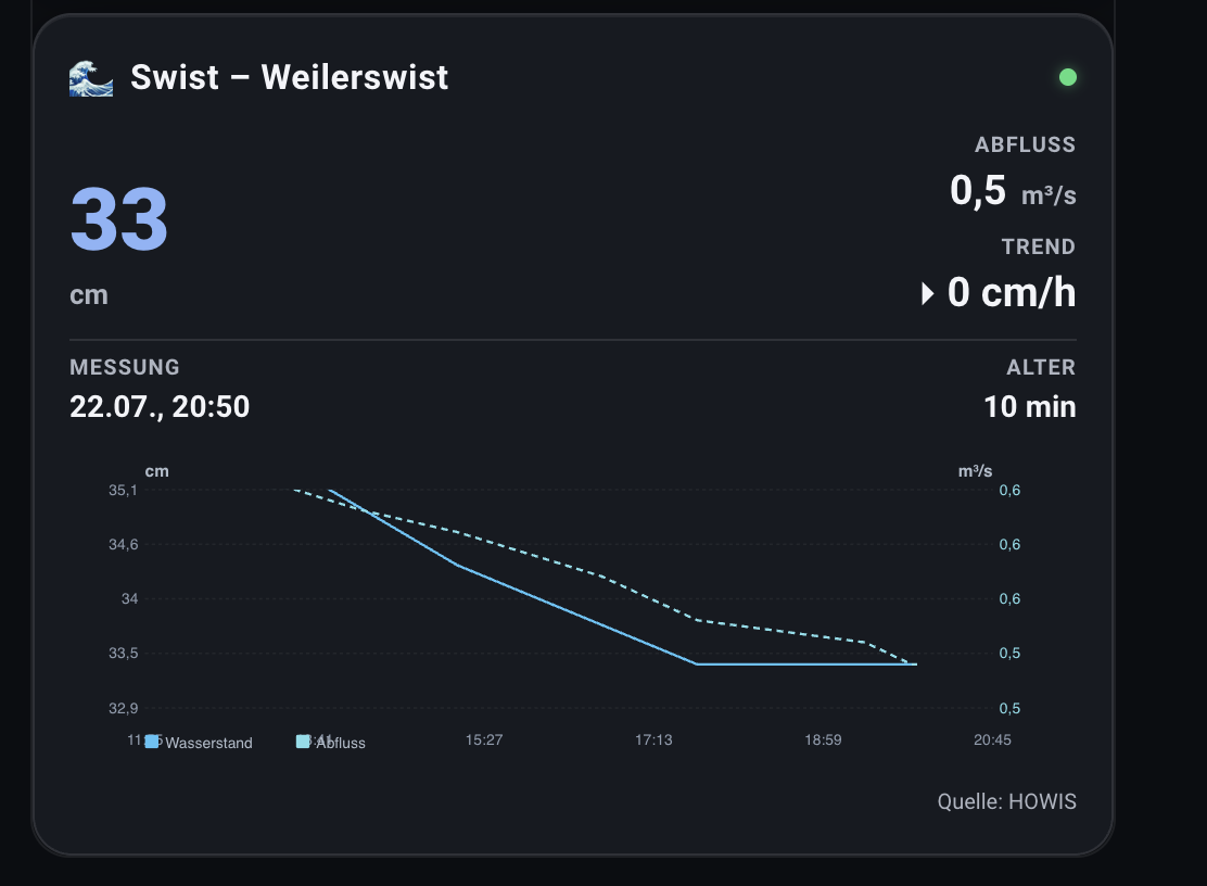

Lovelace Card
This integration ships a responsive Lovelace card (custom:erftverband-riverlevel-card) with an embedded background image and HACS brand icon.
Card Installation
  1. Install/update the integration via HACS
  2. Restart Home Assistant
  3. Add the resource once:
  • Settings → Dashboards → Resources → Add Resource
  • URL: /api/erftverband_riverlevel/static/erftverband-riverlevel-card.js?v=0.2.0
  • Type: JavaScript Module
  1. Fully reload the browser
Add the Card
type: custom:erftverband-riverlevel-card
With station filter and all options:
type: custom:erftverband-riverlevel-card stations: - essig - morenhoven hours_to_show: 24 show_history: true show_discharge: true show_source_status: true sort_by: waterbody
Configuration Options
Option Default Description
stations (all) Filter to specific station IDs (omit for all)
hours_to_show 24 History chart time range (1–168 hours)
show_history true Show SVG history chart per station
show_discharge true Show discharge values and chart line
show_source_status true Show HOWIS reachability indicator
sort_by name Station sort order (name, water_level, flood_status, waterbody, data_age)
Features
  • No dependencies: Auto-Entities, Button-Card, ApexCharts, Decluttering-Card not required
  • Automatic station detection: All configured stations appear automatically
  • Responsive: CSS Grid adapts from multi-column (desktop) to single-column (mobile) – works in sections, tablets, and smartphones
  • Sections support: Uses full section width with getGridOptions()
  • State indicators: Water level, discharge, trend, data age, flood status badge
  • Stale & alarm warnings: Yellow “Daten veraltet” or red “HOCHWASSERALARM” badges
  • Source status: Green/red dot for HOWIS reachability
  • History chart: Native SVG chart – no ApexCharts needed
  • More-info: Click values to open the Home Assistant detail dialog
  • Source link: Opens HOWIS detail page in new tab
  • Visual editor: Optional via the card picker UI
  • Background image: Embedded water/landscape background
  • HACS/Home Assistant brand icon: Included in the integration
  • Title format: Waterbody – Station name
