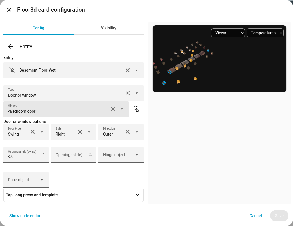

New card editor, built on Home Assistant’s own components (like the built-in cards):
  • settings in sections, toggles, entity pickers, drag and drop lists
  • warnings for entities that don’t exist and objects that aren’t in the model
  • pick objects by tapping them in the preview, and objects of the item being edited highlighted
  • “Use the current view” to create a zoom area from where you moved the camera
  • much shorter YAML

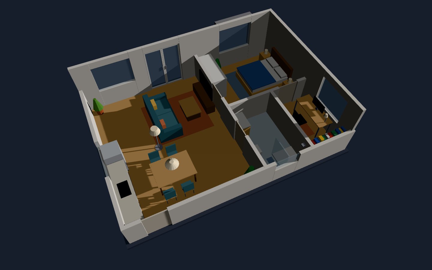

  • :sun: Sunlight from sun.sun, with shadows that follow the time of day

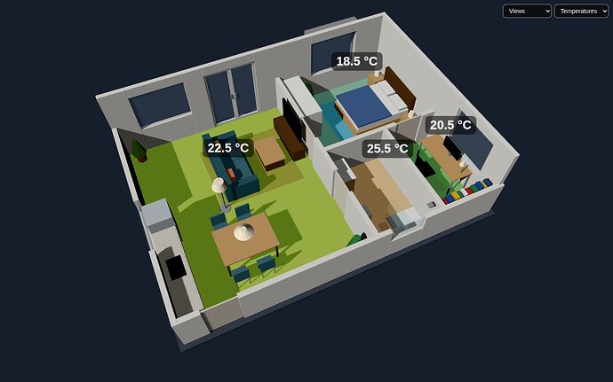

  • :artist_palette: State colours for doors and rooms, room maps by temperature or presence

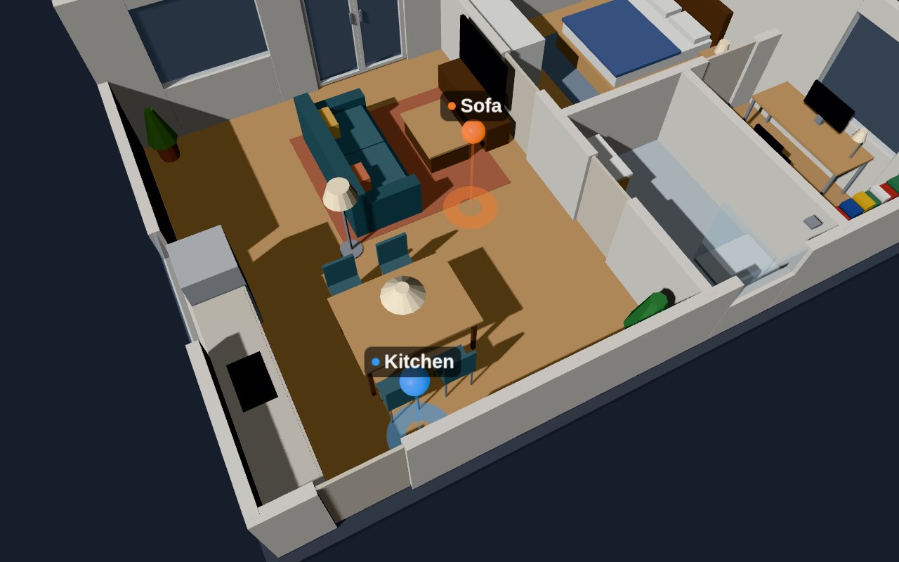

  • :person_standing: Person trackers for presence radars that report coordinates (e.g. HLK-LD2450)

Sunlight in the morning …and in the afternoon
Room map by temperature Person trackers (LD2450)

You made my day.
The other forks have nice and cool features, but all is useless if the correct syntax how to use all this goodies is weakly ocumented.
A real working configuration GUI makes everything so much easier.
For me usabillity clearly wins against features.
