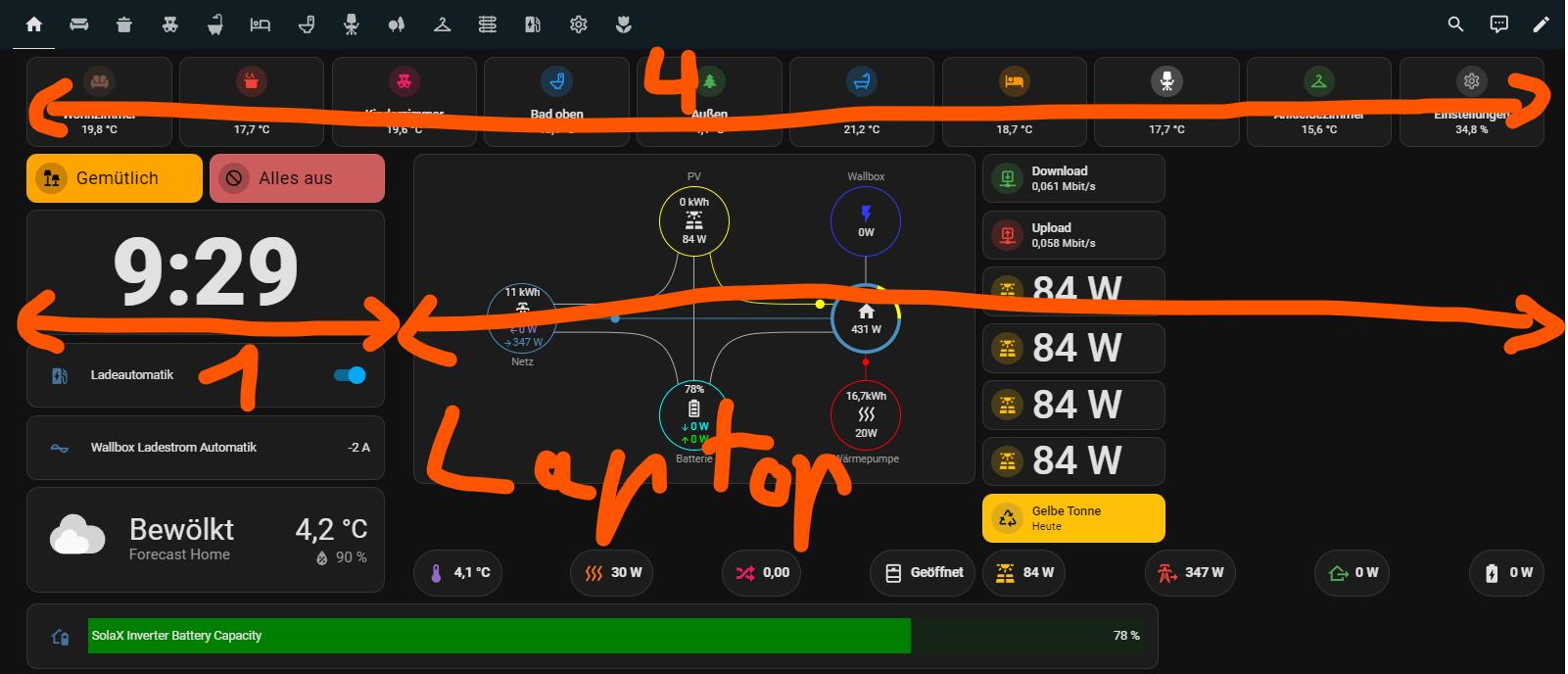

I have two other issues:
  1. Why is this space? (red color)
  2. Another problem I can not understand and solve:
    The upper part (purple) is 4 sections wide, it adjusts nicely on my laptop (browser) AND tablet (fully kiosk browser).
But the lower parts (orange) are 1 section plus 2 sections. When the right part becomes 3 sections wide, it will not fit onto the screen of the tablet (doesn’t matter if Surface Pro 9 with Windows or my 12,4" Tab 7 FE that displays the dashboard).
Even while the upper is 4 and the lower together also should be 4.
This is 1+3 on my laptop:
This is on my tablet (with a 2560x1600 screen)
BTW: The value of 31W is just for testing and will be replaced :wink:

It does if I change the line height - didn’t see that in the first place.
The line- height was separated into it’s own field in early 2024. Your inquiry isn’t the first and wont be the last :smiley:
On my Laptop I’m using Opera - which is Chrome-based, same on my Surface Pro 9.
I’m using sections.
The aspect ratio on my Laptop is (depending how I size the browser) 4:3
The Surface has 3:2 - does not work
The Tablet has fully-kiosk browser, which is in 16:10, does also not work.
The weird thing is - it works with the device with the narrowest picture - 4:3, but not on the much wider 16:10 - despite it is affecting the width of the items.
